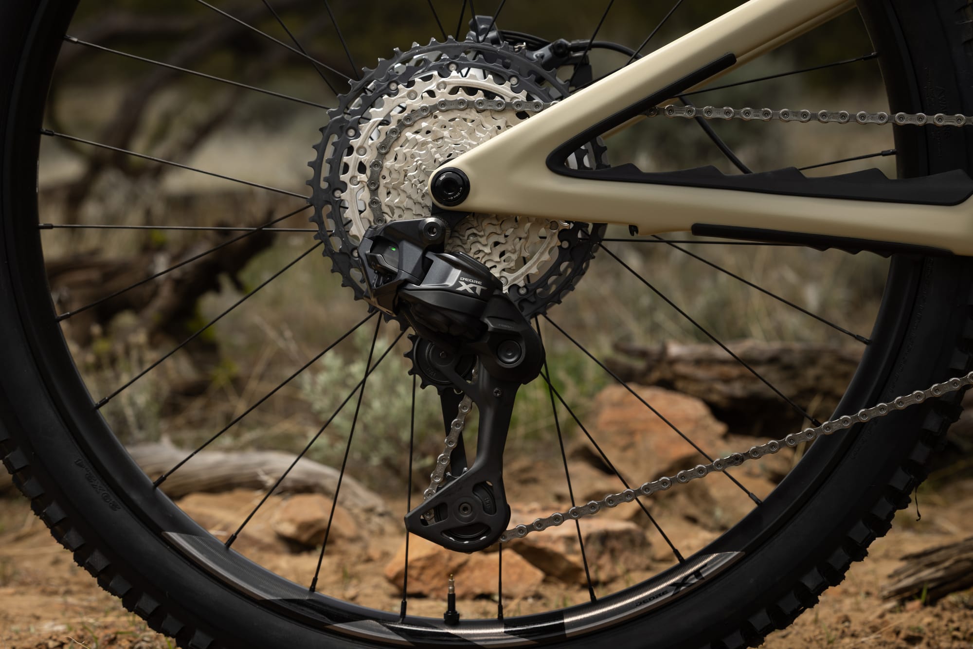

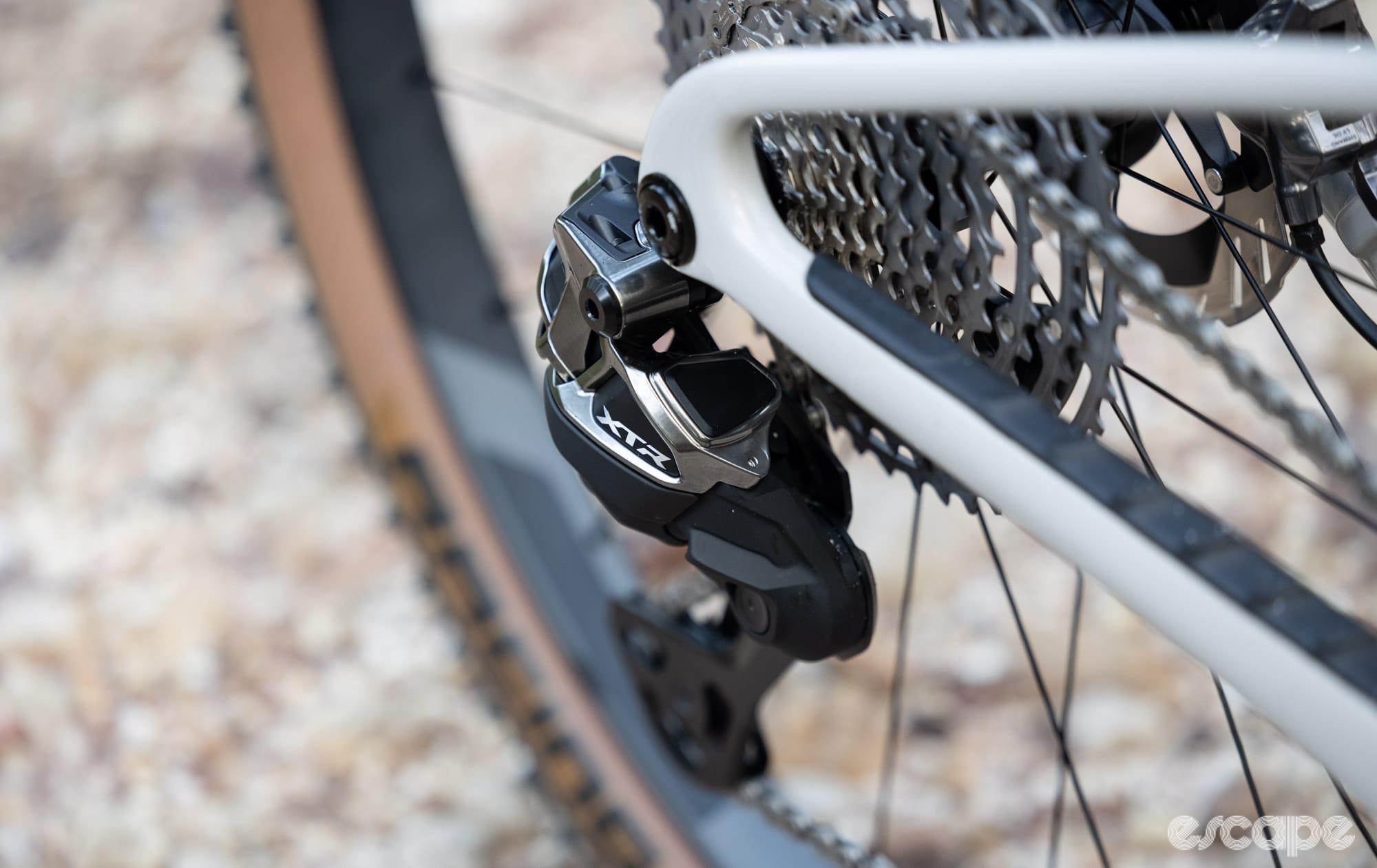

On the drivetrain side, you now have the choice of the new 9-45T cassette with aluminium alloy for the two biggest sprockets and steel for the rest. That smaller cassette can be combined with the shorter-cage GS derailleur, which, like with XTR, brings reduced weight, increased ground clearance, and better chain retention. If the nine-tooth sprocket isn’t to your liking, the classic 10-51T remains; you’ll just need to match it with the long-cage derailleur. The chain carries over from M8100 (shared with Ultegra).

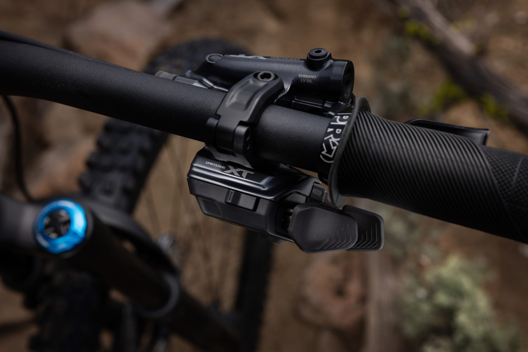

The shifter matches the functionality of XTR with independent paddle adjustment to allow you to dial in the system's ergonomics to your preference.
On paper, the shifter looks to be the same as XTR in the areas that matter; both share the same weight and have the same adjustability and functionality. Without having both shifters side by side to compare, it is hard to point to where the differences lie.
The same can be said for the rear derailleur. Based on the details released by Shimano, XTR and XT share the same technologies when it comes to chain retention, impact recovery, and Shimano Shadow ES design that is claimed to lessen the impact of rock strikes. The real difference comes from the weight of the two products: 63 grams separates the two tiers.
Shimano's use of Shadow ES is said to help shrug off rock strikes, with the derailleur forming more of a wedge shape than previous generations.

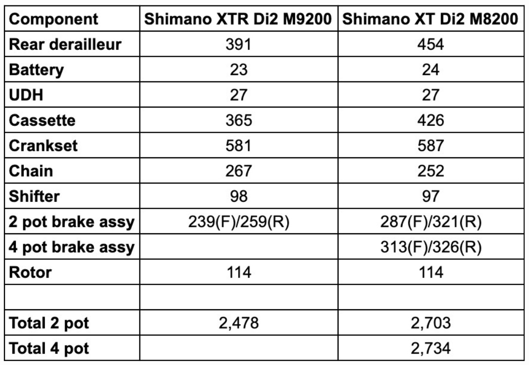

The weight for the 4-piston XTR brake was not disclosed by Shimano, although based on XT, we can assume there is around a 25-30 gram penalty over the 2-piston XC brakes.
Some differences in the weights are likely due to the fact that the XTR weights are the actual weighed values, from Dave’s review, whilst the XT weights are the claimed values from Shimano. In reality, the battery is the same as the shifter weight.

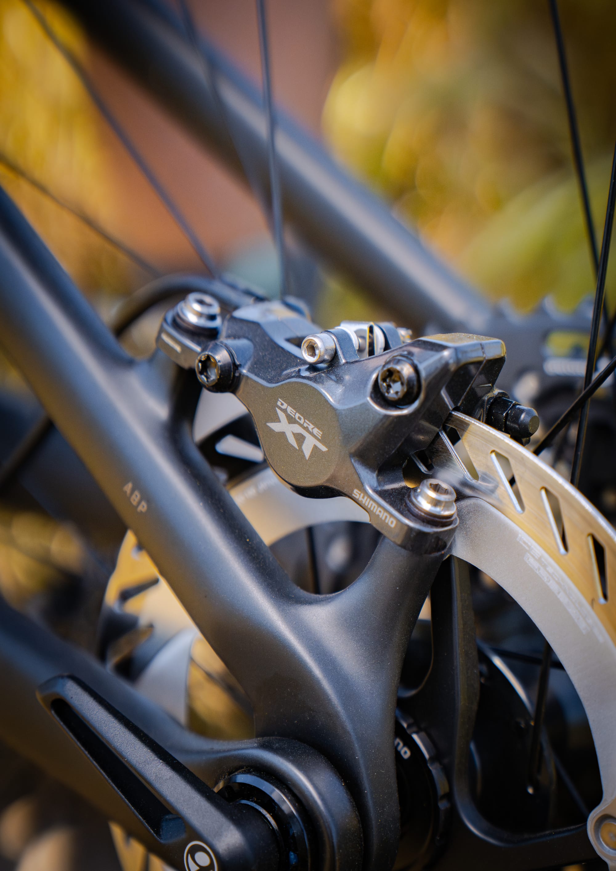

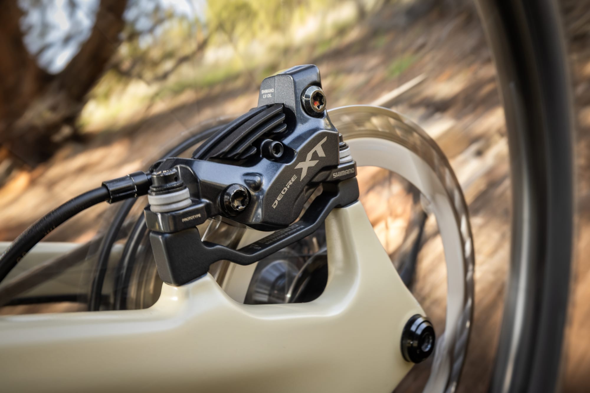

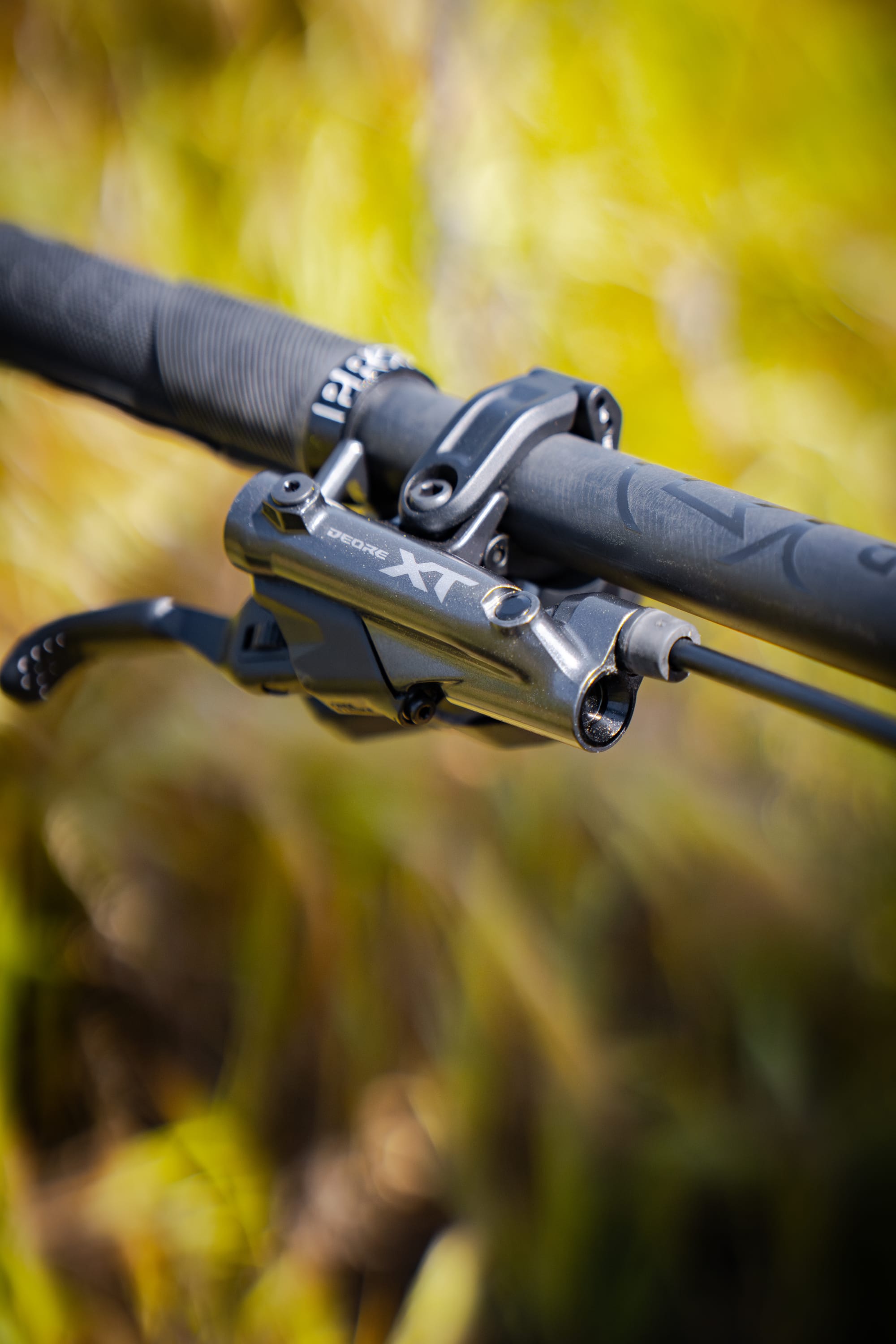

When it comes to the brakes, XT 8200 gets the same overhaul to the levers as XTR M9220 Trail, including a rethink on the ergonomics. While the levers remain the same, the brakes are available with a choice of XC-oriented two-piston or four-piston trail calipers, both running Shimano’s new low-viscosity mineral oil that is said to offer better performance across a wide range of temperatures.

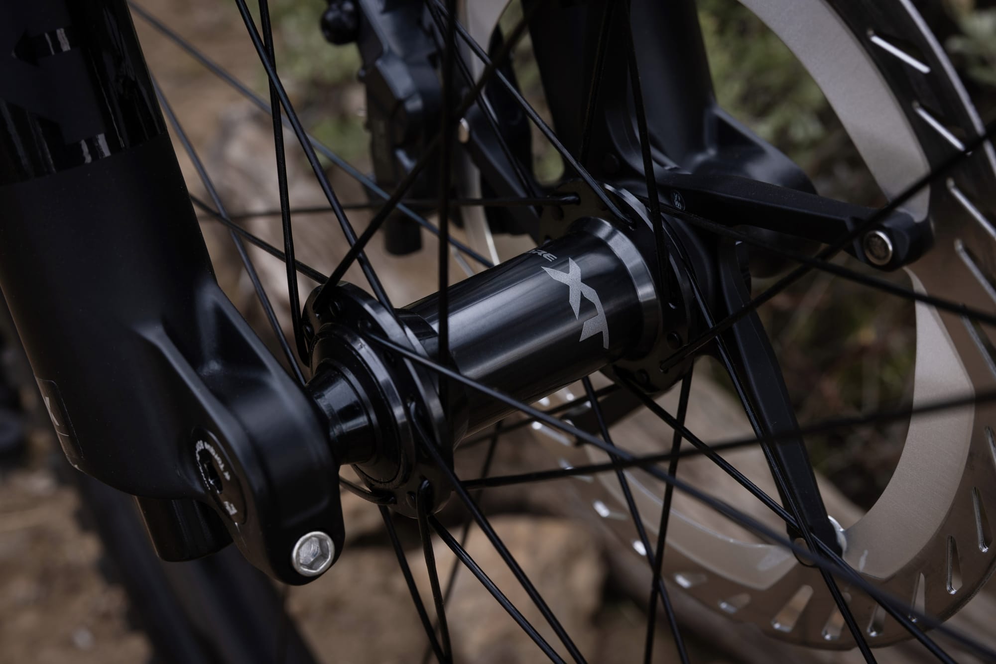

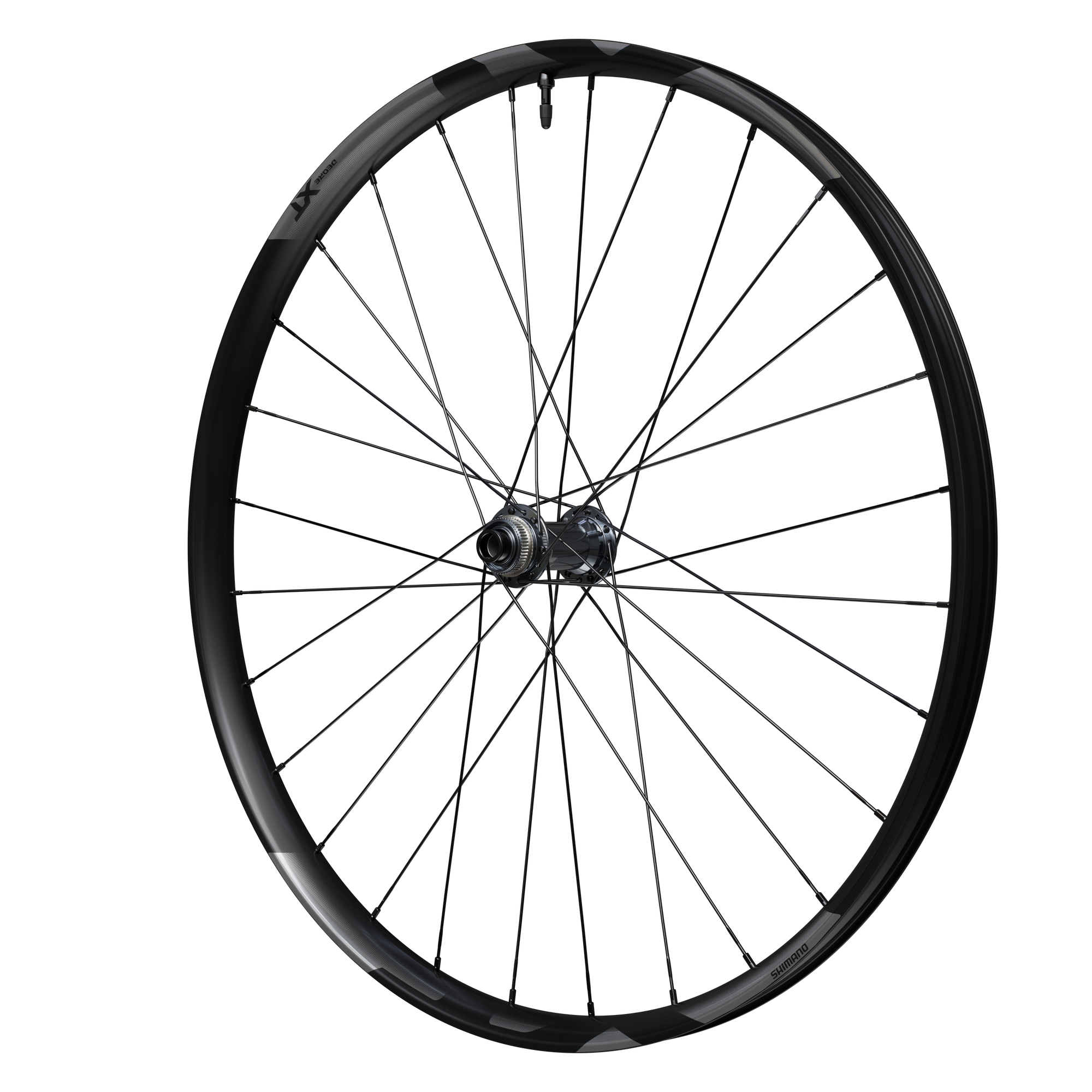

In addition the groupset, there's a new XT Trail wheelset with an alloy rim. Shimano has kept both 29 and 27.5 wheel sizes alive at this price point. This makes XT the highest you can go in Shimano’s wheel range if you want to use 27.5-inch wheels. Much like XTR, the hubs depart from cup and cone bearings in favour of sealed cartridge bearings. Unlike XTR, there aren't different options for XC or trail riding, with one single 28-hole, 30 mm internal-width rim design available.

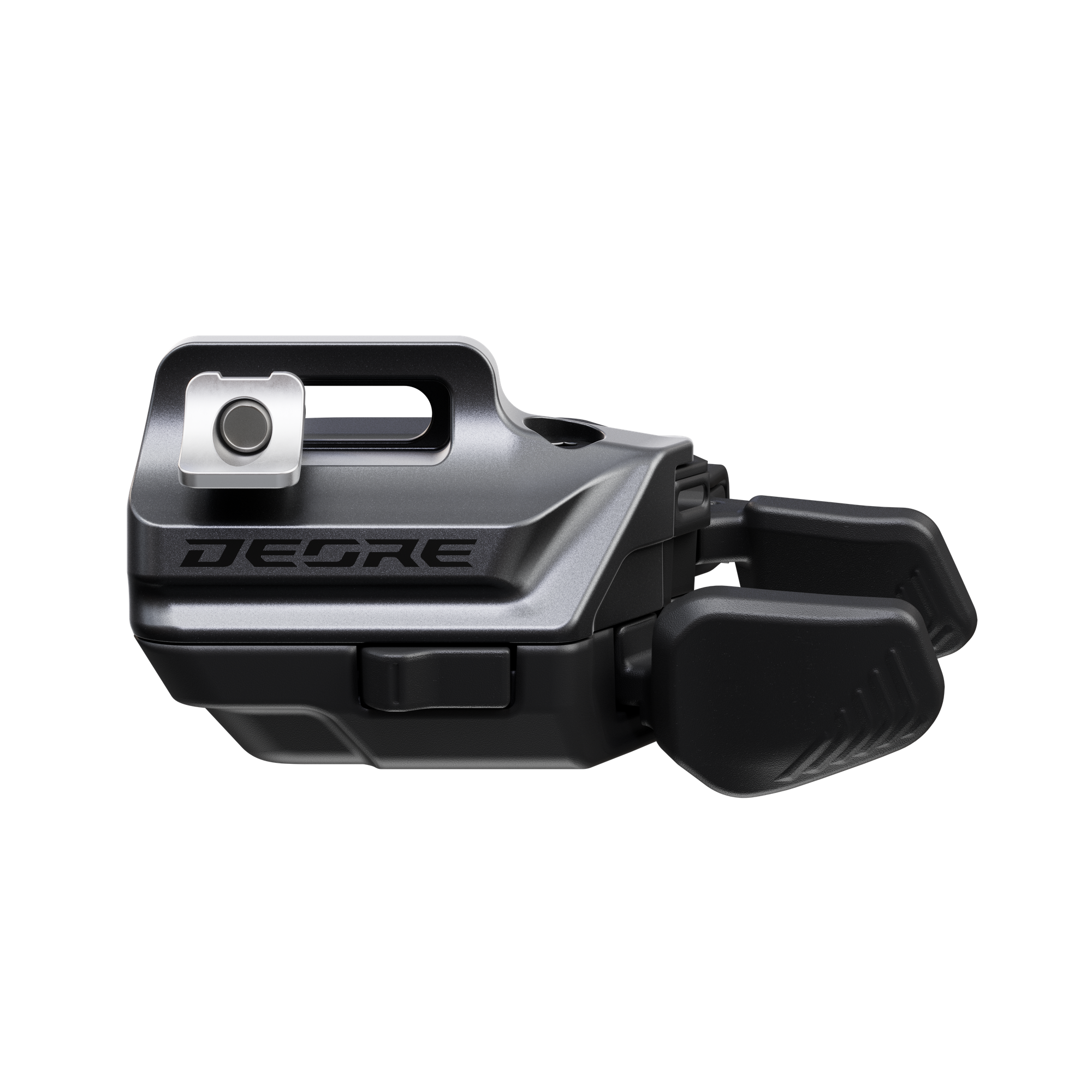

Of the three groupsets, Deore might be the most exciting, not because it’s fancy, but because it’s cheap. Well, cheaper. For a lot of riders, wireless shifting at a low price is worth the weight penalty over the more premium groups; however, with Deore it also comes with the loss of some ergonomic functionality.
Unlike XTR and XT, this isn’t a full-system overhaul. Instead, Deore Di2 is more of a bolt-on upgrade for folks already running 12-speed mechanical Deore or SLX. You get a wireless shifter and derailleur, but the rest of the groupset remains untouched, with no new brakes, cassettes, or new-style cranks.

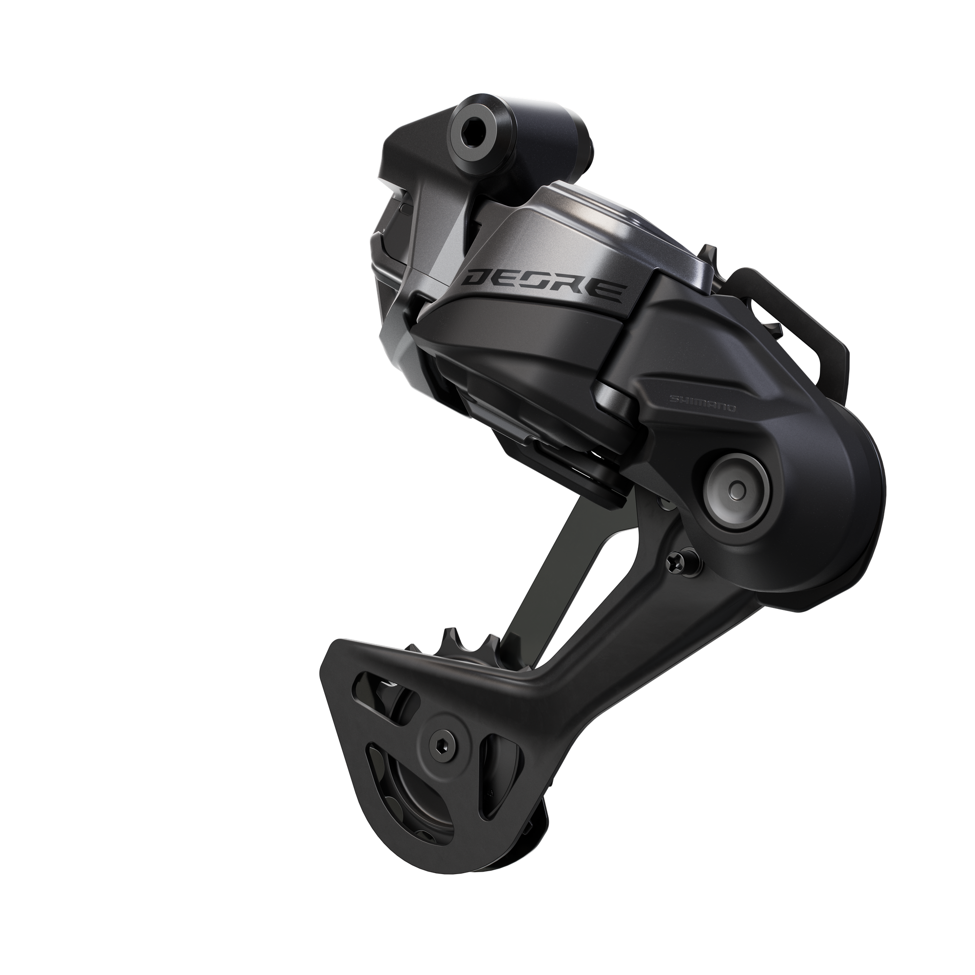

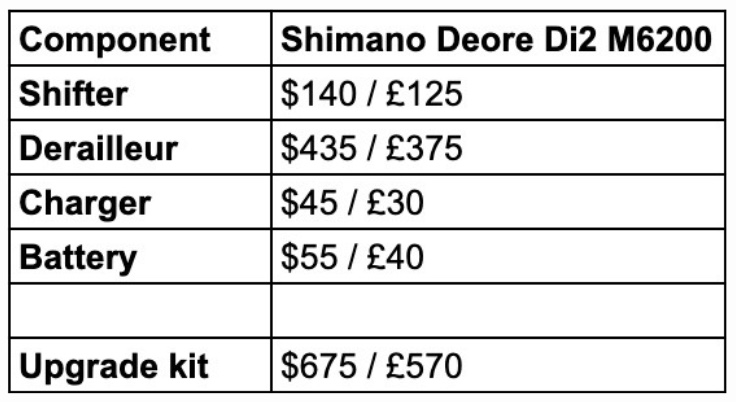

Shimano saved pennies where it could: the derailleur cage is steel, the pulleys roll on basic bushings, and the shifter loses the multi-shift functionality (changing multiple gears in a single sustained press of a button). The other feature that is missing from the Deore shifter is the adjustability, with limited two-way ergonomic adjustments available only through the EV mounting system, while the snazzy, independently adjustable shift paddles (as in XTR and XT) are not provided. It is worth noting that if the ergonomic adjustment is something you desperately need, you could always go up one rung to XT just for the shifter. This individual upgrade would add US$50 / £35 over the Deore-spec option.
Considering that there is almost a US$200 saving from the XT to Deore upgrade kits, Deore looks to be the most attractive option for all but the weight weenies or those that want a complete matching groupset.

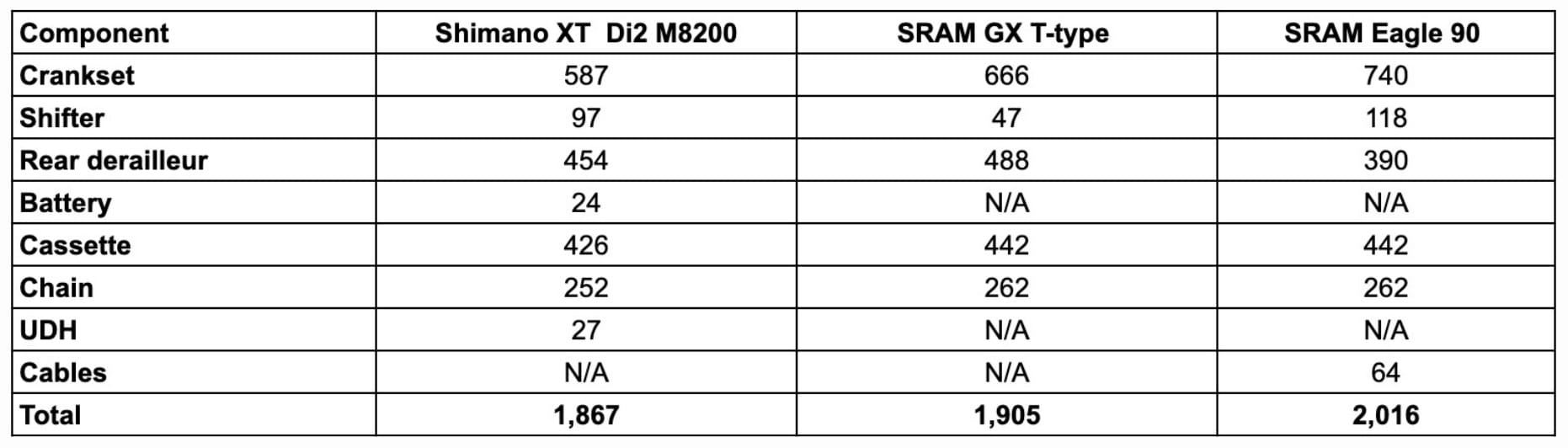

If you’re starting from scratch, Shimano’s pricing has bite. XT Di2 undercuts SRAM’s GX Transmission (US$1,380 / £1,075 / AU$2,054 versus US$1,900 / £1,715 / AU$2,748), for all groupsets exclusive of brakes. While Deore Di2’s upgrade kit is roughly in line with SRAM’s GX T-Type (£570 vs £550). That said, older GX and X01 AXS groupsets are now floating around at heavily discounted prices: think £800 for GX, and £1,400 for X01, which muddies the waters further.
Weight comparison per component; figures are in grams.
