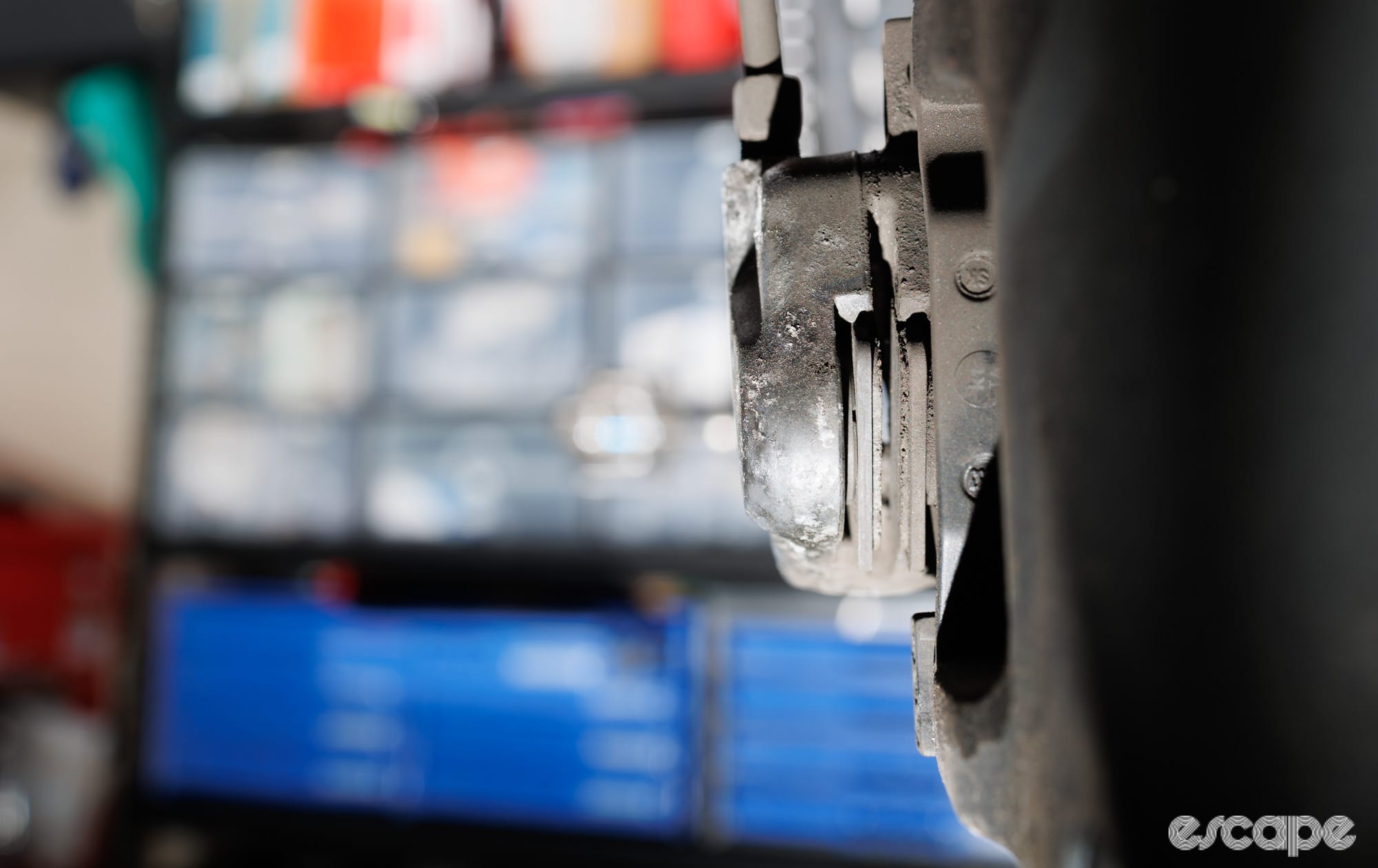

It’s a simple and well-proven design. Still, such simplicity relies on the pistons providing a smooth and clean surface. With use, dust from wearing brake pads and grit from the environment can lead to issues such as reduced brake feel, poor braking performance, pistons that are stubborn to retract (aka, rubbing pads), degraded fluid, leaks, or in severe cases, total brake failure.

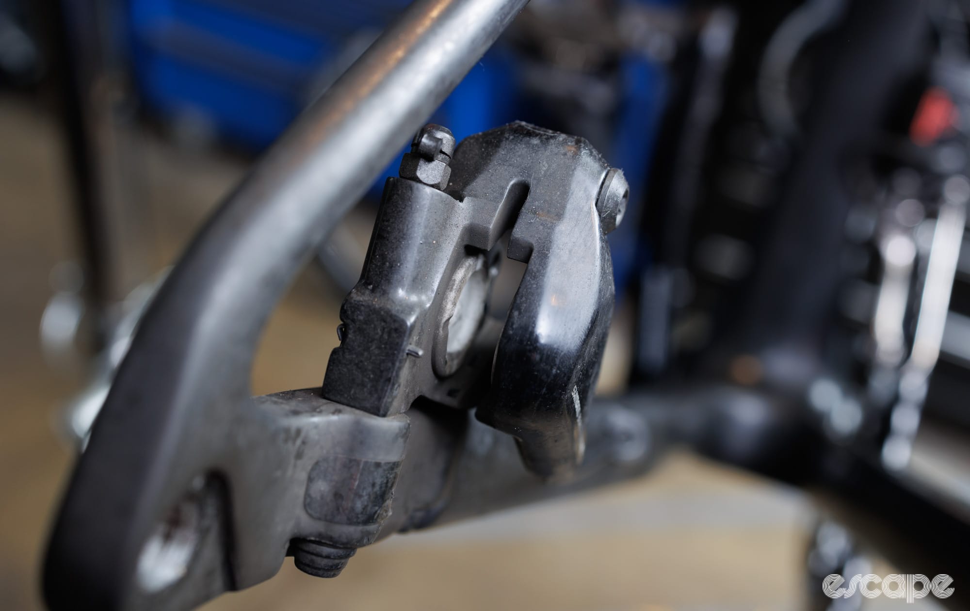

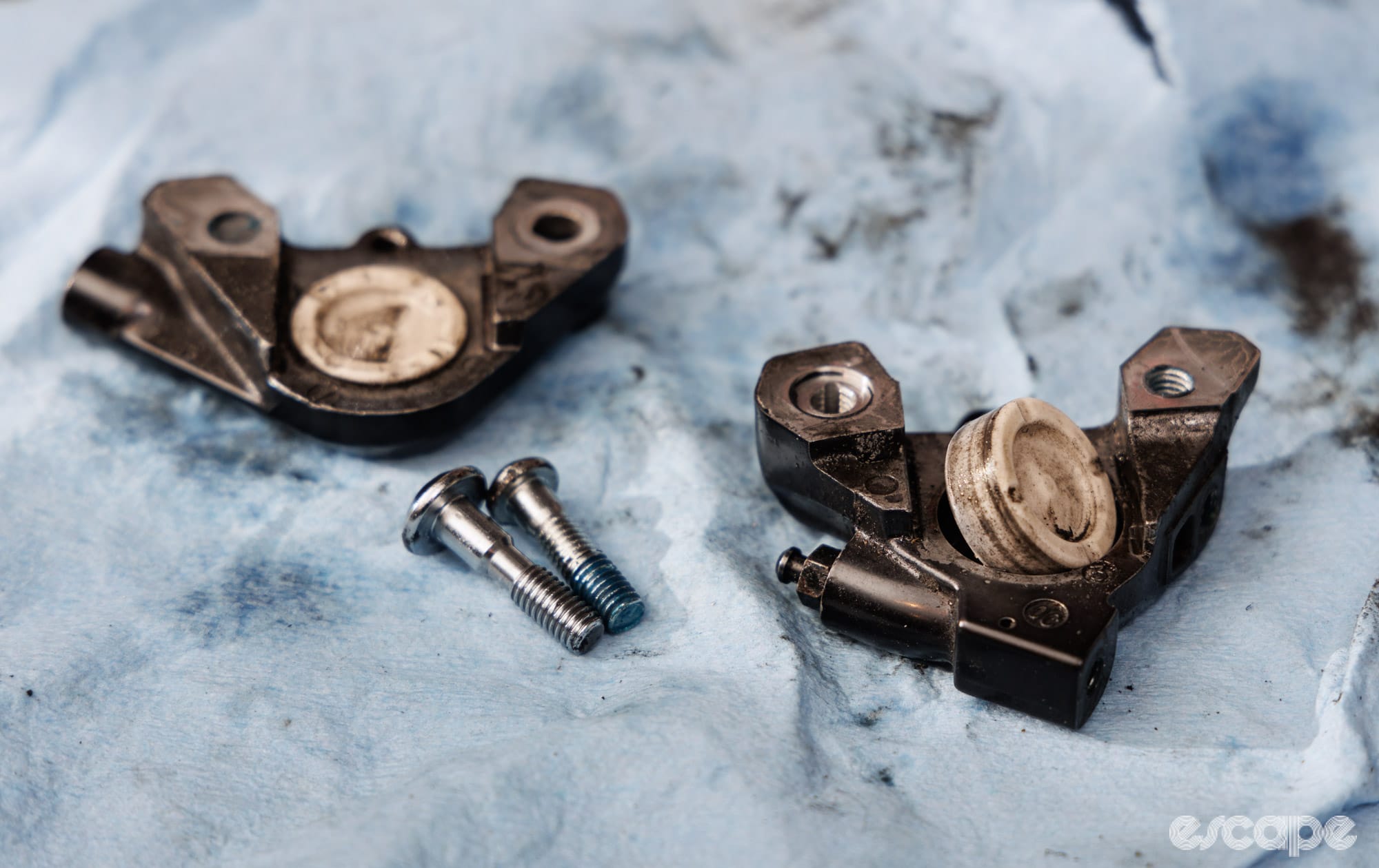

Inside a poorly kept caliper. Grit and brake dust around the pistons (the round components visible) will eventually bring things to a halt in a bad way. This article shares how to avoid that issue.

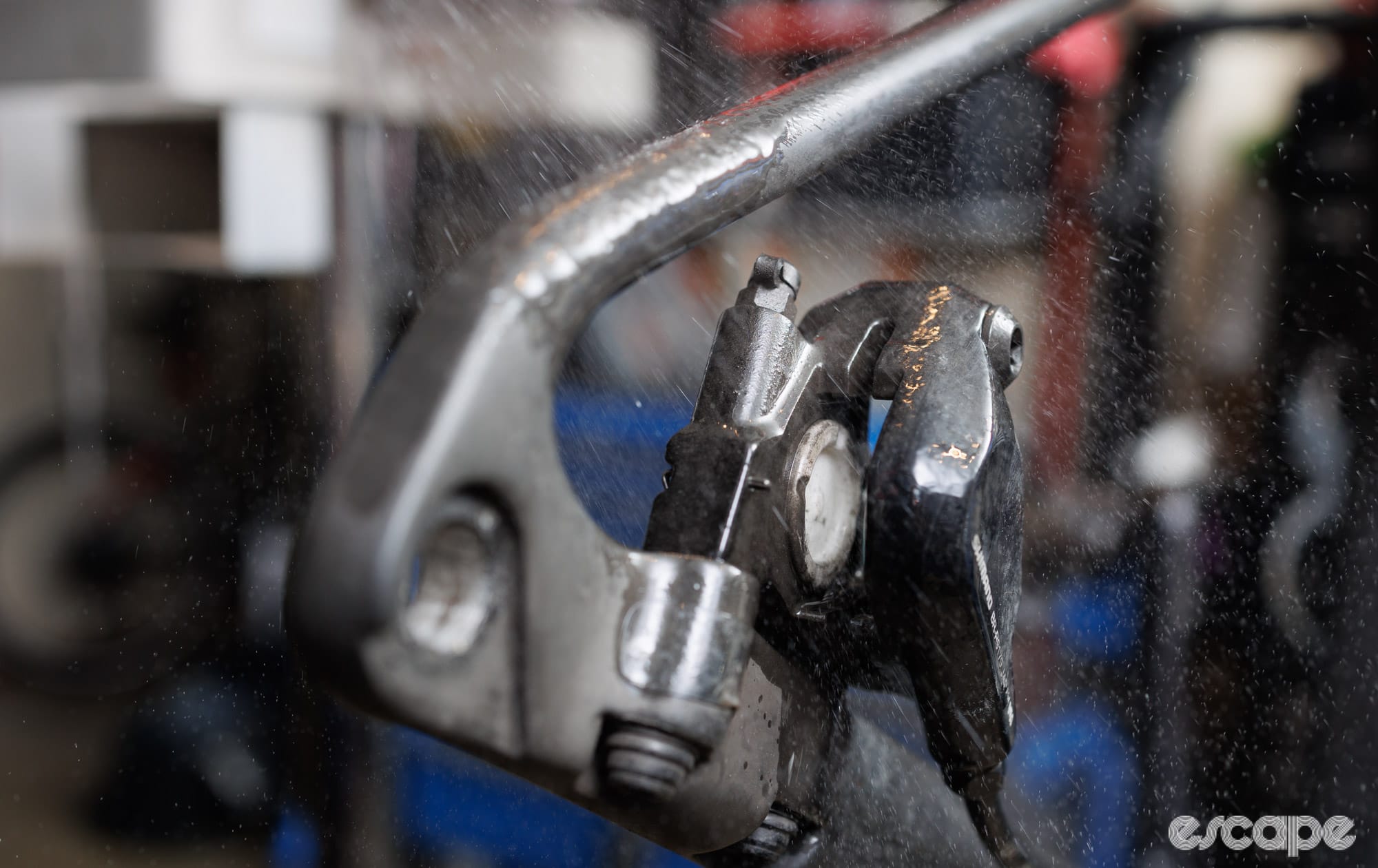

At the simplest level, a little bit of tap water can go a long way to reducing the dust floating around in your brake system. With a watering can or the shower setting of a garden hose, simply spray the brake calipers when it’s time to clean your bike. You don’t need any chemicals or scrubbing here (in fact, it's arguably best to avoid such things) – just a little water will help flush away the worst of the dust.

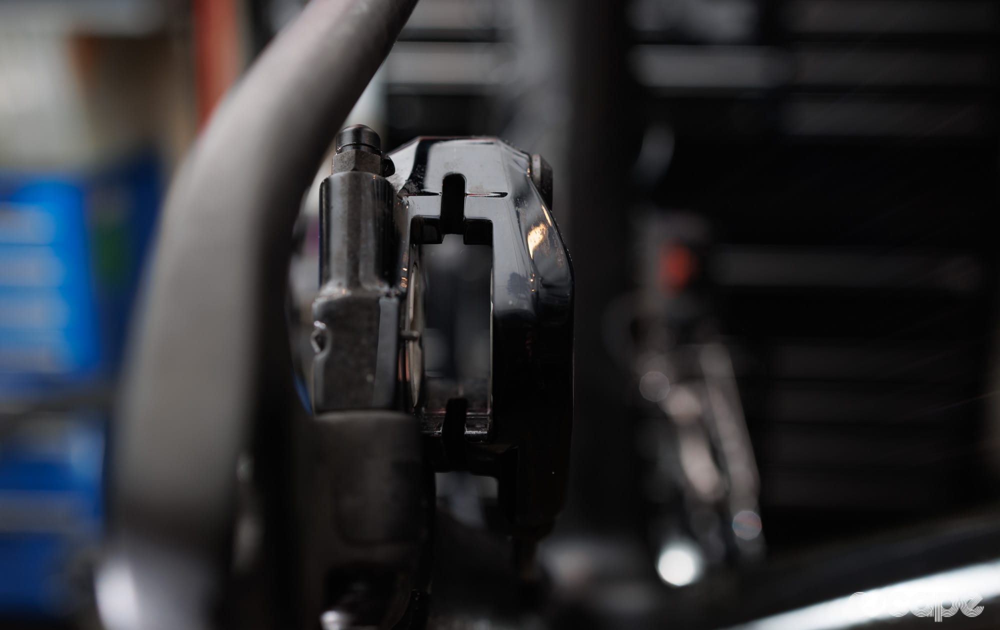

To clean your brake pistons correctly, you'll need to remove the wheel and disc brake pads. If this all feels daunting, I suggest having a bike mechanic handle this task. With the wheel out and pads removed, you should see the pistons marginally exposed.

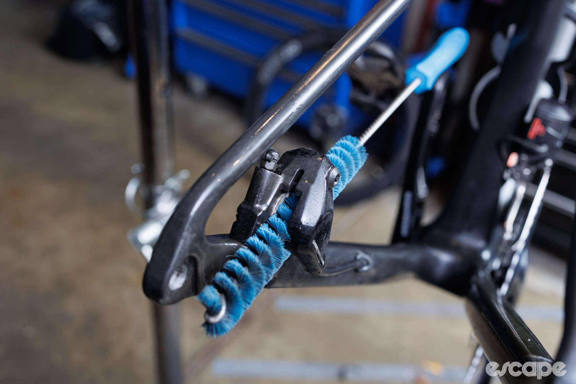

From here, we simply want to clean out the caliper and the exposed portion of the piston. For this, every brake manufacturer recommends the use of isopropyl alcohol, and I certainly agree. Personally, I have ispropyl alcohol (bought from a chemical supplier) in a spray bottle and use a 20 mm Vikan bottle brush to quickly scrub the inside of the caliper. These bottle brushes have proven to be just about perfect for slotting into most brake calipers, and the stiff bristles do an effective job without wasted time.
A helpful tip I got from Troy Laffey at SRAM many years ago is that these Vikan brushes are best when they're shortened (cut the braided steel shaft; the plastic handles simply reverse-thread in place).

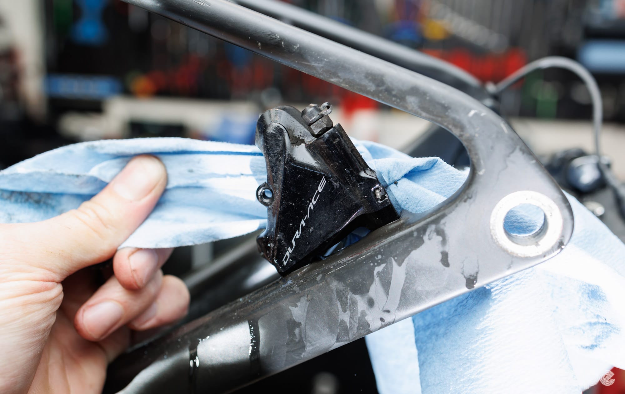

I then like to floss the caliper and wipe the exterior corners with a clean piece of paper towel. Alternatively, and if you don’t have a bottle brush, then flossing with a clean rag or painstakingly wasting cotton buds will get things clean, too.
Finishing by flossing the caliper with a fresh piece of paper towel or rag.
This isn’t a thorough clean (I'll get to that), but those pistons are now ready to be pushed back into their respective bores if you're chasing the easiest path.

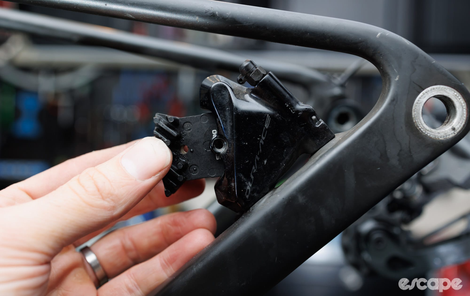

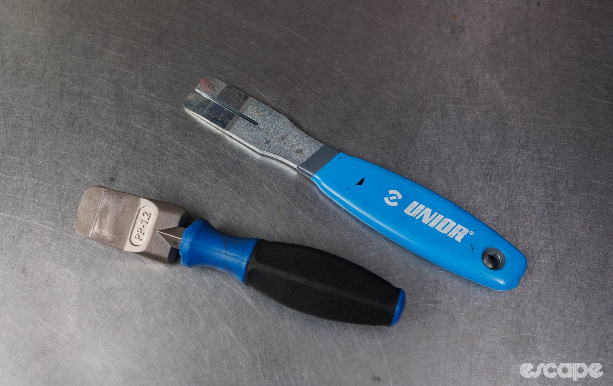

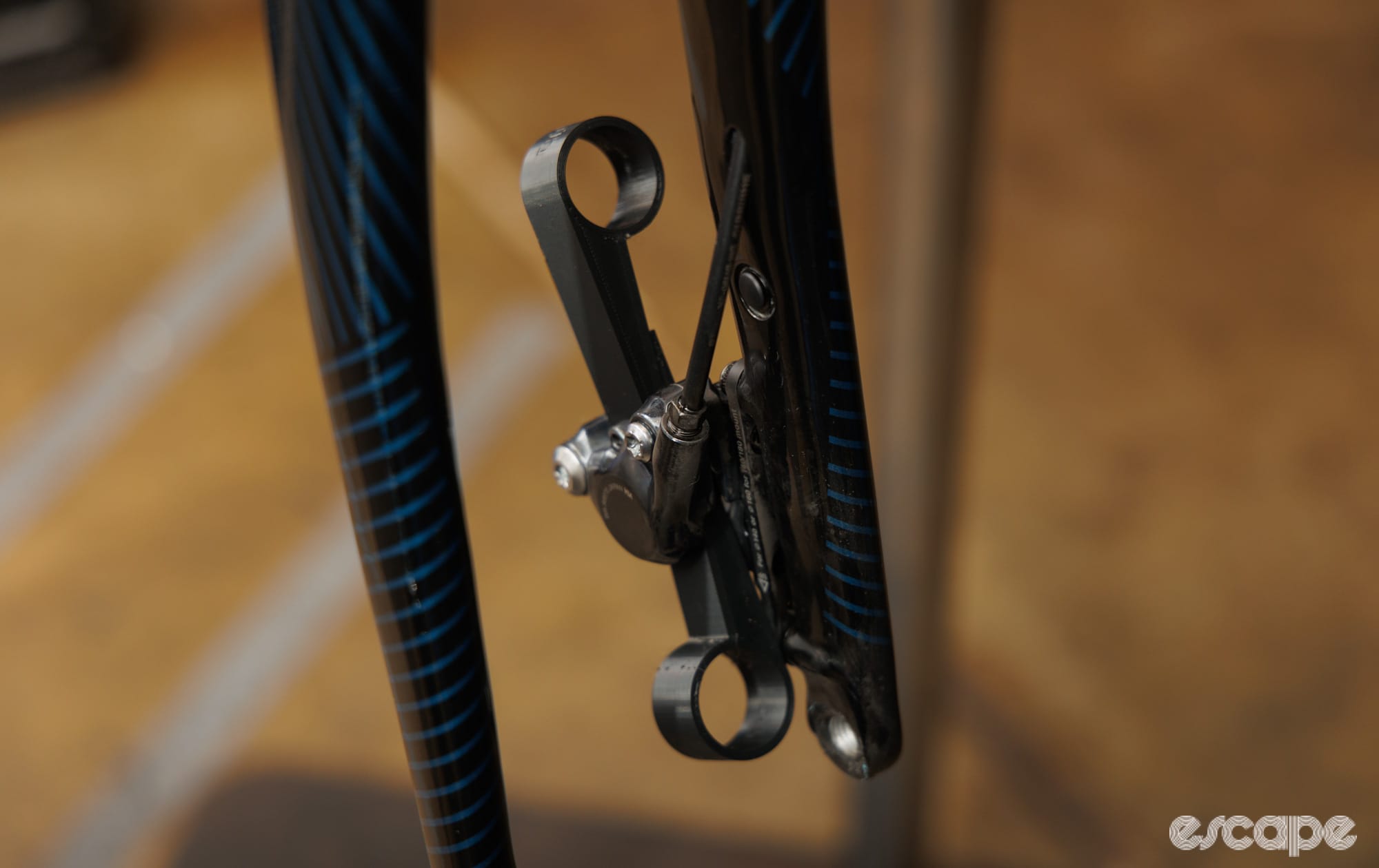

The most basic method for pushing pistons back is to reinstall the old pads, and then use a piston spreader tool (such as the Park Tool PP1.2 or Unior 2 in 1) or a large flat-blade screwdriver to gently spread the pads apart. Again, avoid using excess force.
Tools like these piston/pad spreaders have a place, but I rarely use them.

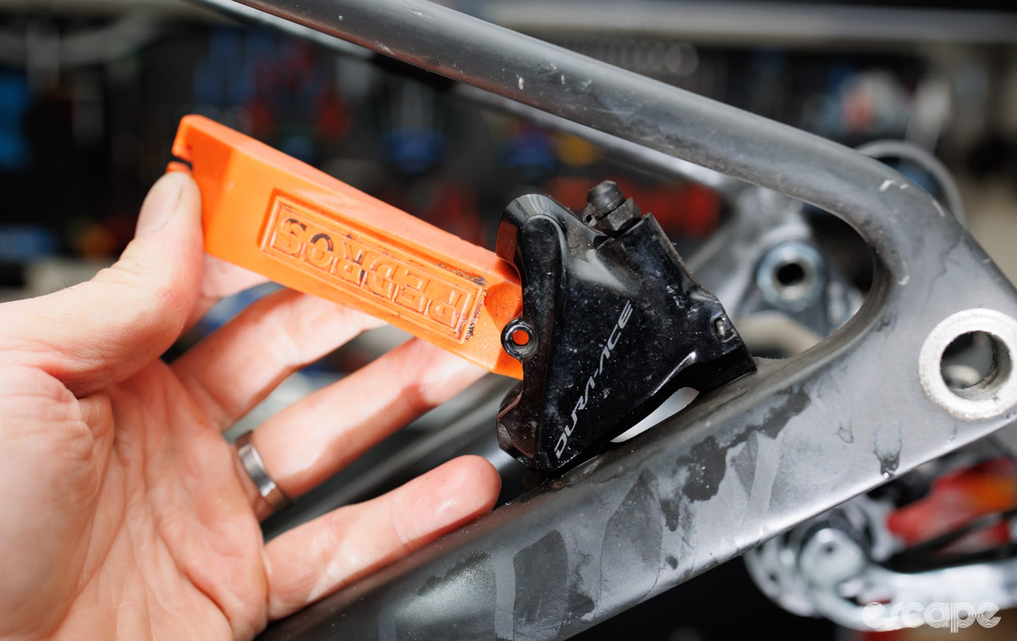

I get far greater control and feel for the task through having no pads in place and then using a plastic tyre lever. Specifically, it’s a Pedro’s tyre lever for most brakes (after extensive testing, I can confirm all the available colours work equally well), but I’ll reach for a slimmer Park Tool TL-1.2C for low-end Shimano calipers, certain Magura calipers, or SRAM Mavens that have a narrower slot. Be sure to push on the centre of the piston or use the flat, middle section of the tyre lever.
Old faithful.

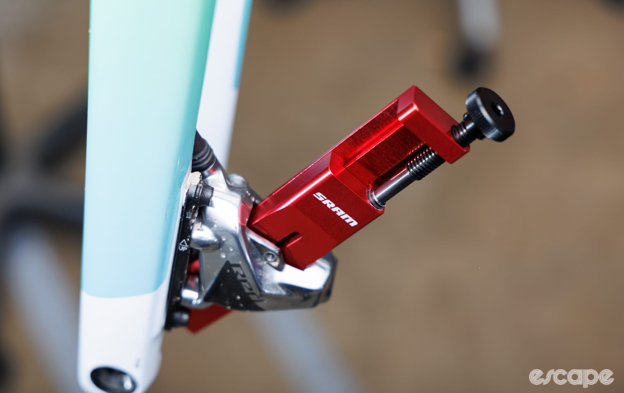

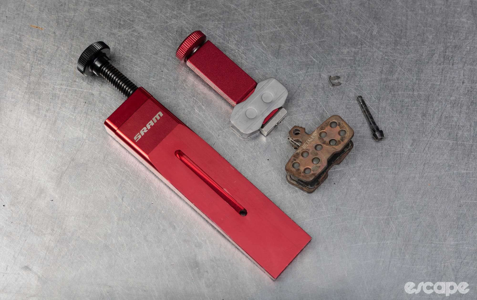

There are now also dedicated piston press tools which aim to ease the task and reduce the risk of pushing pistons back unevenly. The SRAM Ultimate Piston Press tool is a joy to use if the caliper is wide enough to fit it. Copies of this one do exist, but as my previous review notes, the quality isn’t quite the same. There are more affordable and more compact versions from the likes of Sumart.
Meanwhile, Escape member Chris Heerschap (CMH Design) has a 3D-printed wedge tool that he sells on Etsy and also has the files available for free download (there are sellers on Temu and AliExpress that have stolen the design, which is shitty).
More dedicated tools exist today which aid in keeping those pistons square as they're pushed back.
Despite having all these tools, I still often find myself reaching for the plastic tyre lever which is often faster and provides better tactile feel. Other mechanics prefer to use the box end of a 13 or 14 mm combination spanner (this is the most traditional method), while others recommend the rubber-coated handle of a Park Tool cone wrench.
Whatever method you choose, just remember the goal is to push those pistons back evenly, squarely, smoothly, and without damaging the edge of a piston (Shimano ceramic pistons are especially fragile in this regard).
