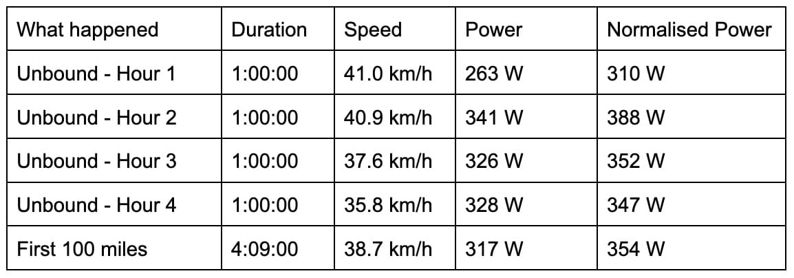

Looking at Jones’ data from the first four hours of Unbound, you would be forgiven for thinking that he had raced the 100-mile course. After the opening hour, which was the only one to average less than 320 watts, Jones went full throttle early. His first four hours read more like a one-day road classic than the opening stanza of a 200-mile slog through Kansas.
It would be easy looking at this to think Jones was competing in the 100-mile event.
Unsurprisingly, Jones’ second hour was the most intense of the whole race, as he decided to throw his cards down and proceed to flip the table with 150 miles of racing remaining. He took off up the road, dragging only Simon Pellaud (Tudor Pro Cycling) away from the chasing peloton in the process. Regardless of Jones’ exact weight, pushing a normalised power of 388 watts for an hour with nearly seven hours of racing ahead is a bold strategy. Things barely settled much in the following two hours either, with his average power only dropping by 15 watts in the third hour, far from a recovery pace after his effort to shake the bunch.
