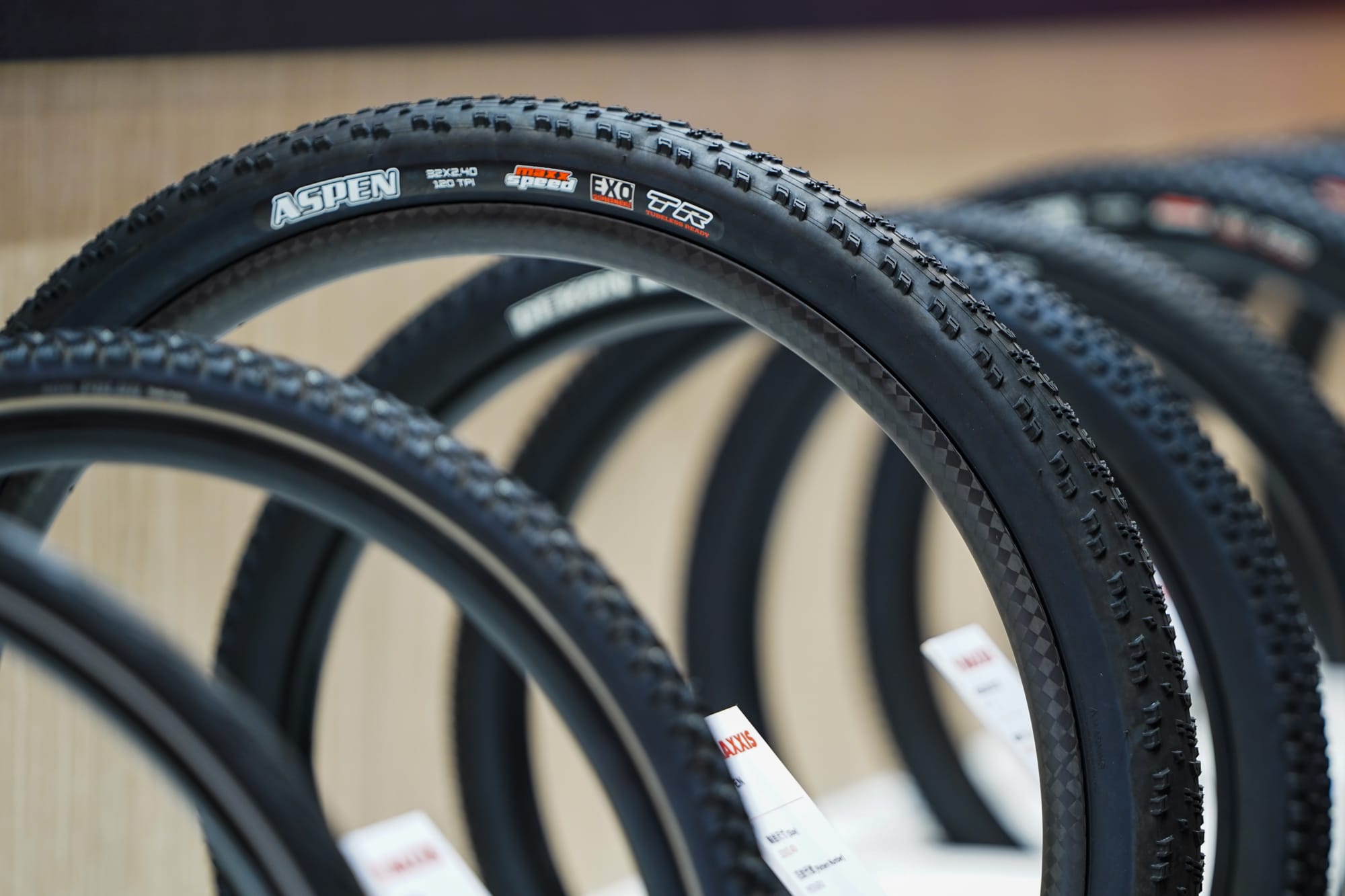

Standing out in a crowd: the 32x2.4" Maxxis Aspen on display at the 2025 Taipei Cycle Show. Photo © Daniel Yang

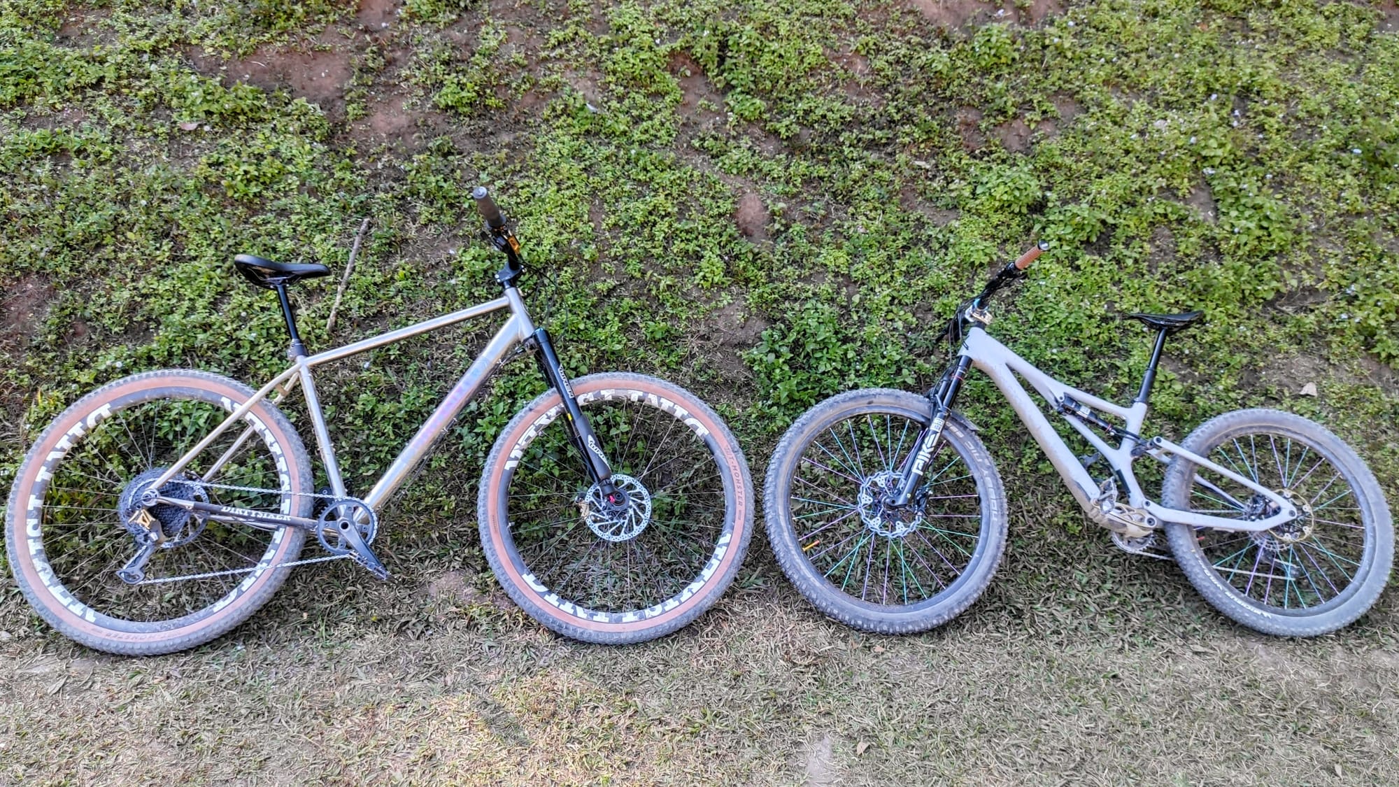

That's not a kid's bike on the right: prototype DirtySixer 32" hardtail compared to Specialized 29er. Photo © DirtySixer
Maxxis, however, recently made a sizable investment in creating the first performance-oriented 32” XC mountain bike tire. According to Mountain Liang, Maxxis' marketing coordinator, the Taiwanese tire manufacturer spent about six months developing a process and having custom machinery built to produce the new 32 x 2.4" Aspen.
“Opening a new mold is quite easy, but the production equipment was another [thing]," Liang told Escape Collective. "Equipment [was] totally different from the current production standard and takes time to adjust. Because of the bigger size, we needed to purchase a new machine for making the pre-cured “green tire” and a bead machine for a bigger bead circle in the semi-finished product.” But now that the machines are in place, Maxxis is proverbially off to the races, and the Aspen is just the start. “Since the big investment of these two machines, we can produce other sizes (width) and patterns," he said. "We’ll expand to more models very soon.”
