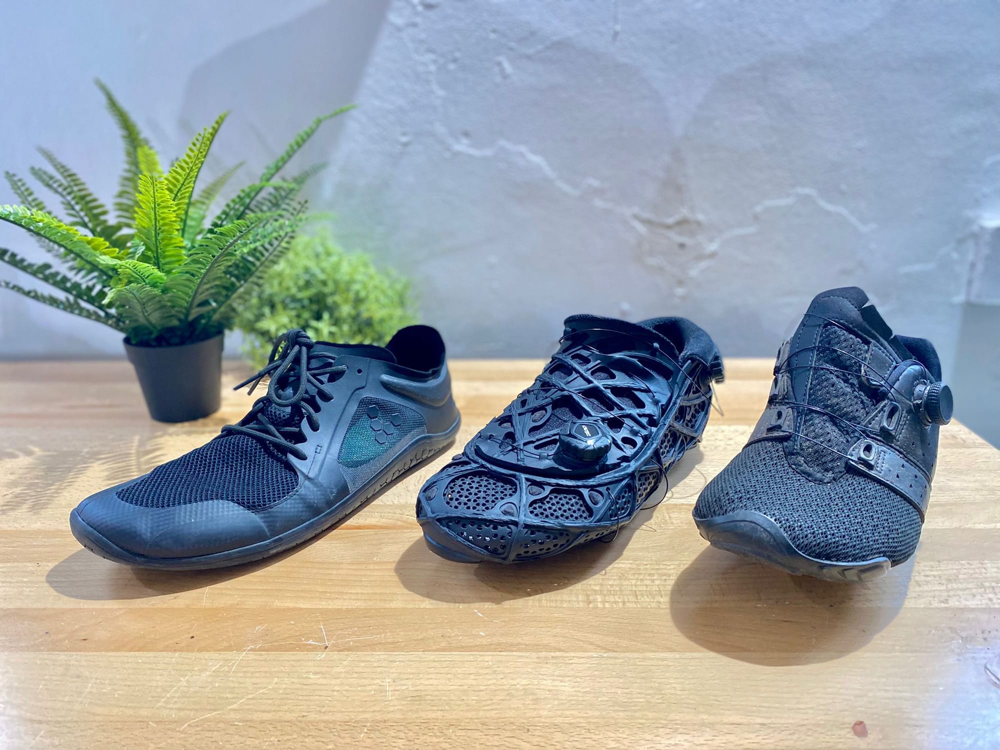

What is a barefoot cycling shoe?
Straight off the bat, this question delivers the first issue. In cycling terms, this question can’t be approached in the same way as general shoes. What constitutes a barefoot cycling shoe is open to debate. A few different takes are floating around, making barefoot cycling shoes hard to define.
With running, it's straightforward. A barefoot shoe has a 0 mm drop from the heel to the forefoot and uses minimal cushioning. Barefoot shoes also have a wider toe box than typical shoes. The rationale is that it allows for natural foot mechanics when you walk or run, but for many people, transitioning to barefoot shoes increases the chance of injury while the foot adapts and strengthens.
The issue with transferring this to cycling is that cycling isn’t an anatomical movement. As much as it pains me to admit it, humans were never intended to spend hours pedalling bikes, and as a result, it is an alien movement for the body. This means more support is required to prevent injuries and compensate for natural asymmetry. In cycling, 'barefoot-style' doesn't mean riding without shoes, or even ultra-minimalism, but rather refers to design elements such as flat soles, no heel lift, and roomy toe boxes that allow for more natural foot function.
Any attempt at a barefoot cycling shoe will differ from a barefoot running shoe in a few ways. The most notable is that it cannot use a minimalist soft sole. The foot interacts with the pedal in a concentrated area around the ball of the foot. Without a rigid base, the foot would collapse around the shoe, and the movement would quickly fatigue the foot, opening it up to potential repetitive strain injuries.
You can use softer-soled shoes like flat mountain bike shoes, but all this does is move the rigid base from the shoe to the pedal. Flat pedals use a far wider platform than clipless pedals to create a solid base for the foot to act against.

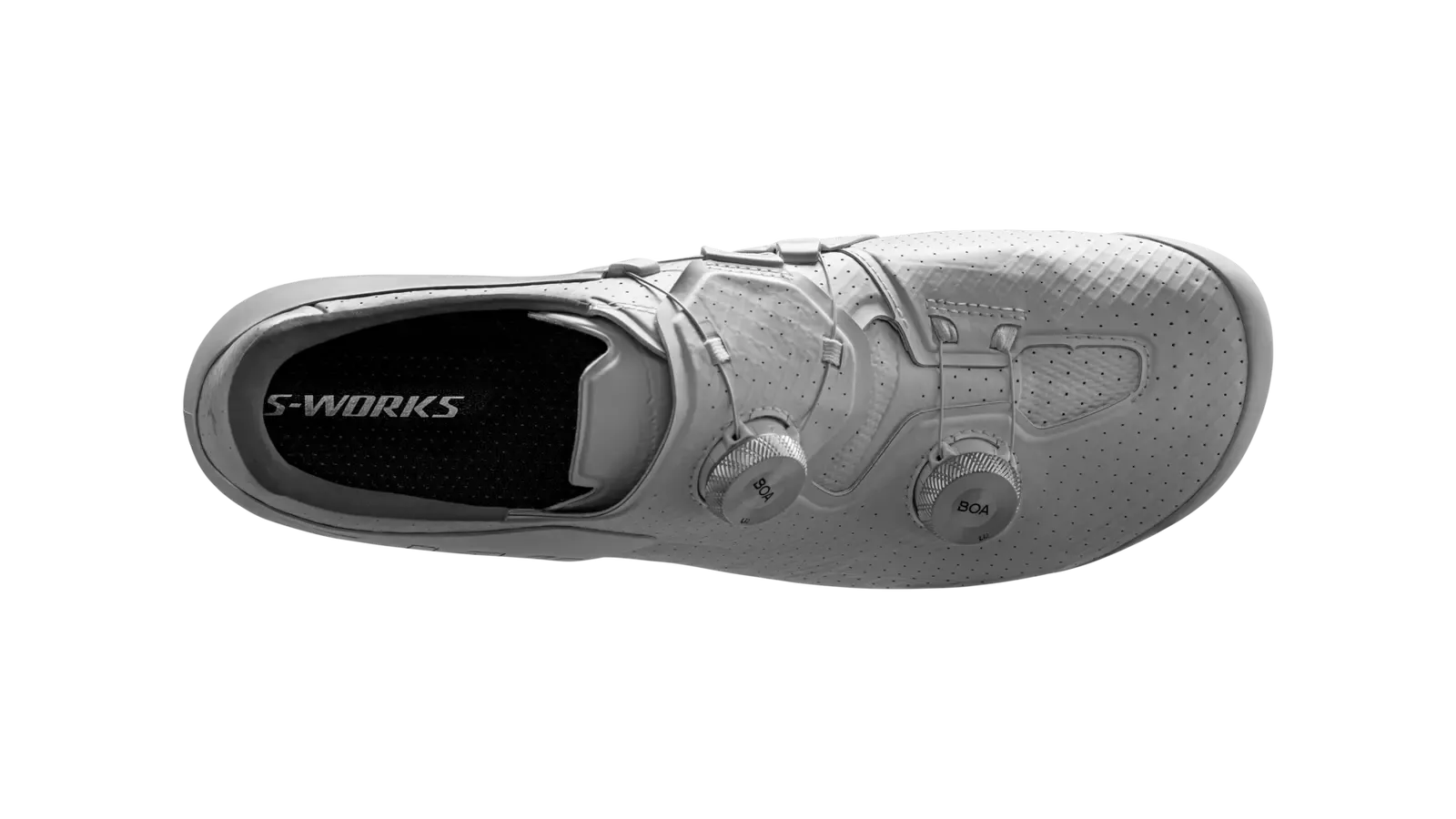

Under cycling’s definition of a barefoot shoe, Lore was the first to bring this concept to the market, with Strong Feet Athletics following suit with its take. Beyond these brands, some concepts explored in barefoot cycling shoes are spilling over to the mainstream. Many brands now offer a separate wide-fit shoe, increasing the width across the toe box. Specialized is one of the latest brands, with its Ares 2 shoe, to increase toe box width for its ‘standard’ width high-performance road shoe.
Considering that the Ares 2 is positioned as a high-performance shoe, which is claimed to offer power gains, the fact that it borrows design inspiration from barefoot-style cycling shoes moves the concept from niche to fairly mainstream. This isn’t to say that the Ares 2 is a barefoot-style cycling shoe, but it nods in that direction and deviates from standard performance shoe designs of the past.
Speaking about the wider toe box, Drake points out, “Widening the toe box doesn't necessarily improve the fit or function of the shoe if the foot is too narrow for that new widened toe box.”
“This introduces slop and lack of force transfer, making the foot work harder to correct itself and transfer the load compared to if it were properly contained in the shoe.” Although wide shoes can be a step in the right direction for many, they cannot be seen as a blanket solution.

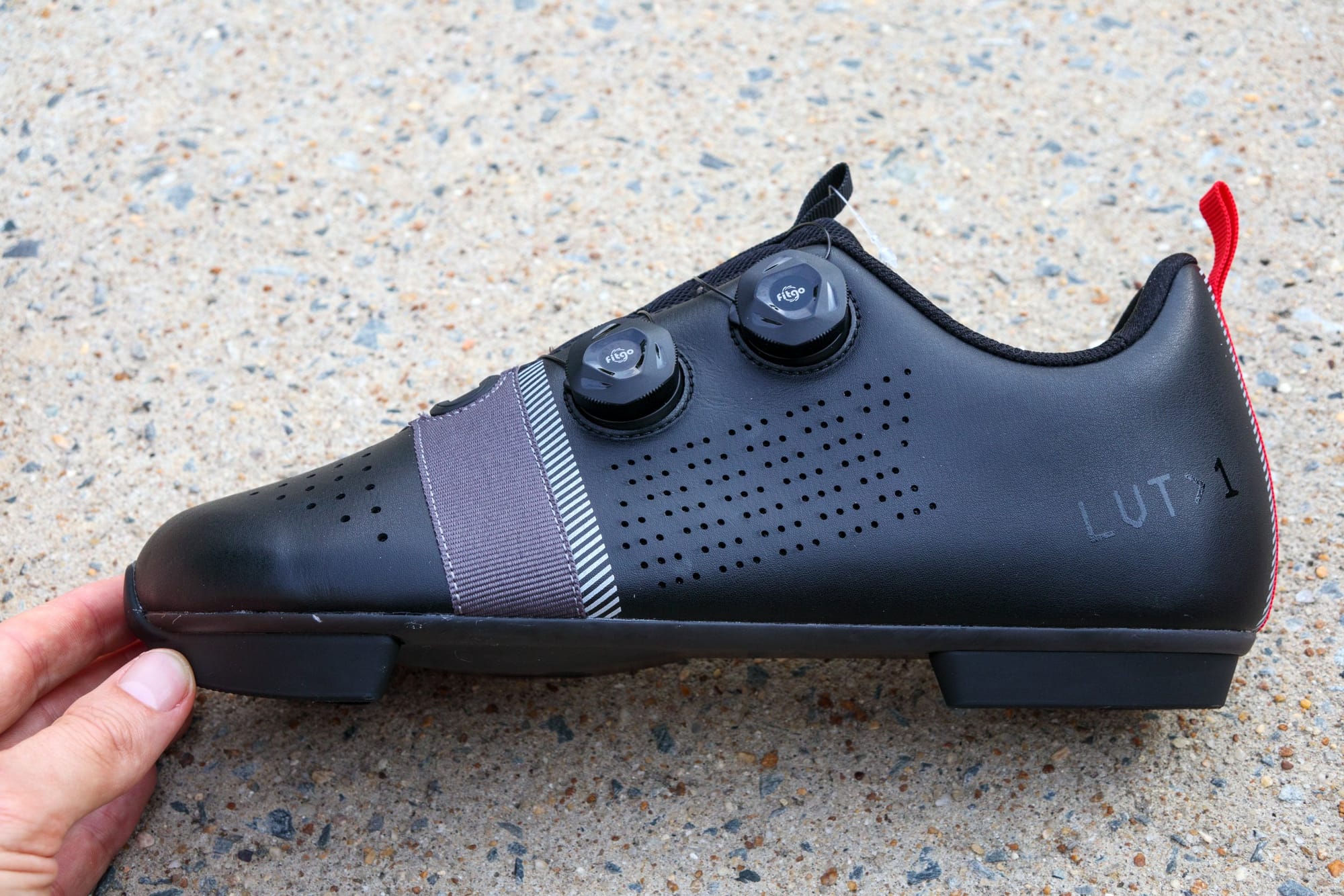

Toe spring and heel rise
Barefoot-style cycling shoes like the Leviathan from Strong Feet Athletics use a completely flat sole, ticking one of the key boxes of a barefoot shoe: removing any drop from the rear to the front of the shoe.
This shape is said to allow for a more natural foot function on the bike. A zero-drop shoe places your foot in a position that mimics standing on a flat surface; the rationale is that it allows the foot muscles to stabilise themselves rather than forcing the foot to conform to a manufactured position.
