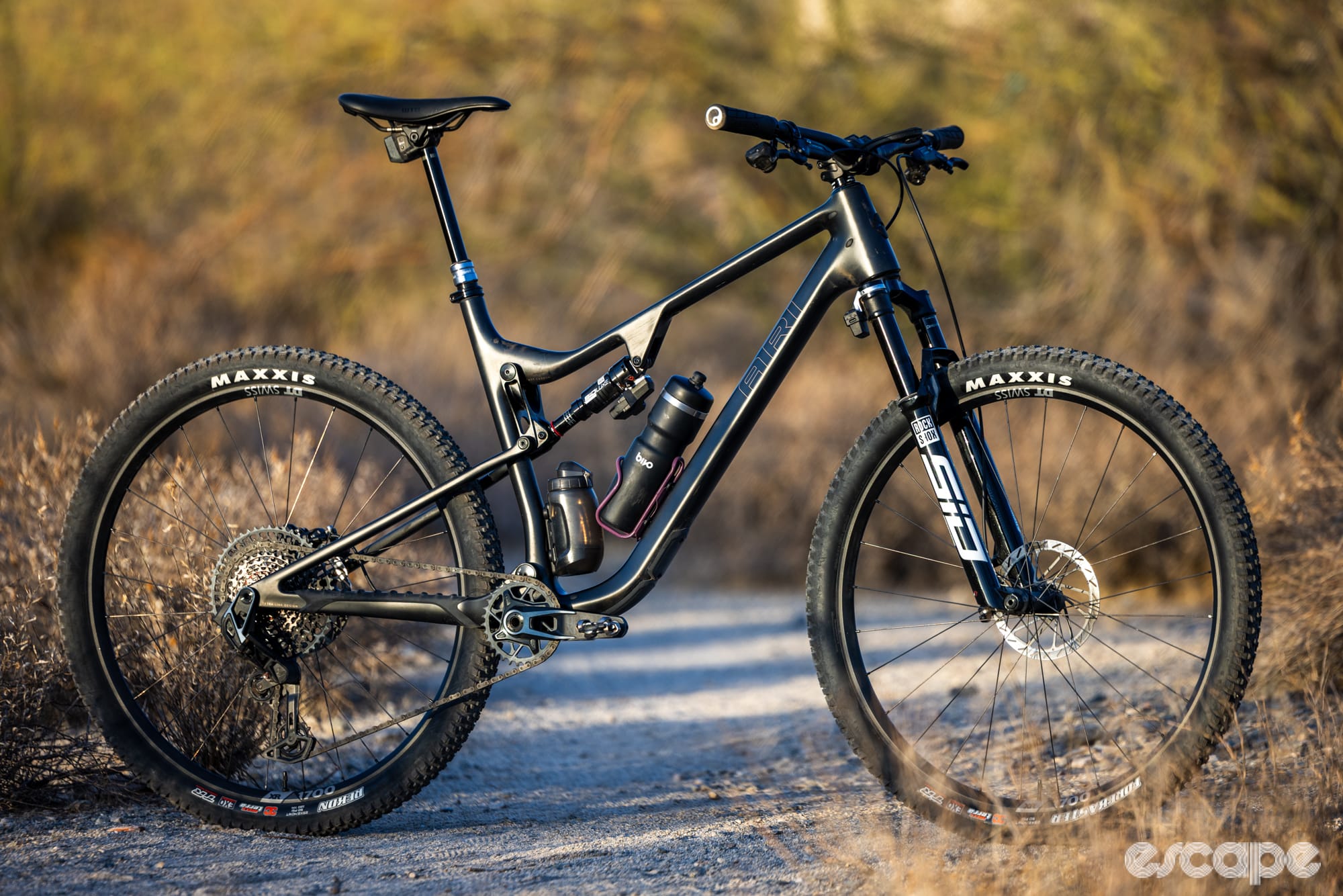

Named after one of the highest points in southwestern Utah, Ari Bikes’ home state, the third iteration of the Signal Peak has been revamped for higher competencies on XC courses, for big mountain days, endurance events, and lengthy stage races. This short-travel platform utilizes a (reportedly) stronger yet lighter carbon fiber layup than previous versions, with the top-end build weighing in under 25 pounds (11.3 kg). Its 110 mm (rear) / 120 mm (front) suspension has been redesigned and now features a monocoque rear triangle with flex seatstays rather than a rear pivot to shed weight.
Embracing trends for steeper seat angles and slacker head tubes for optimized pedaling and descending prowess, the new version’s 66.5° head angle gets 0.5° slacker, with a 76° seat tube angle that is 1° steeper than the 2.0. And there’s a lot more to the Signal Peak story, including a handful of nitpicks, all of which I’ll report in detail below.

Considering both the trail and race settings I’d be using the bike in, Bishop suggested the “Pro” build with some upgrades. Positioned in the middle of Ari’s five build tiers, the Pro comes with SRAM XO AXS Transmission drivetrain, RockShox SID Ultimate Fork, SIDLuxe Ultimate shock, Motive Silver brakes, DT Swiss XR 1700 wheelset, and other commensurate parts for US$6,400.

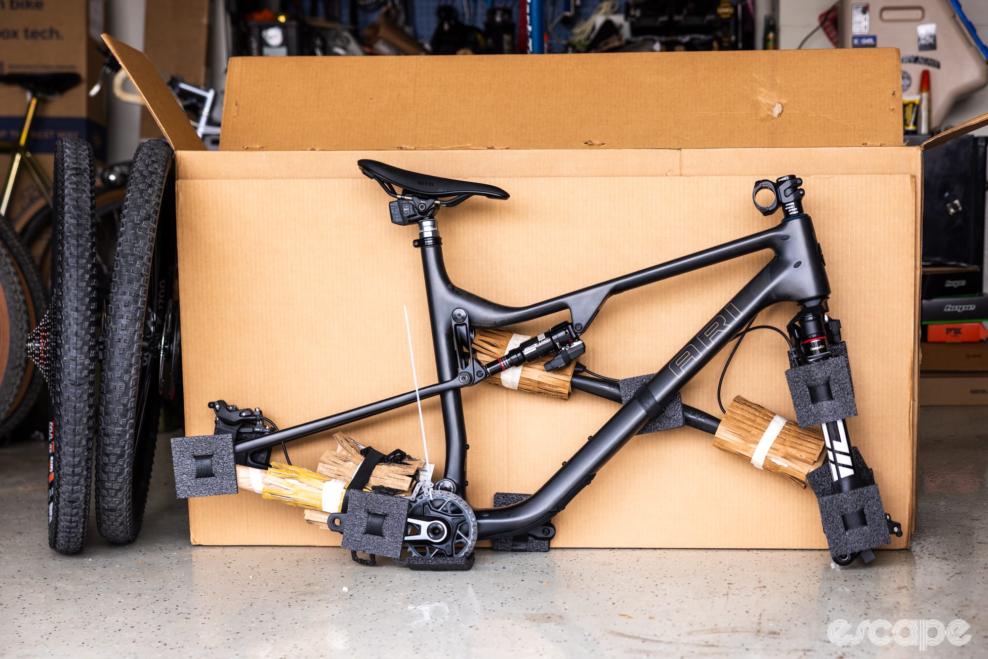

The Signal Peak arrived in two packages: one containing the frame and components, and another with the wheels inside. Ari preassembled the bike in its Utah facility, removing only a few components required to fit securely in the boxes. All I had to do to make it rideable was install the wheels, attach the handlebars to the stem, and mount the derailleur per SRAM’s T-Type instructions. Freshly built, before adding water bottle cages or my Wolf Tooth Encase pump, the complete bike weighed 28.10 lbs (12.75 kg).

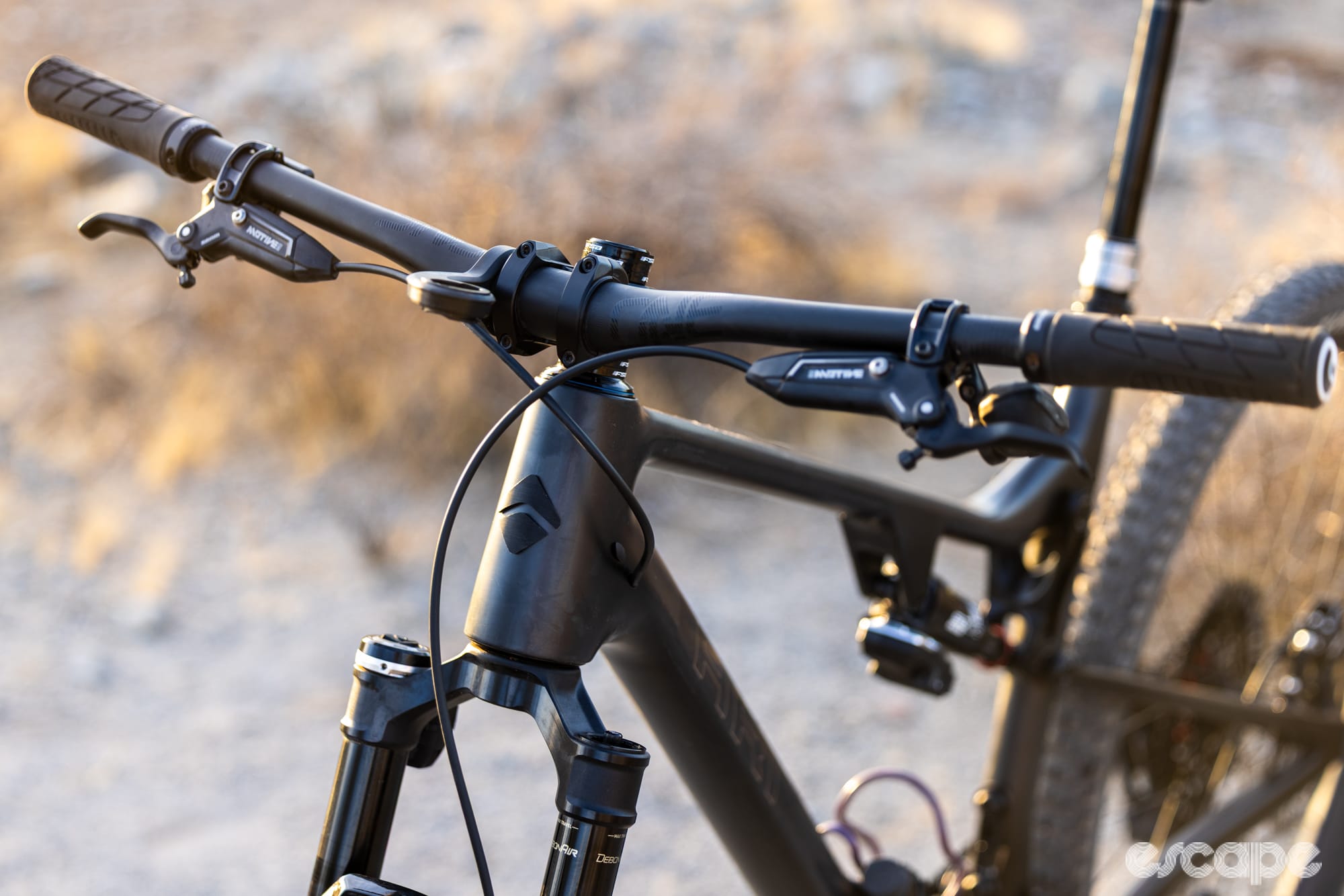

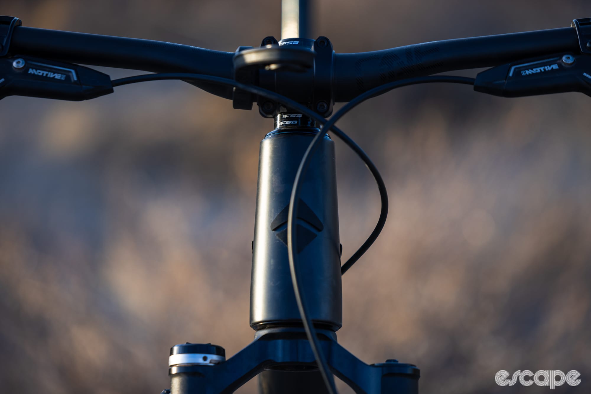

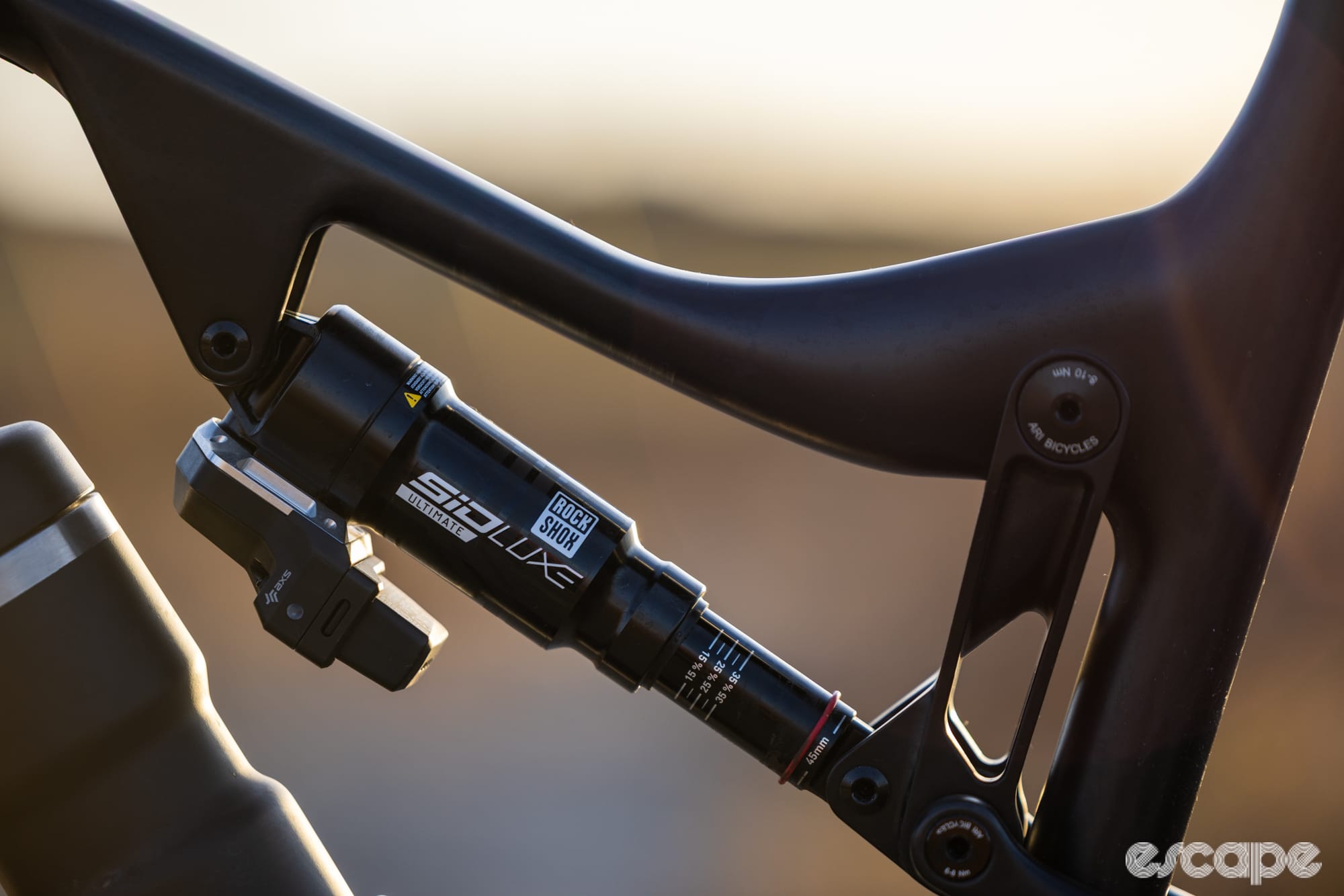

The first thing that stood out to me about the frame was the absence of thru-headset cable routing. Thank you, Ari! According to Ty Bishop, Ari wanted to make the Signal Peak easily serviceable and, opposite its dropbar lineup, which doesn’t have forks that need to be dropped for regular service intervals, Ari’s mountain bikes do. So, keeping the cables out of the headset was important. Adding to that straightforward ownership, the frame has tube-in-tube routing. The rear suspension linkage was also designed to be easily maintainable, as the bearings are pressed into the rocker link rather than into the frame itself. That means the whole piece can be removed from the frame to service bearings on a workbench rather than on the bike in a stand, and if you botch the process, it’s just a replaceable part.
