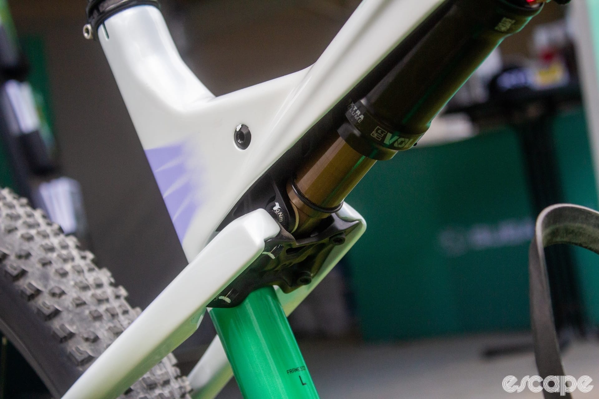

Andreassen runs a different suspension linkage that adds 10 mm of rear wheel travel and subtly steepens the head angle.
The Oiz is designed around 120 mm of rear travel; however, Andreassen is running a different linkage that bumps the travel provided by his Fox Float SL up to 130 mm. Oddly, the reasoning for this was that it was the easiest way to steepen the head angle, pushing it to 67° like the old frame. This is matched with the stock 120 mm of travel in the Fox Float 34 SL up front.
