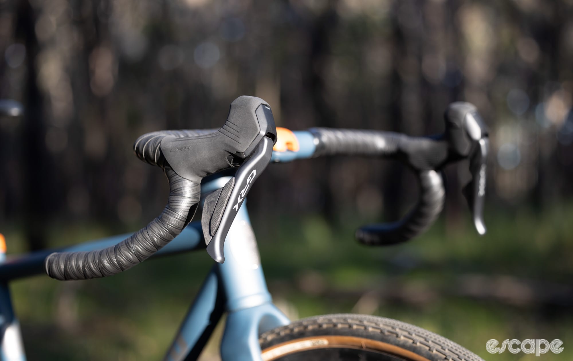

Today Classified has announced a much-anticipated change, one that allows the Powershift hub to be shifted wirelessly and directly from a Shimano Di2 shifter.

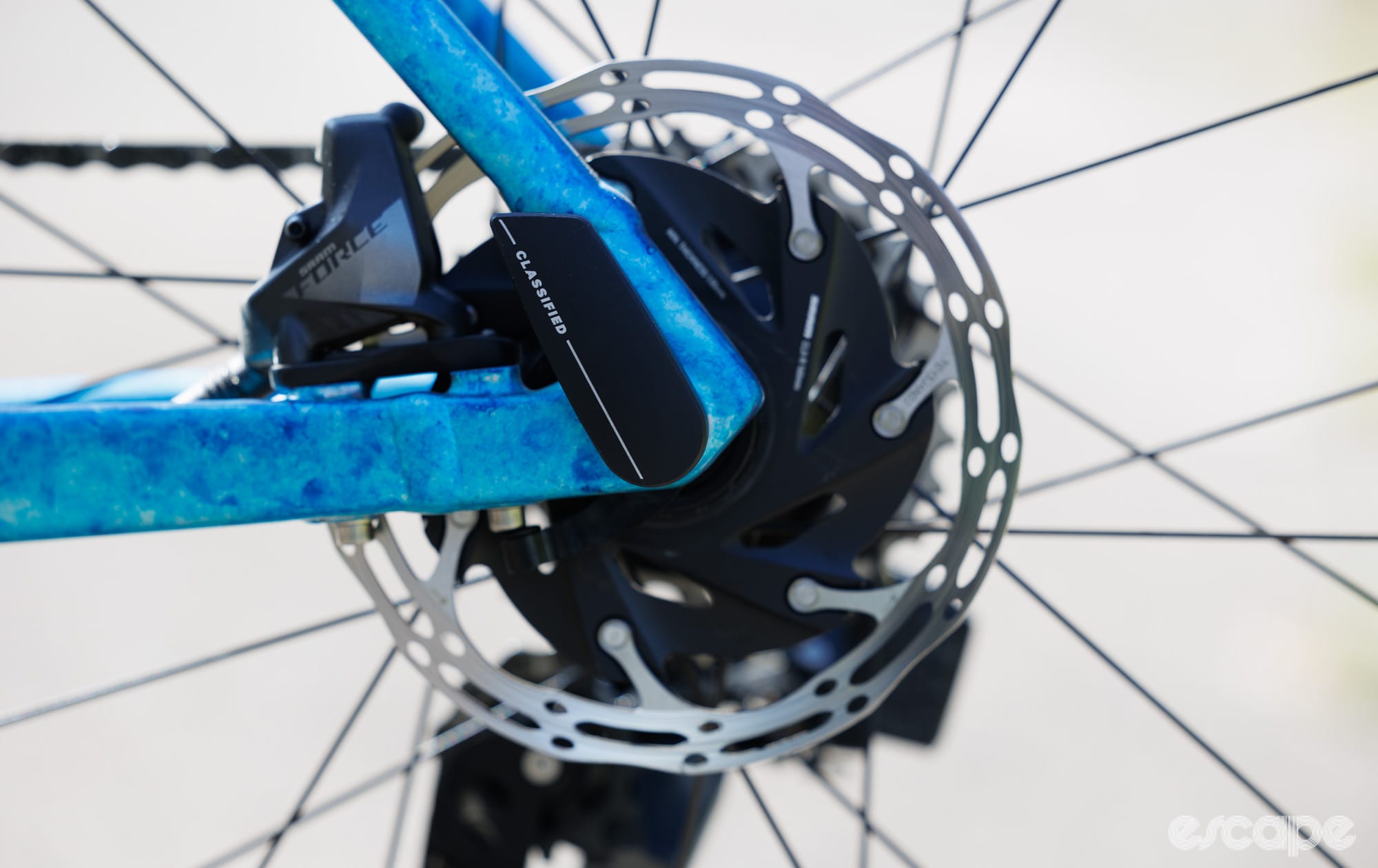

Classified is achieving this connectivity through a firmware update within its own wireless receiver (built into its thru-axle handle). Existing owners of the Classified system can connect to the Classified app to perform the update.
The firmware update is done to the wireless receiver, located in the thru-axle assembly.

The integration will work on any Di2 system that’s capable of wirelessly connecting to Shimano’s E-Tube app. That includes any 12-speed generation shifter or older 11-speed components that are fitted with the wireless-connection D-fly unit (EW-WU111B). And while Classified hasn’t claimed as much, I’d think there’s potential to configure the function button of the newly released XTR M9200 Di2 shifters to perform the task, too.
Any 12-speed Shimano Di2 shifter is ready to work with the update. Wired 11-speed Di2 systems will need the Shimano D-fly unit.

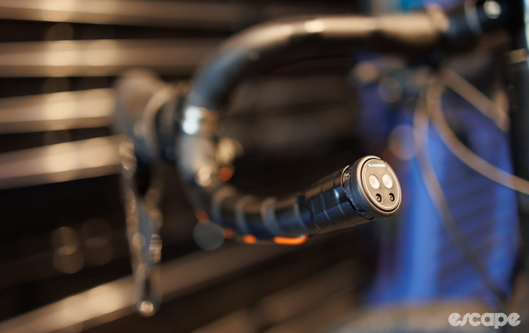

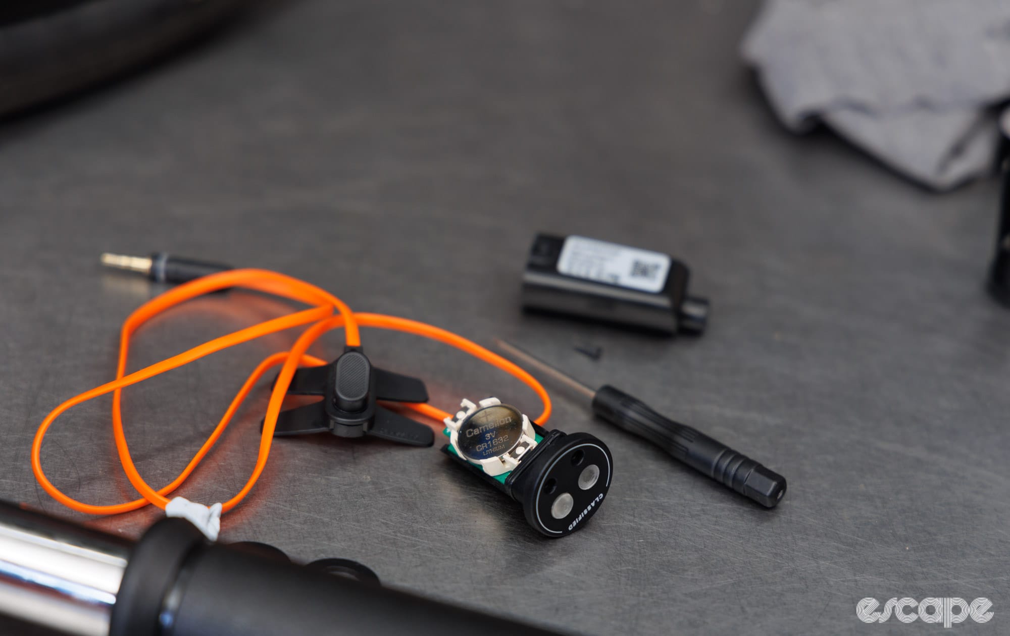

Unlike Classified’s original system, this update removes the need for the company’s separate shifter and wireless handlebar transmitter. It promises a vastly cleaner setup.

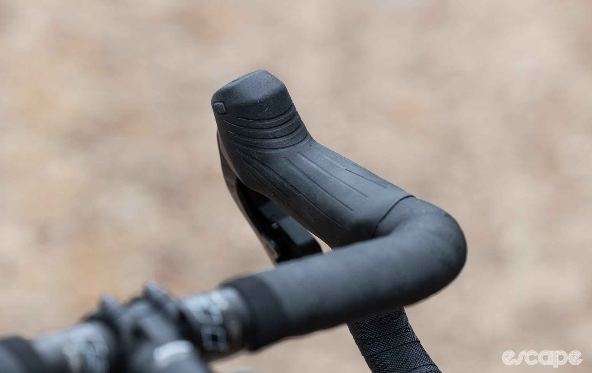

In the meantime, I suspect there’s more than a few potential customers now awaiting news of SRAM AXS connectivity, and to add pure speculation, I’d say the Bonus Button found on the new E1 generation of Red and Force shifters could be the answer to that.
The bonus buttons on SRAM's E1 shifters can also control some Bluetooth devices. Time will tell if Classified can make that connection happen.
