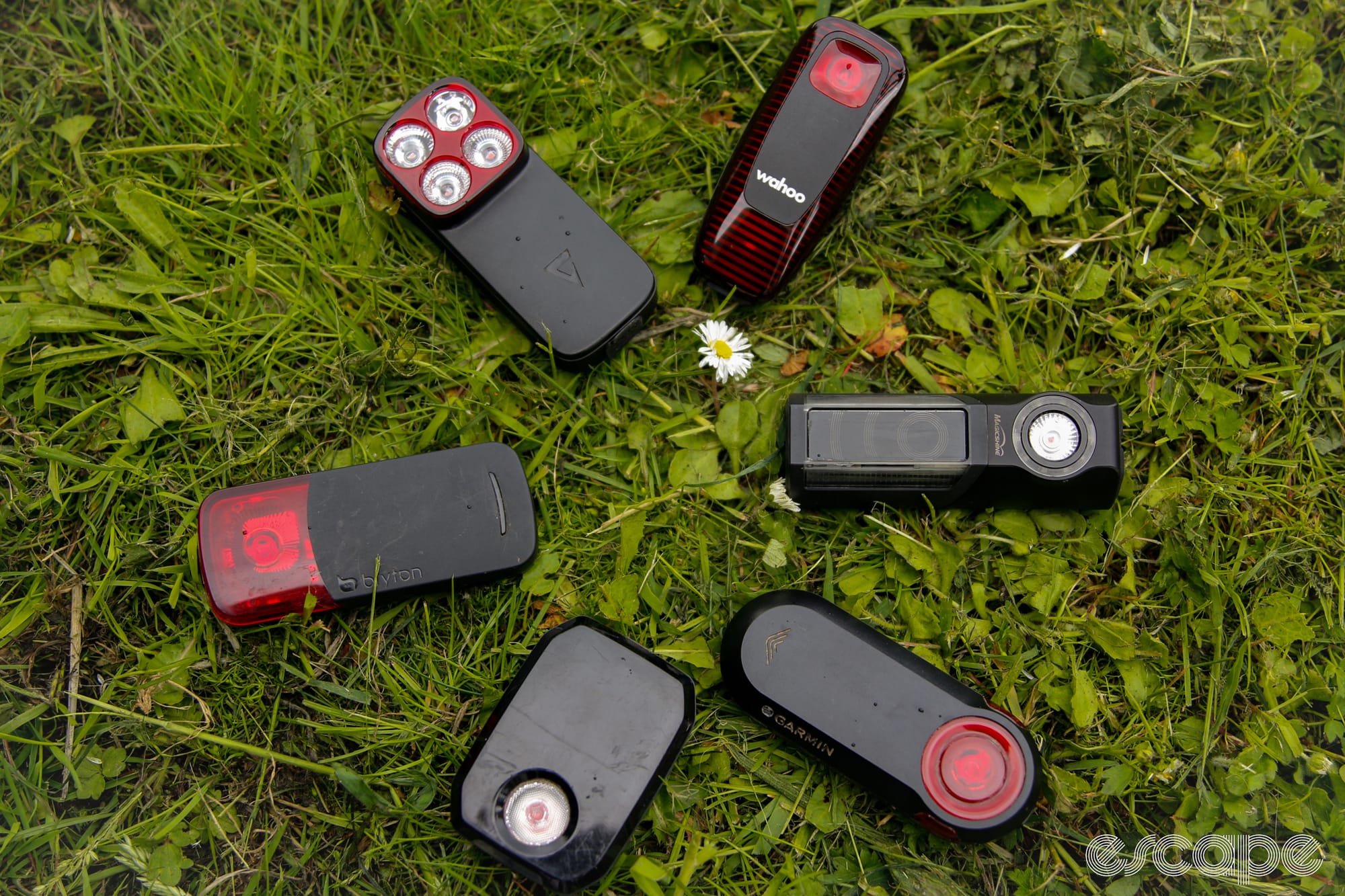

This group test reviews six rear radars that are currently available: Garmin Varia RTL515 , Bryton Gardia R300L, Trek CarBack, Magicshine Seemee 300, Giant Recon+ TL300 R, and the newly released Wahoo Trackr radar. Yes, there are lots more radars out there, but as you'll see, it's better to pick the right one once rather than try the newest thing twice. Or thrice.

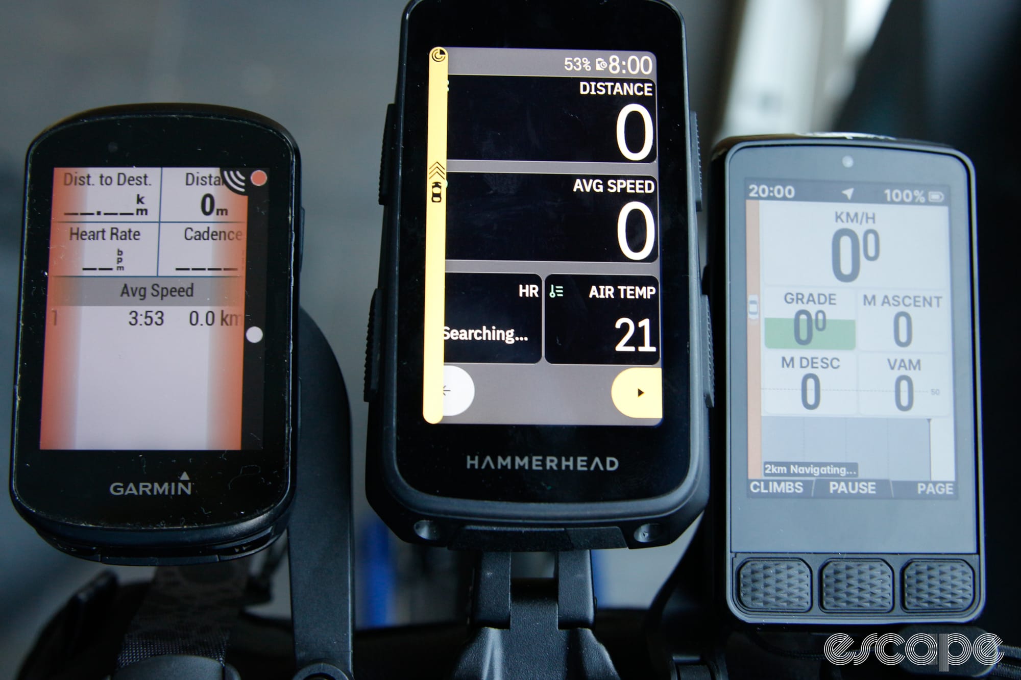

Some of the head units I used for testing, all showing the same car approaching.
