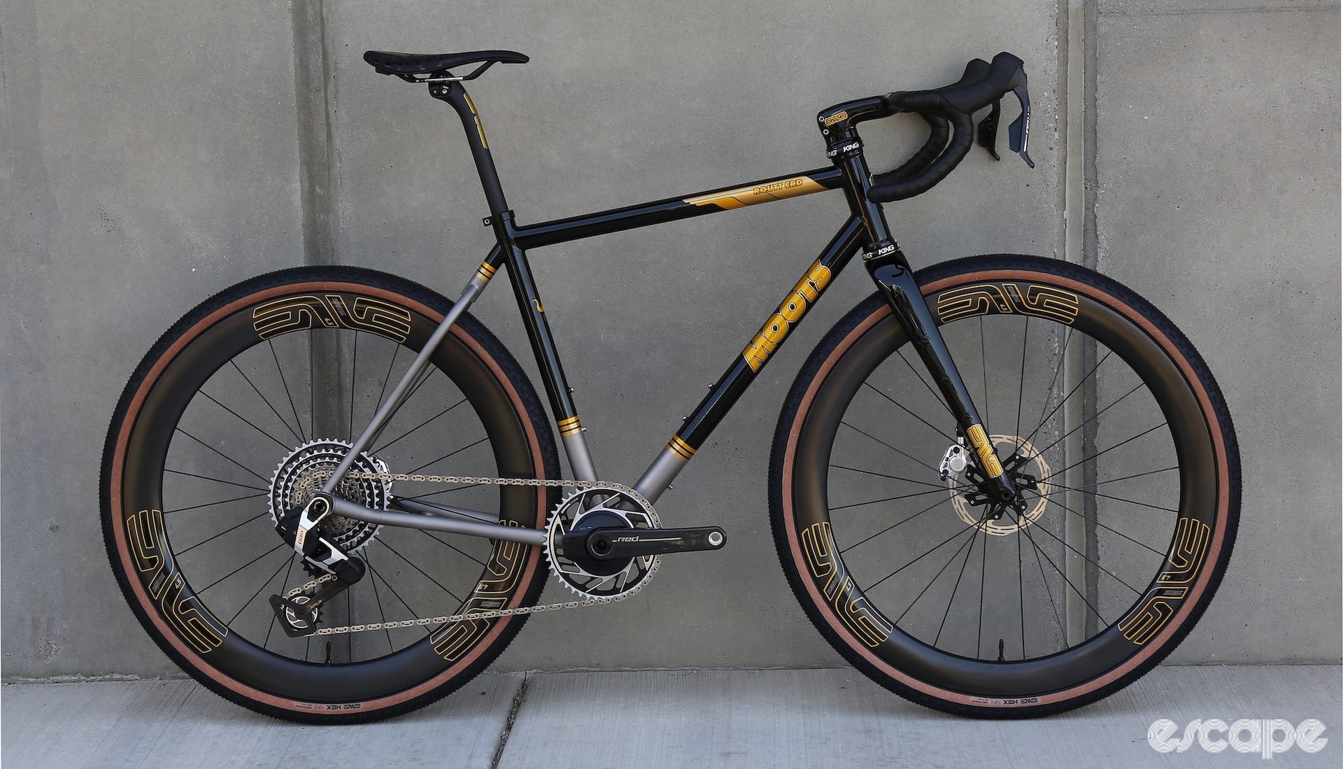

Moots Routt CRD
CRD stands for Complete Race Design, which takes the Routt gravel bike and optimizes it for fast riding. The top tube and down tube use butted tubes from Reynolds, with the rest of the frame being US-sourced straight gauge tubing from Alleima (formerly Sandvik). The geometry gets a bit tighter than the standard Routt, with 7 mm shorter chainstays (down to 430 mm), and a slightly steeper (71.25° on a size 55 cm) head tube angle. Tubes are all round with the exception of the shaping of the chainstays and a slight ovalisation of the top tube where it meets the seat tube. The butted tubes can be trimmed from both ends, so the butt profile can be varied over frame sizes – for example increasing the butted section at the front of the down tube to compensate for the added leverage of a longer head tube.
Nate Bradley, the president of Moots, got my craziness award for the weekend – he raced (and won) a six hour mountain bike race on Friday evening (that finished at midnight), and then was ready to roll out for the 92-mile gravel ride at 7AM on Saturday.
Moots continue to produce titanium frames in Steamboat Springs, with an operations team of 12 producing around 1,000 frames a year. About 90% are sold through their dealer network, with the rest being direct to customer. Everything is built to order. Roughly 60% of the output is gravel, with the remainder split between road and mountain. Moots use a third party testing facility in California for destructive fatigue testing. This helps identify any weaknesses, and then both the design and process can be critiqued for improvements – whether for example that is a wall thickness change or a modification of the tacking sequence.

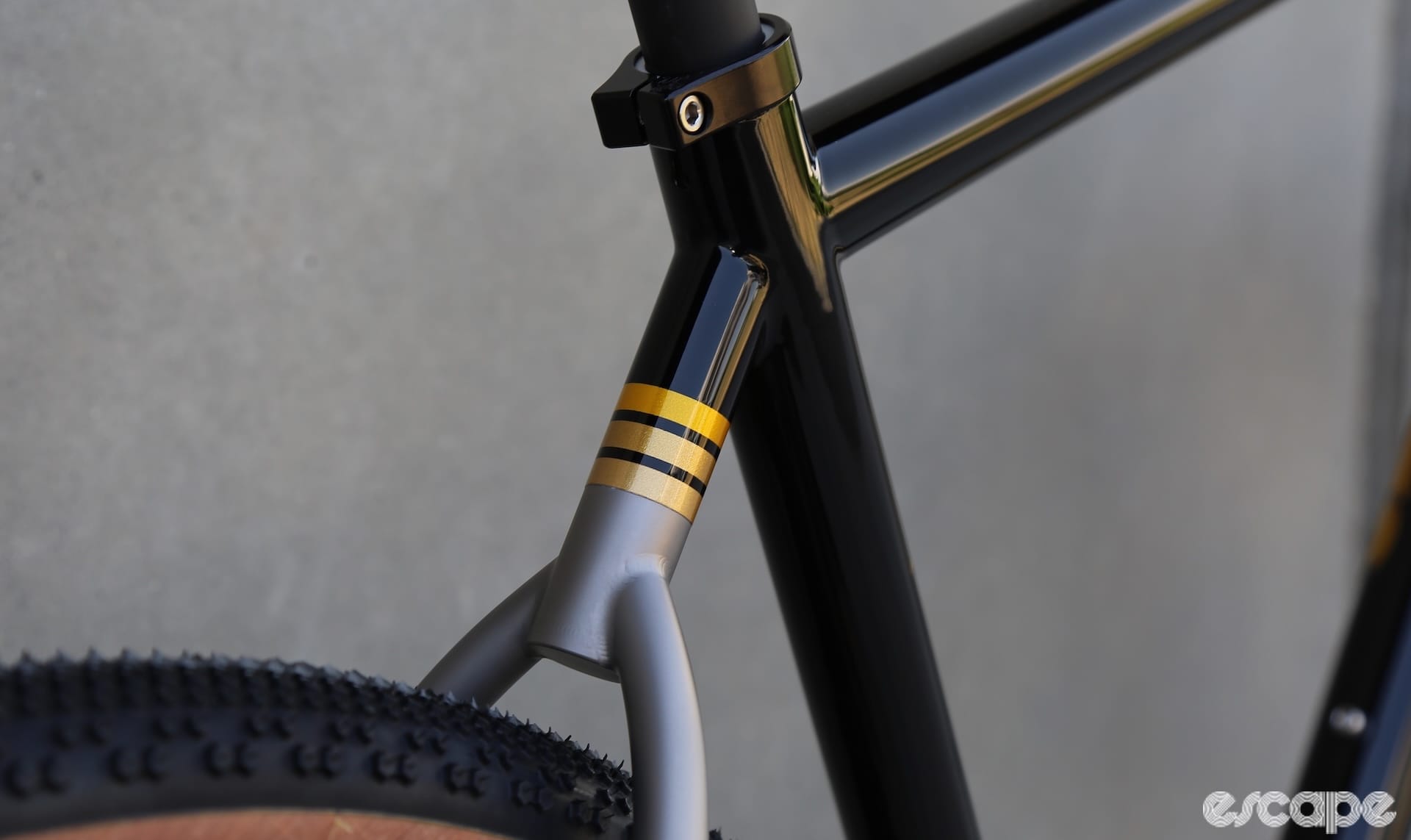

The wishbone seatstay is primarily an aesthetic choice – it comes from the YBB (why be beat) model that integrates a small shock into this frame section, and in earlier times, that frame shape would match the curve of a rim brake. It also allows for seatstay sub-assemblies to be welded independently, then dropped into the fixture as a single unit.
