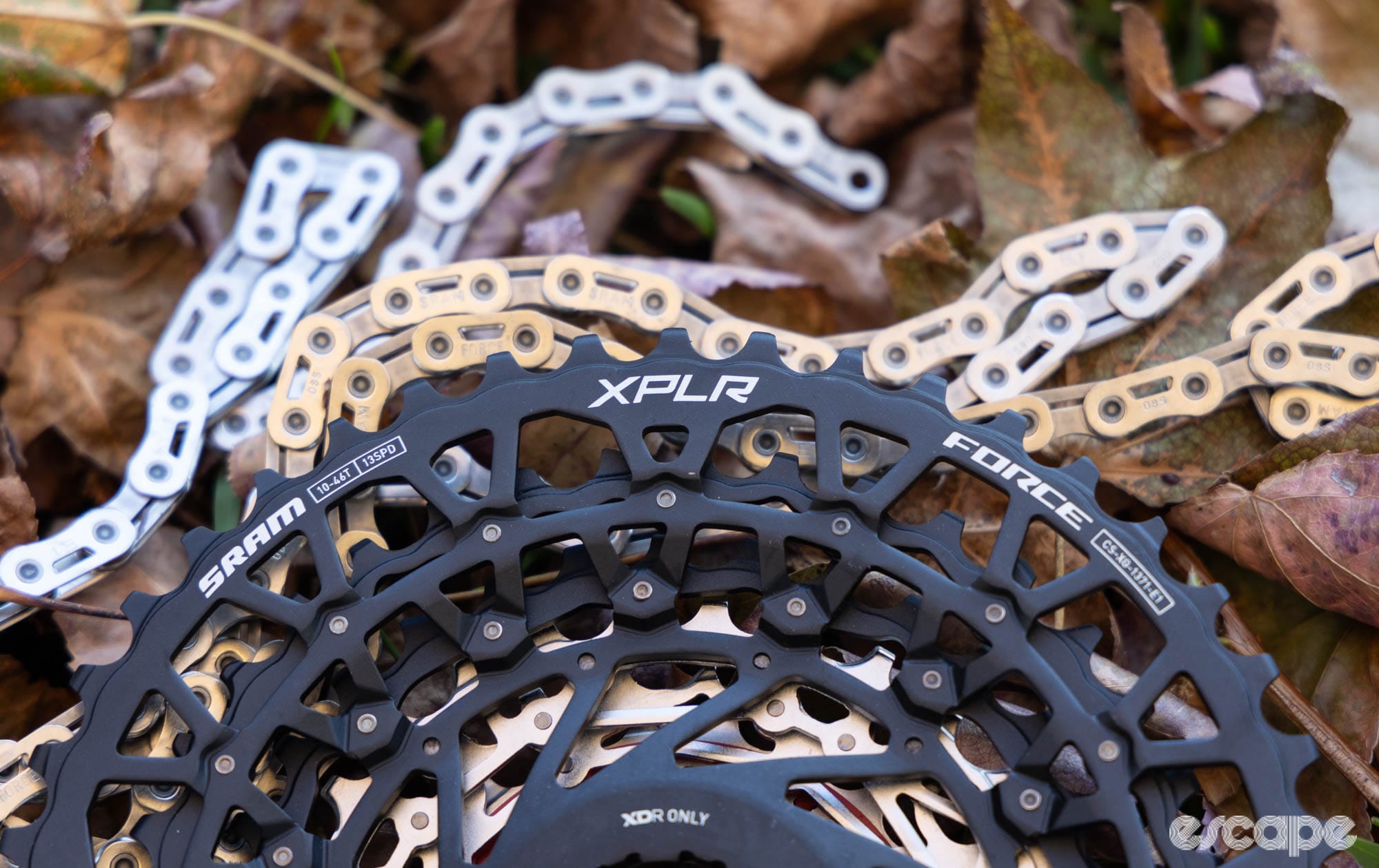

SRAM is still at 12-speed shifting for its road groups, meanwhile, on the gravel side, the new generation (E1) of XPLR introduced a 1x-specific system with a 13-speed cassette in a single 10-46T size (460% range). Of course, the chainring size is still up to the user, and the chain shares the same Flattop compatibility as the 12-speed drivetrains.

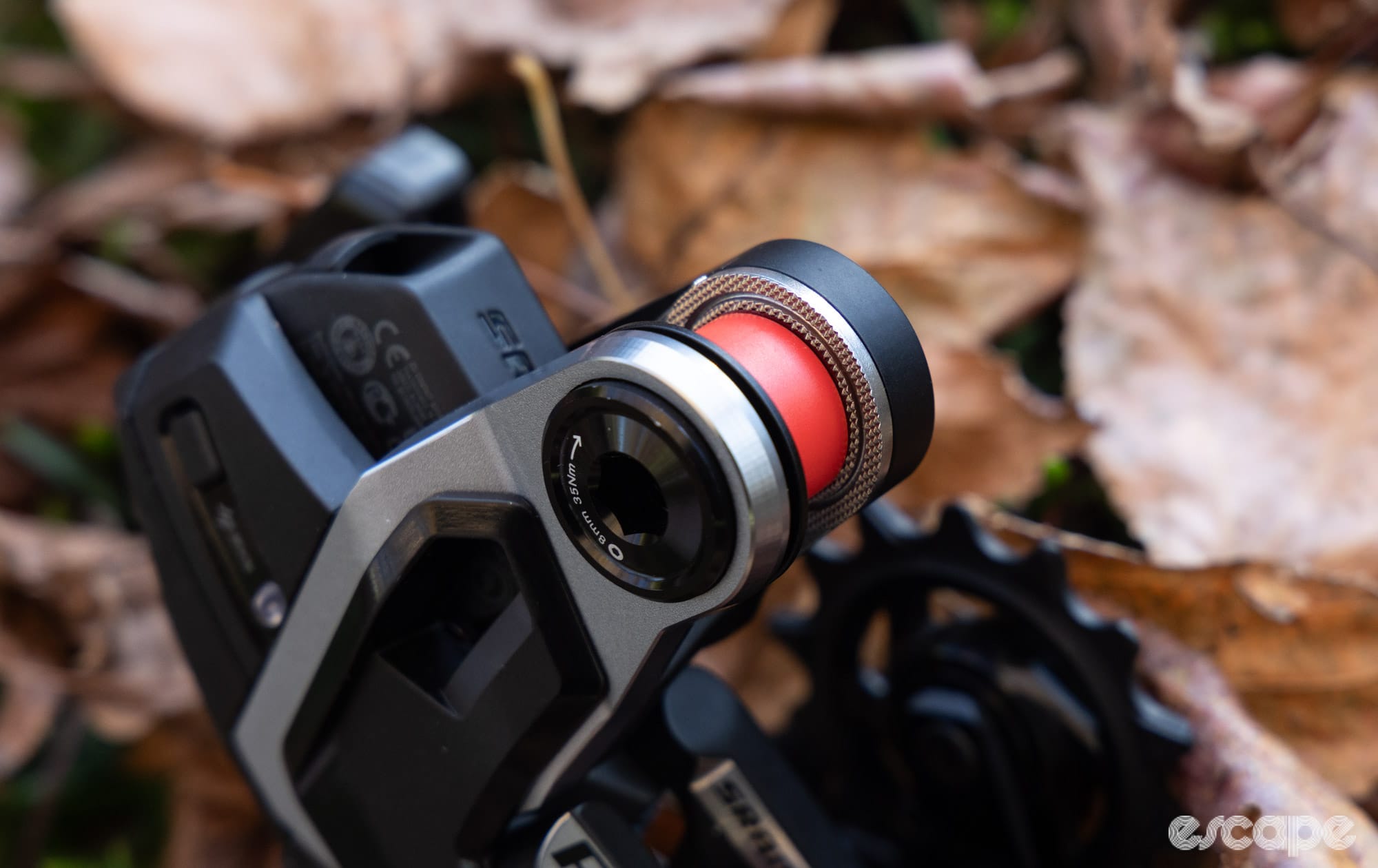

The new XPLR adopts SRAM’s newer Full Mount derailleur concept from its Eagle Transmission mountain bike range. Here, the derailleur only fits newer bikes with Universal Derailleur Hanger (UDH) compatibility, which in terms of gravel bikes is still a relatively short (but fast-growing) list. Here, the Full Mount design takes the place of the derailleur hanger by sandwiching the dropout, with the rear thru-axle bolting directly into it.
The derailleur has a number of clever details, but fundamentally, by SRAM controlling the location and size (10-46T) of the cassette, they’ve been able to produce a system that makes installation a matter of following a few easy steps and with minimal mechanical know-how. Additionally, the design is incredibly robust and highly rebuildable. Meanwhile, the most delicate part, the derailleur cage, can easily be replaced.

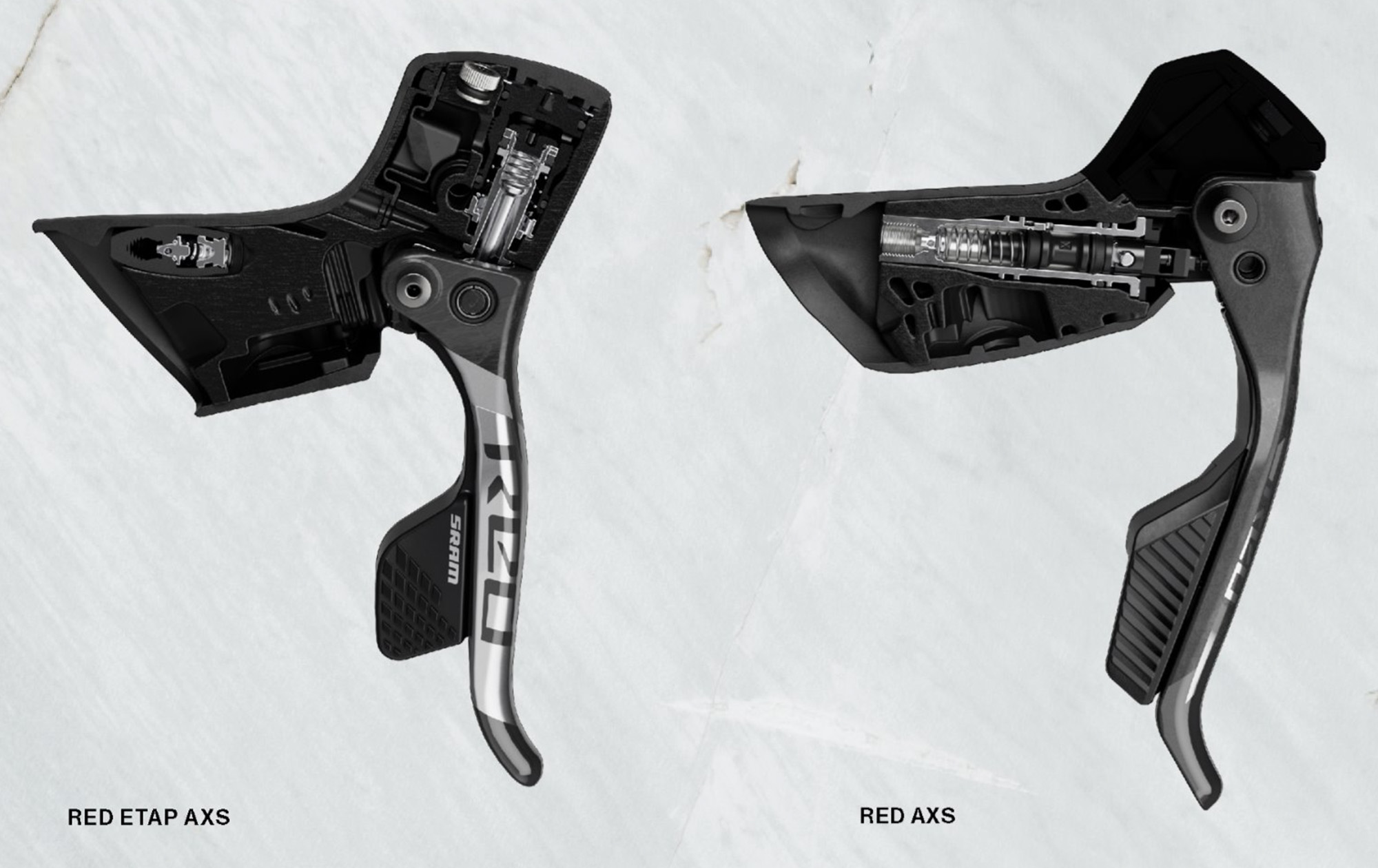

Just as with Red AXS and Red AXS XPLR, the same shifters and brake calipers are shared between 2x road and XPLR systems. This is a big update that sees a complete overhaul to the hood shape and how the hydraulic brakes function. By flipping the orientation of the brake master cylinder to run horizontally through the hood, the brakes are vastly more efficient and lower-effort to operate (by 80% at the hoods, according to SRAM) – it really is a night-and-day difference and was the standout feature when I reviewed Red AXS 2x last year.

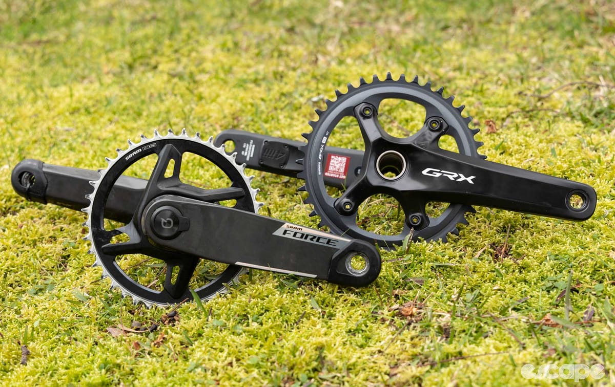

SRAM’s newer XPLR range is based on a crankset that’s wider than its road offerings, something the company dubbed DUB Road Wide (47.5 mm chainline). However, and as covered with Red XPLR, it is possible to set up these gravel groupsets on a UDH-equipped road bike with a narrower 1x road crankset (45 mm chainline).
