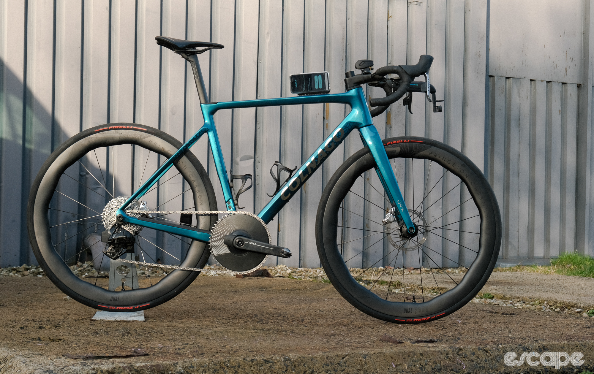

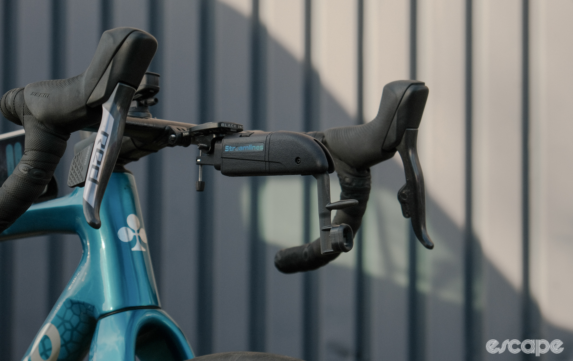

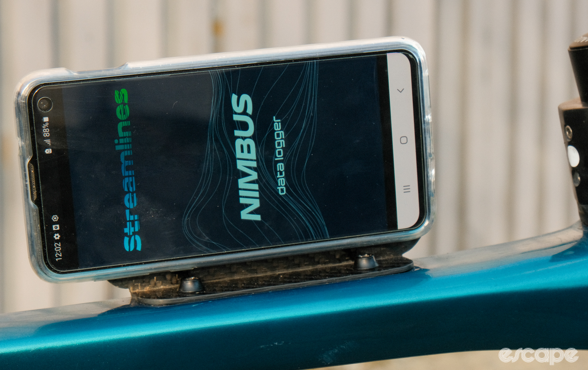

This testing stemmed from a conversation with John Buckley of Streamlines at Eurobike 2024. A previous guest on the Performance Process podcast, Buckley developed the Streamlines Cirrus drag measurement system consisting of a four-port so-called “wind sensor”  named the Altostratos, a body position sensor it calls the Forma, a high-resolution speed sensor named the Tempo, and Nimbus, a dedicated data logger Android app.
This network of sensors captures wind speed, direction, ambient conditions, body position, and elevation with exceptional accuracy, while the separate Cirrus web portal handles all the complex calibrations and calculations automatically. It enables measuring aerodynamic drag (CdA) and rolling resistance (Crr) with high precision in the real world.
While we were well aware of the Streamlines system’s aero testing capabilities, Buckley explained its possibilities for tyre testing in that Eurobike meeting. Not long after Pirelli unveiled a 40 mm version of its P-Zero Race TLR, the new width range this tyre offered suddenly became the closest thing we’ve ever had to study the true effects of tyre width and pressure on performance. Not realising the magnitude of the undertaking, I formulated a plan to test the P-Zero in each of its six sizes (26, 28, 30, 32, 35, 40 mm).
