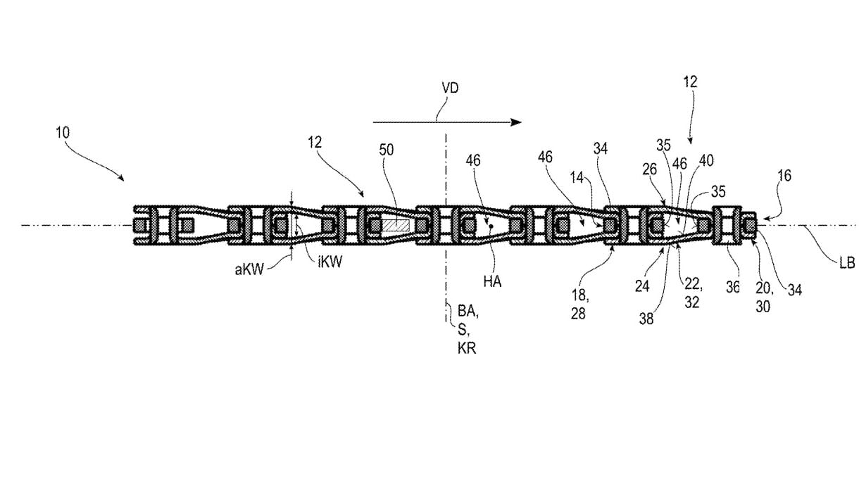

As first spotted by a contributor to Escape Collective, a US patent application from SRAM shows a radically different chain design. It's a departure from the tried and tested profile that has remained fairly consistent since the advent of shifting. Of course, ‘radically different’ is a stretch when it comes to chains, where most innovations are subtle and hard to spot.

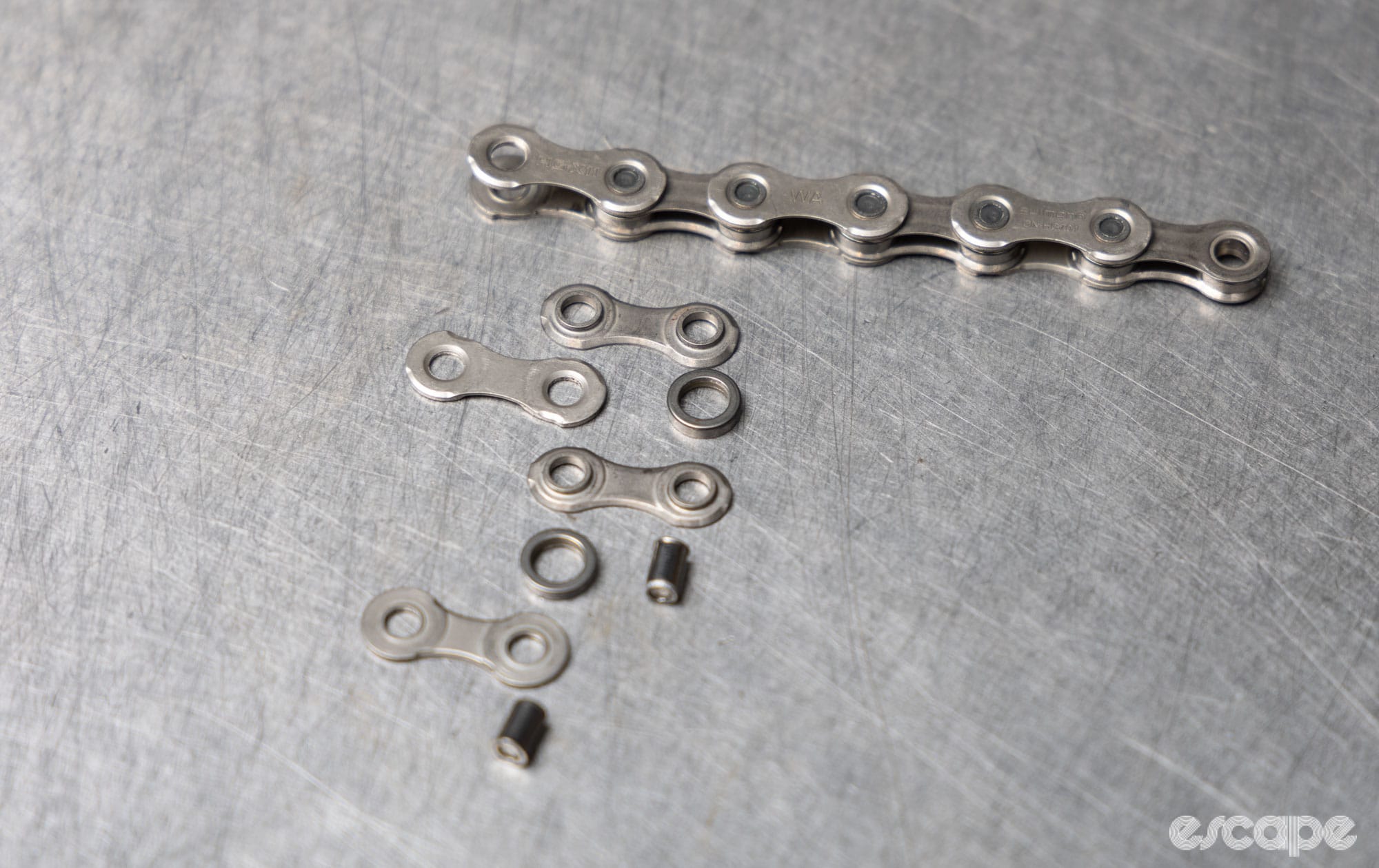

When it comes to chain design, evolution has been slow. Sure, widths have narrowed, finishes have improved, materials have strengthened, and cut-outs have shaved a little weight. Inside the chain, you'll find some more notable differences in how the plates and rollers interface with the central pin (rivet). Still, the latest chains of today continue to have plenty in common with those from decades ago.

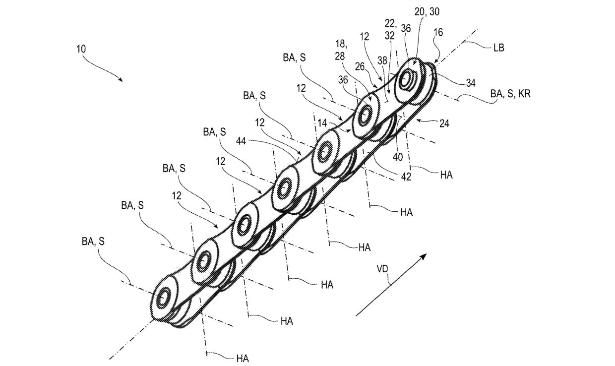

A conventional chain is made of a pin, roller and a set of alternating inner and outer plates. SRAM's patent removes the need for inner and outer plates with the stepped design acting as both.

The drawings included in the patent from SRAM illustrate exactly what this 'stepped' design would look like.
