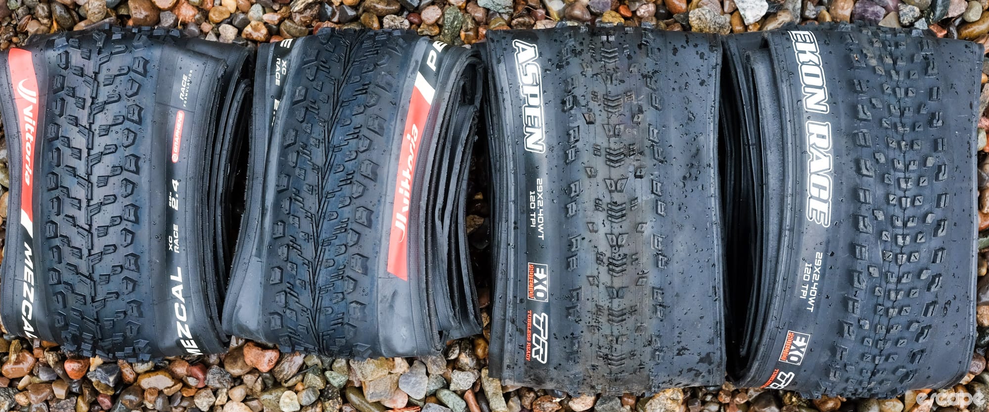

First, some real widths and weights. All measurements taken on a pair of Mavic Crossmax SL wheels with 30 mm internal width, and after the tires had a chance to stretch out (width increased by as much as 3 mm in the case of the Aspen after sitting inflated for 36 hours).
From left to right: Mezcal, Peyote, Aspen, Rekon Race

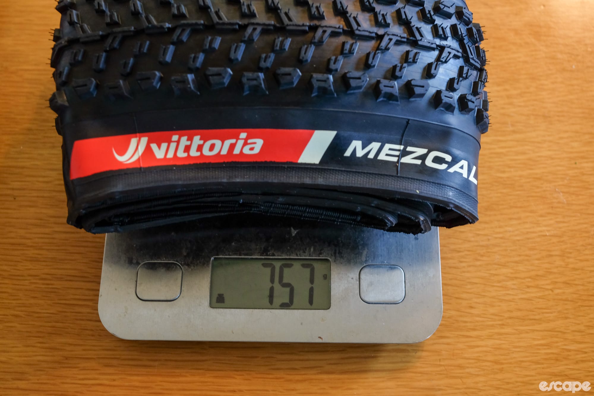

Vittoria Mezcal 2.4 Race
The narrowest of the four but an impressive weight given it also has the largest tread blocks.
Width: 2.34” / 59.37 mm
Weight: 757 g

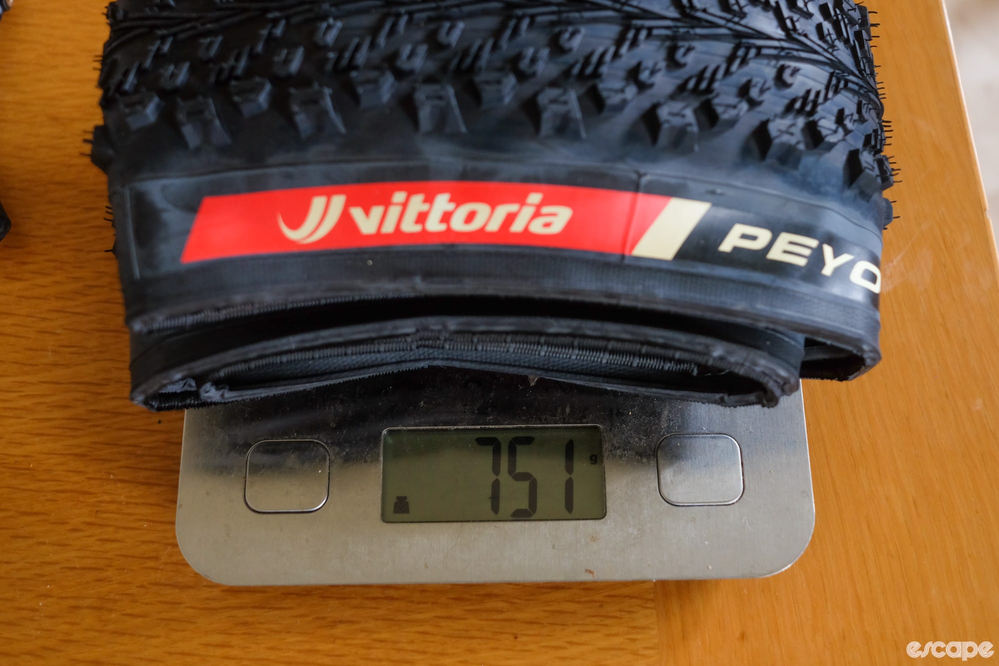

Vittoria Peyote 2.4 Race
Wider, nearly a true 2.4, and a bit lighter than the Mezcal.
Width: 2.38” / 60.40 mm
Weight: 751 g

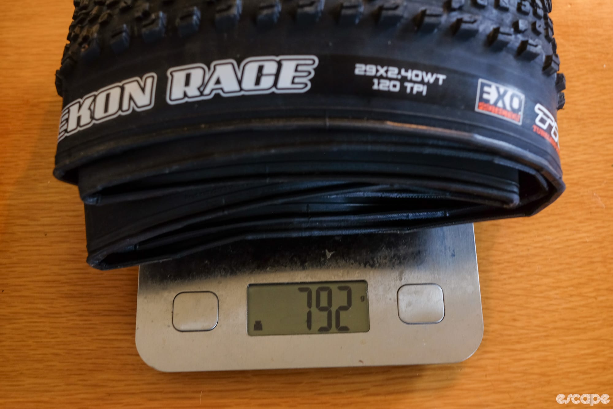

Maxxis Rekon Race 2.4 120 tpi
Heaviest of the four, but not by much.
Width: 2.41” / 61.28 mm
Weight: 792 g

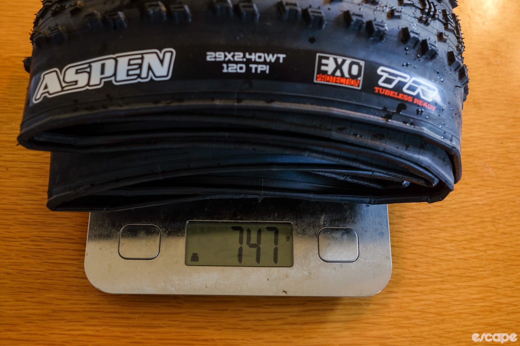

Maxxis Aspen 2.4 120 tpi
Lightest and widest of the four, but only by a few grams. I've weighed a lot of Aspens over the years and, like most tires, they can vary by as much as 15 grams. So in other real world Aspen and Peyote are the same weight.
Width: 2.42" / 61.46 mm
Weight: 747 g

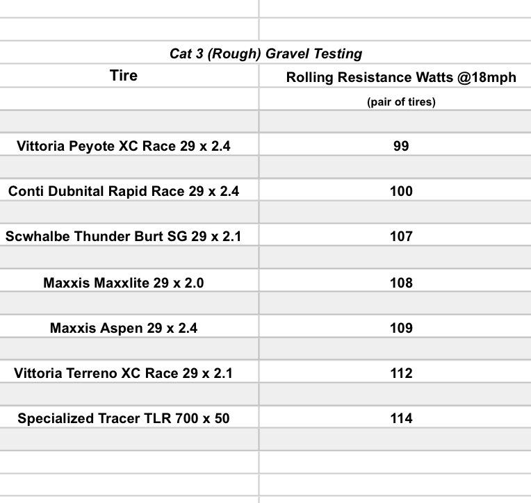

And then the rolling resistance data that initially caught my eye. No rolling resistance testing is perfect, of course, and actual performance will depend massively on the surface you're riding. All I really care about is that both the Aspen and Peyote test pretty fast. Beyond that, I care more about how they actually ride.
John Karrasch's test data; full results viewable here.

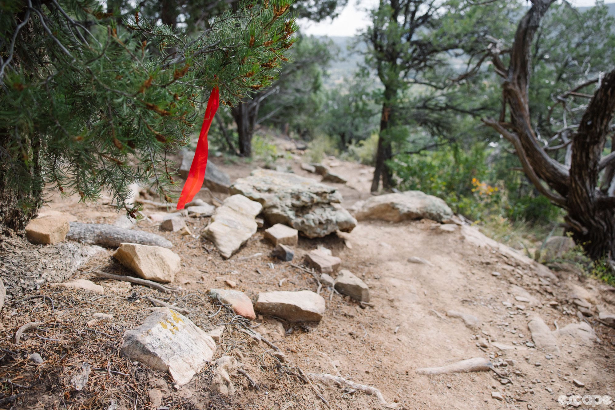

Our local trails are dry with varying levels of loose dust and rocks most of the year. They're rocky, dusty, and baked by the sun. Traction decreases as the summer wears on and things get drier and dustier. In other words, they're exactly the sort of terrain both the Aspen and Peyote are designed to be raced on.
Sample trail, photo taken from a stage of the Durango Derby. Hard dirt, pea gravel, dust, and rocks.
