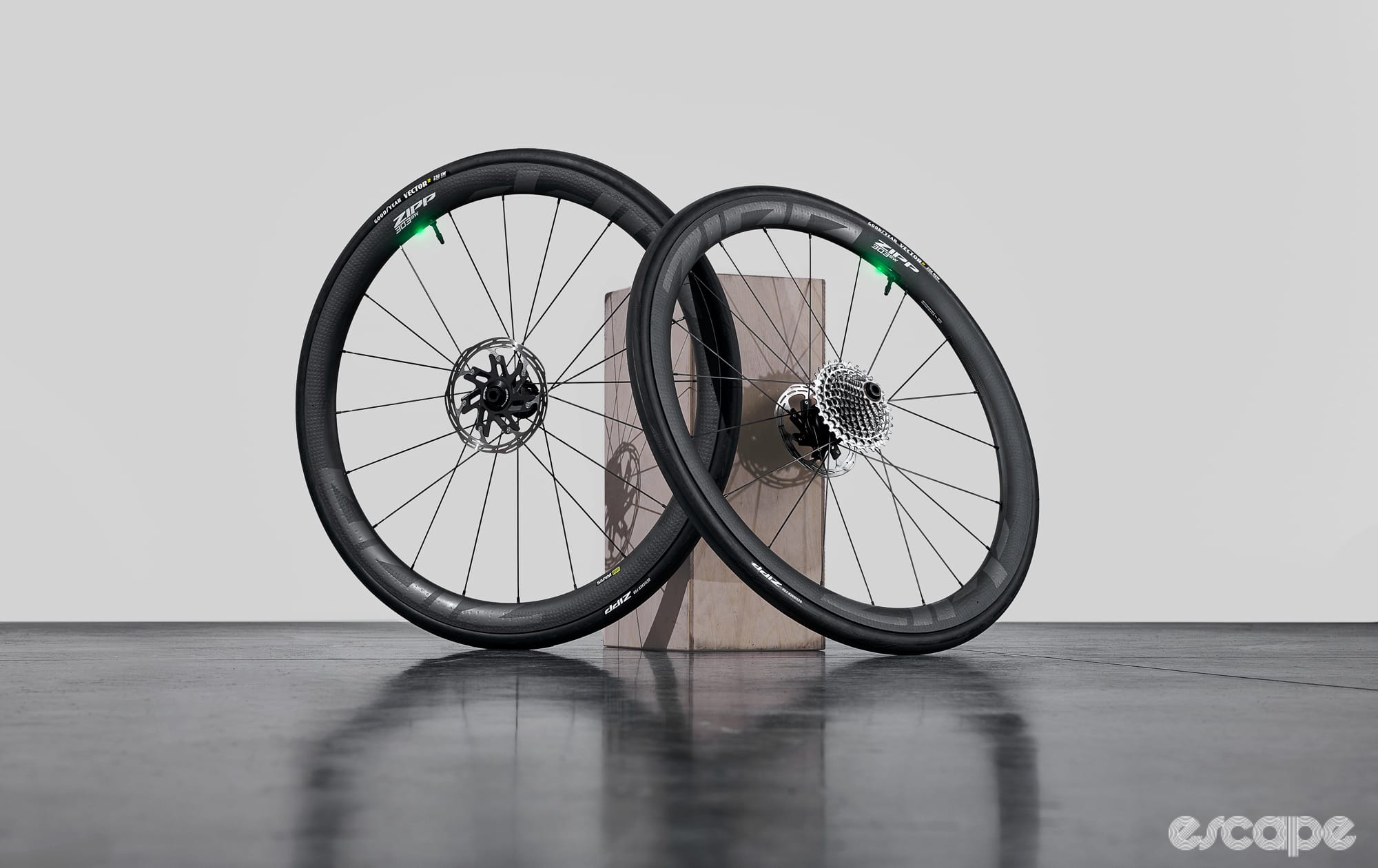

Zipp has overhauled its top-end road range, with major updates to the 353 NSW and the 303 Firecrest, now rebranded as the 303 SW. Rim shapes are mostly the same, but revised carbon layups, a new hub platform and, most notably, the debut of an integrated tyre pressure sensor are all new.

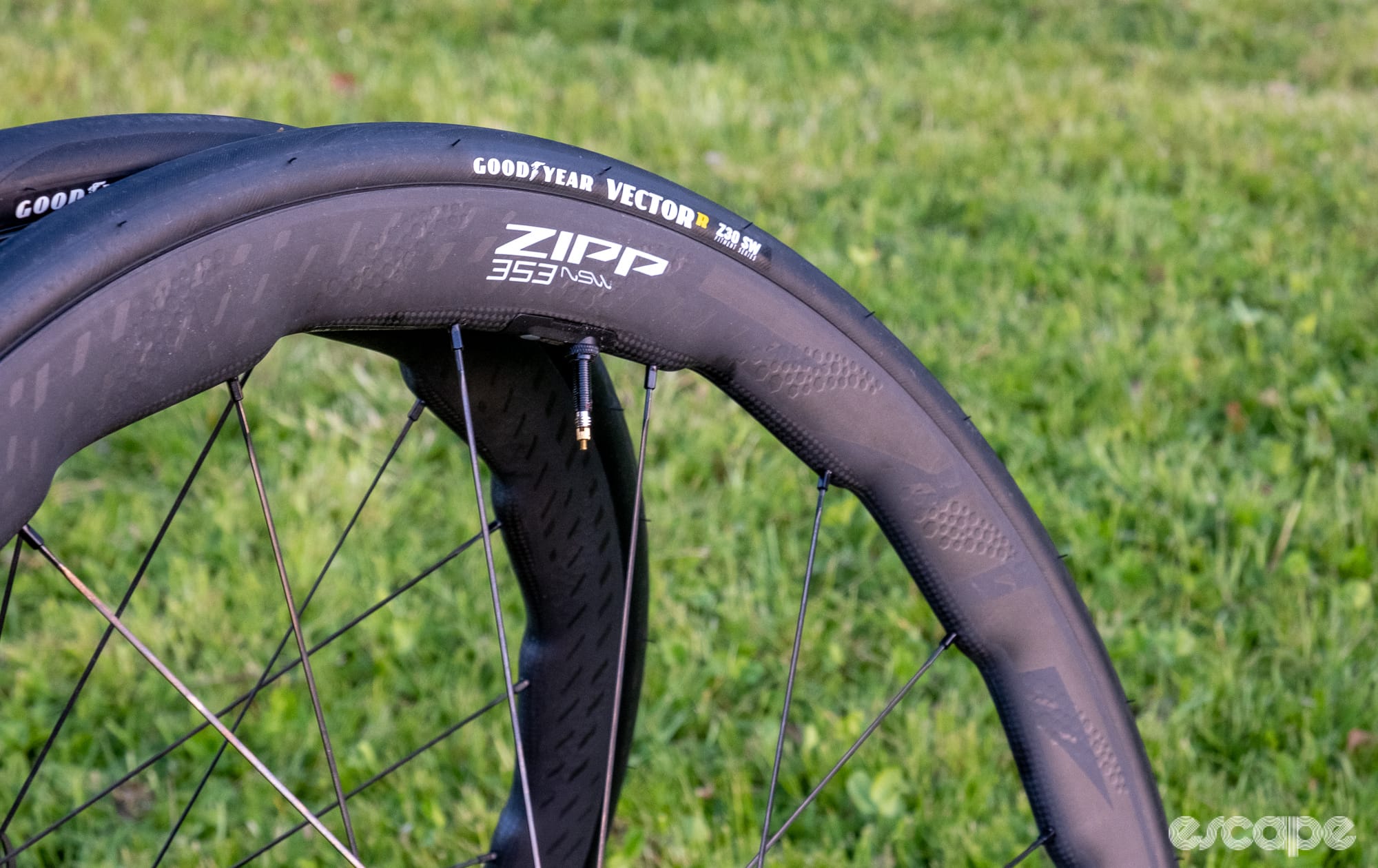

The sensor is the headline act. Embedded directly into the rim, it delivers real-time pressure data to compatible head units and the SRAM AXS app. LED indicators flash green when pressure is within the user-defined range, blink fast red when too high, and slow red when too low. Pressure data is saved to the ride file. The system works tubeless or with a proprietary $45 TPU tube featuring a ported valve. Standard tubes are also compatible, but pressure data is lost.
The new 353 NSW features a shallower 35-40 mm undulating profile (previously 42-46 mm), retains its 25 mm internal width, and claimed weight is practically unchanged at 1,310 g. Zipp claims a 1-watt aero gain when paired with the Goodyear Z30 SW tyre, developed specifically for the wheel and sized to measure 30 mm in use. The carbon layup has been revised for a claimed 16% increase in impact resistance – a point we’ll revisit later in the article.

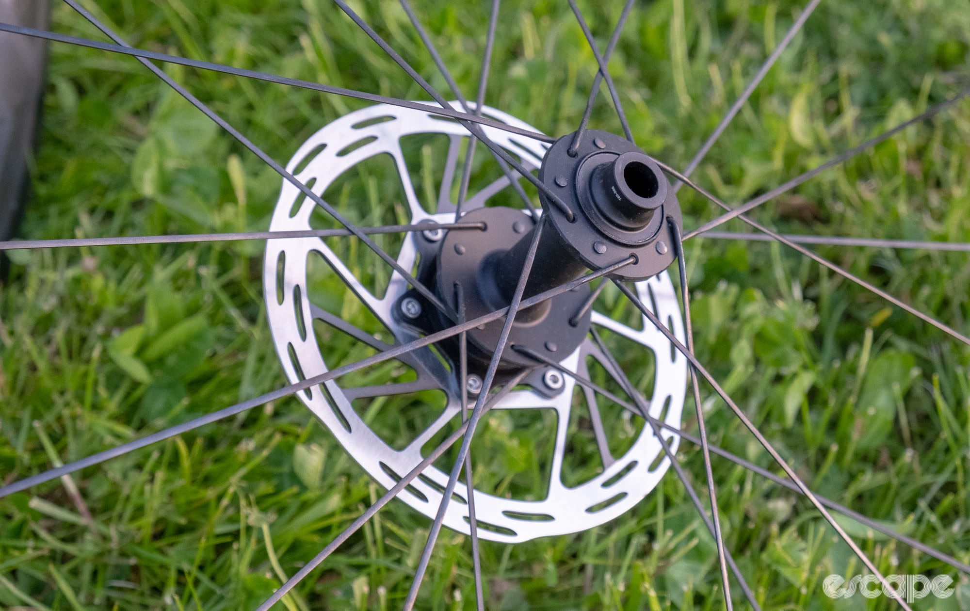

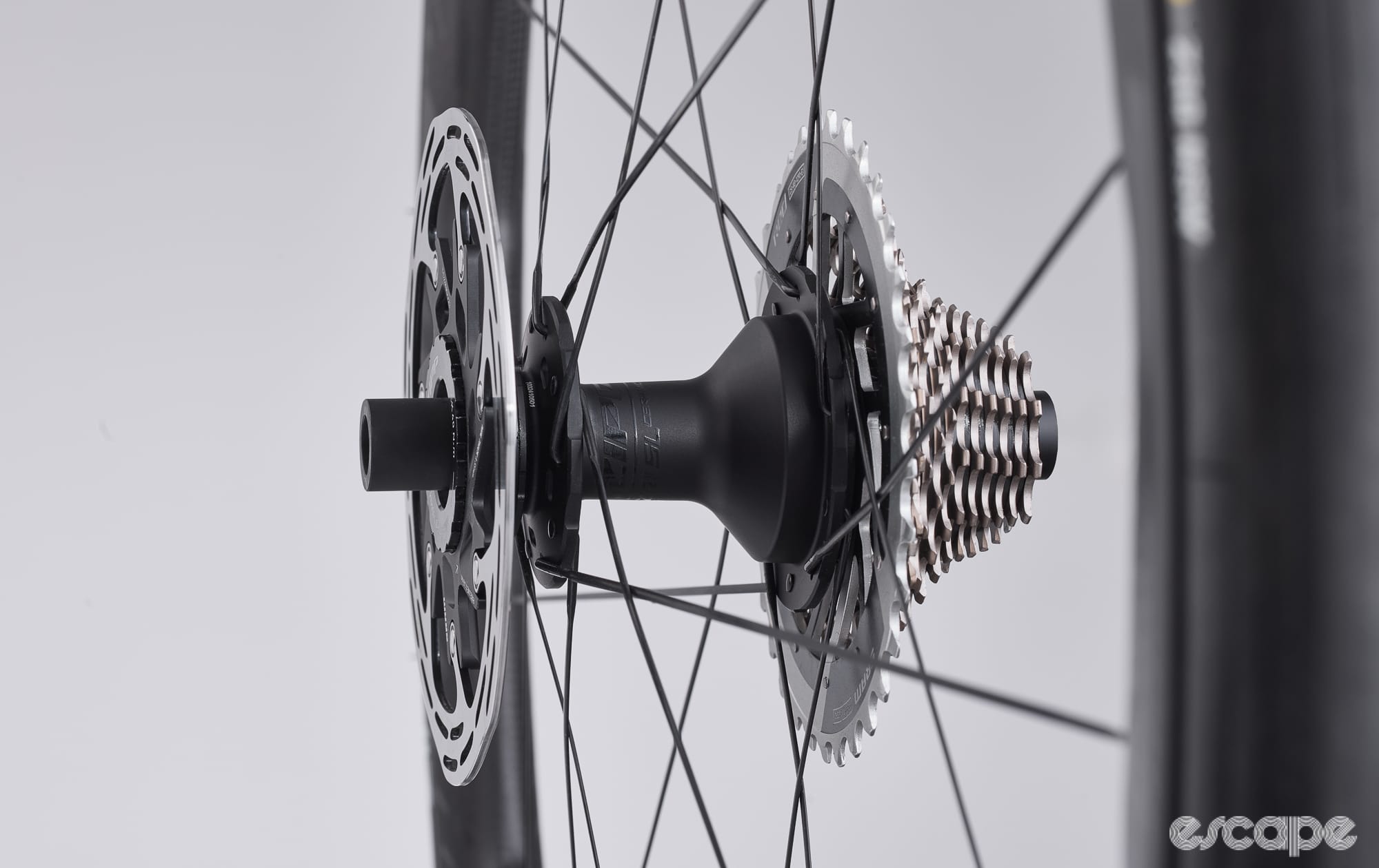

The new ZR1 SL hub replaces the outgoing Cognition system across the NSW range. While Zipp hasn’t commented much on the change, the move away from the Axial Clutch is telling. The new hub is 30 grams lighter, uses ceramic bearings, and features a more conventional pawl-based 66-point engagement (from 6 pawls) for quicker pickup and simpler maintenance. It’s simpler, lighter, and, if it works as promised, it’s a good deal more user-friendly.

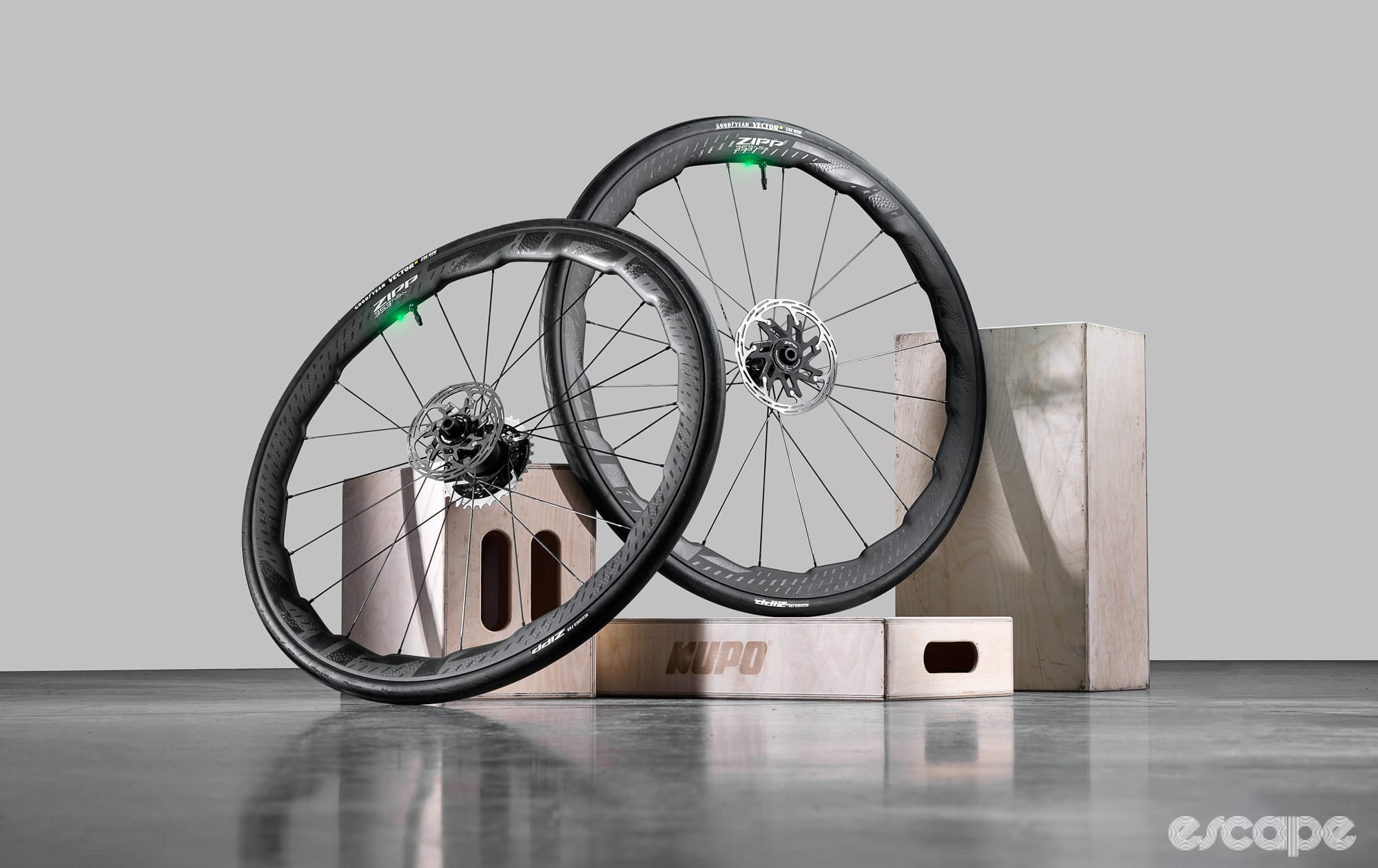

Two additional Fitment Series tyres join the lineup: the Eagle F1 R Z29 Aero, designed for the 23 mm internal width of the 404 and 454 NSW, and the Vector R XPLR, a 40 mm all-road tyre for the 303 XPLR. While Zipp touts aero gains, the focus is on precise fit and true sizing for their wider hookless rims.
Lastly, while the 454 NSW and 858 NSW rims remain unchanged, they now come with the new lighter ZR1 SL hubs. Pressure sensors are not included – Zipp says they’d require a full rim redesign.
