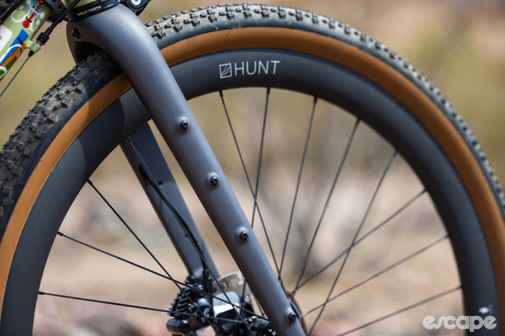

Five years in the making, the M.U.D. fork (Multi Utility Design) fills a sweet spot in OEM or aftermarket offerings: a standard-ish 400 mm axle-to-crown measurement (395 in this case) with sleek design, accommodates a tire up to 29 x 2.25” wide, and packed with mounting and routing options.

Highs: Elegant aesthetics and profile with a stock paint finish that is unique yet congruent. Geometry offers a balanced ride quality when loaded and not. Modern tire fitment for both race and recreational use cases. Feature-packed at a competitive price and weight.
Lows: Fixed rake position limits bike compatibility without impacting geometry. Max native rotor compatibility of 160 mm. Limited two-year manufacturer warranty (most comparable products have a five-year warranty).

- Max tire size: 29 x 2.25”
- Axle-to-crown height (A-t-C): 395 mm
- Rake: 55 mm
- Mounts: 3-pack blade mounts, fender mounts, crown light mount
- Brake compatibility: Flat mount for 140-160 mm rotors
- Routing: Internal brake and dynamo routing, plus through steerer for dynamo charging devices
- Actual weight: 610 g with uncut (long!) 400 mm steerer and all hardware, including axle; 550 g for fork alone without hardware and uncut steerer; 490 g with cut steerer (258 mm)
