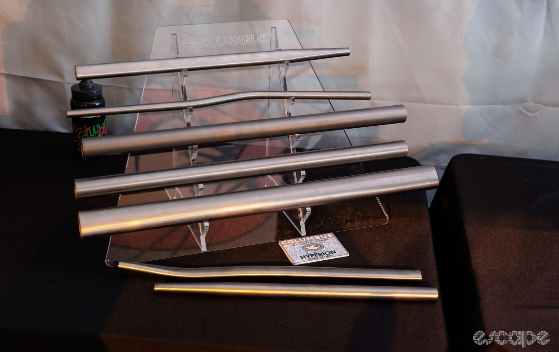

Columbus is making a comeback to offering titanium tubes. The Italian company's Hyperion tubesets aim to provide more choice to custom framebuilders.
