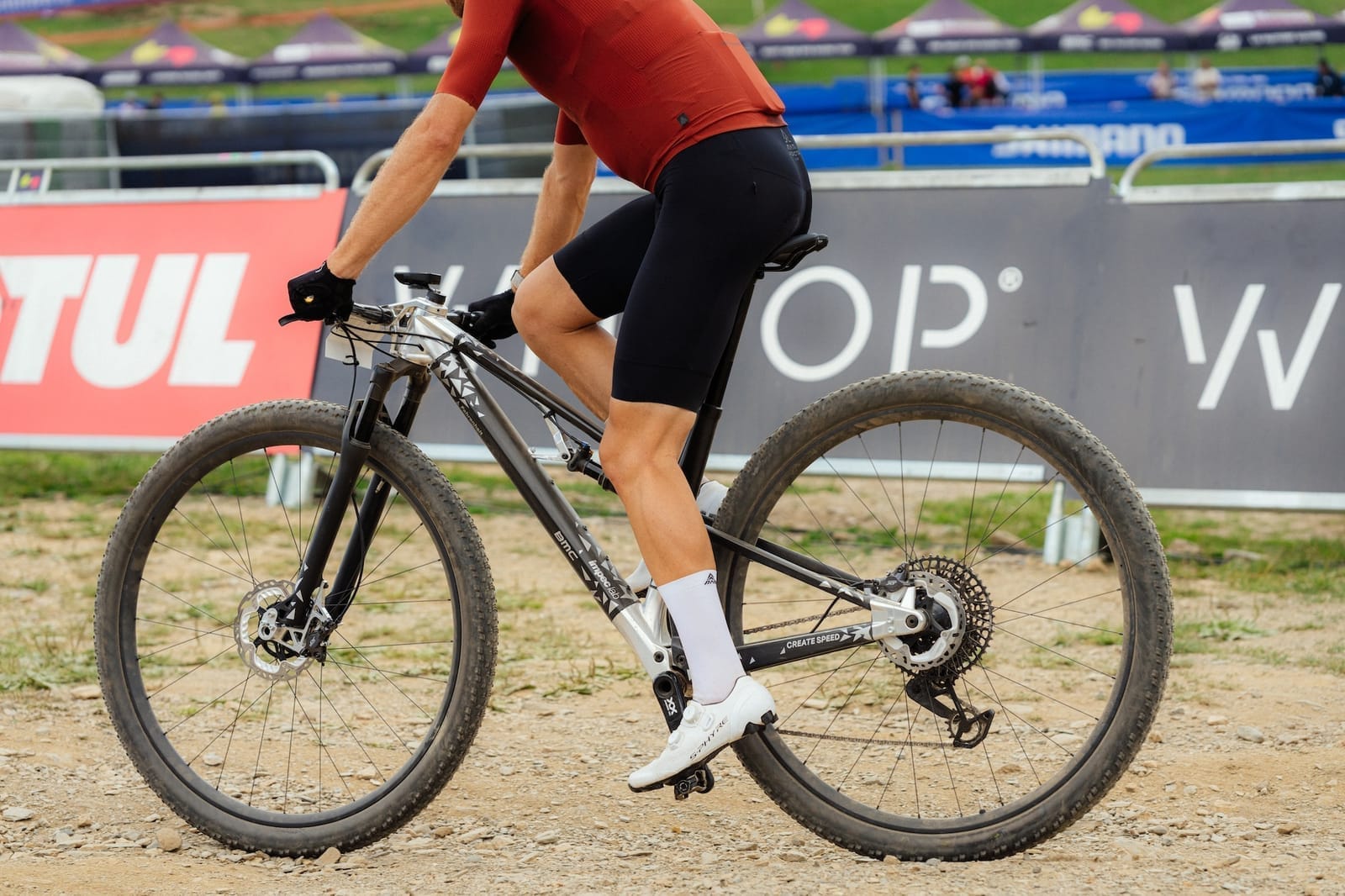

The idea has already appeared in the wild at races multiple times. BMC’s prototype cross-country bike was rolled out at the Andorran round of the XC World Cup last year, KTM debuted a 32" hardtail at Lenzerheide, and most recently, Stroll claimed a stage win at the Cape Epic with its 32” prototype. And this isn’t something reserved for the pros. As the explosion of products – a complete tyre line from Maxxis, new forks from Fox and others, and a plethora of frames – at the recent Sea Otter Classic shows, momentum is rapidly building.
BMC was the first mainstream brand to tease the new wheel size back at the Andorra round of the XC World Cup last year.

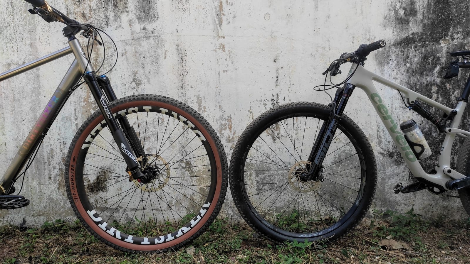

The jump from 26 to 29 inches unified standards across road and mountain bikes, reshaped geometry, and ultimately altered the off-road riding experience. Moving from 29 to 32 inches, however, is far from a guaranteed continuation of that arc. The reality is that 32" is a departure from long-standing norms, demanding a structural rethink of the wheel system, whole-bike geometry, and even how to transport the new generation of big-wheeled bikes. All of this comes with an added cost, too. As Manuel Berschandy, a product line manager at Mavic, put it, “It’s not just taking the recipe of what we know today for 29 and making the same for 32. We need to rethink everything.”
Sure, the wheel gets bigger, but this calls into question just about every other element of the wheel, frame, and associated components design. From hub width to rim profile, spoke patterns, and even bearing placement, all have to be reconsidered.
