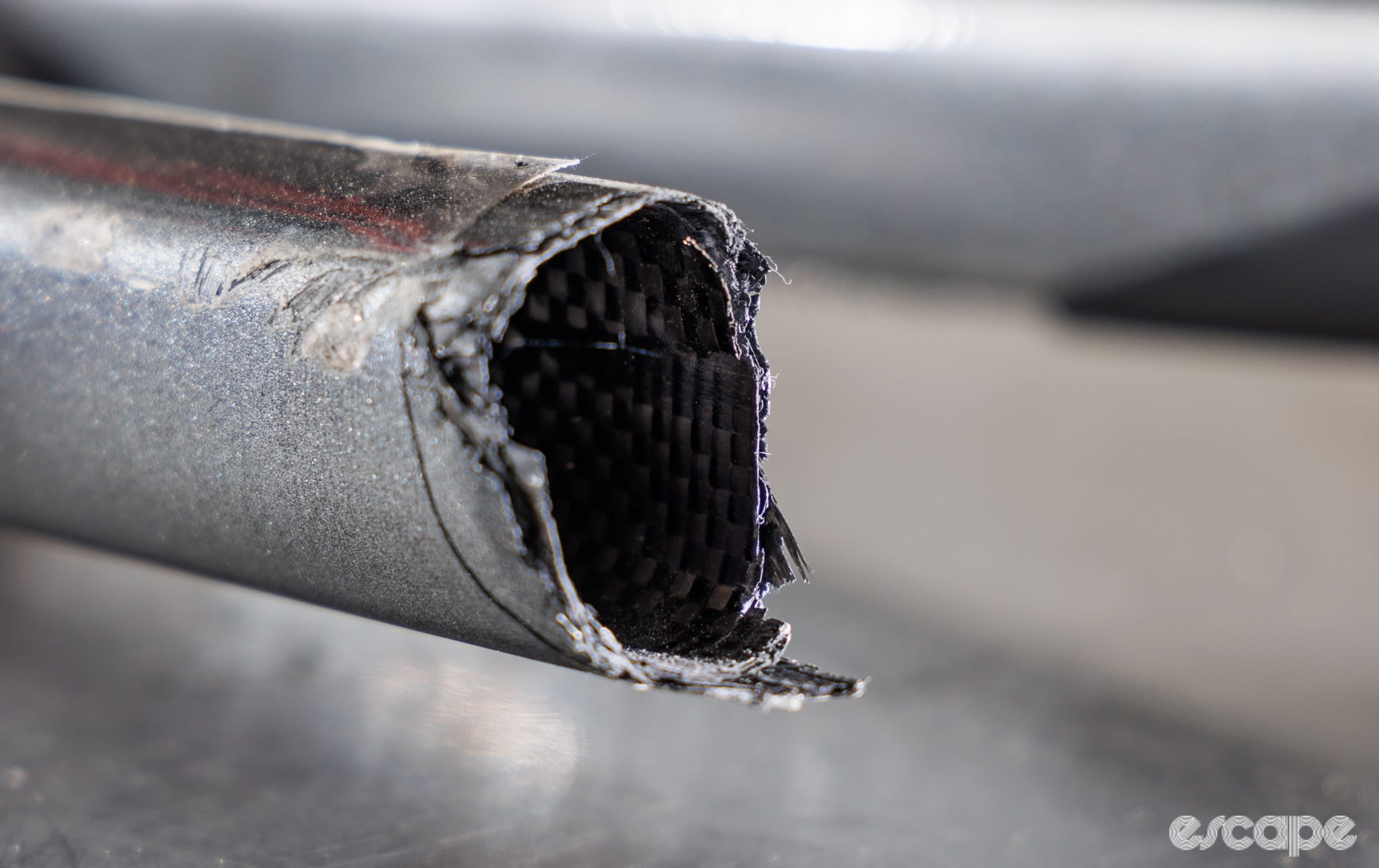

In the context of bicycles, carbon fibre reinforced plastic (CFRP) is a material that combines carbon fibres with a polymer to give it structure. Cutting it correctly is different from how you would attack a metal tube. The fibre-based and directional nature of this material means care is needed to ensure you don’t accidentally cause the carbon fibres to split or fray from the polymer, something commonly known as delamination. Furthermore, carbon fibre has poor heat dispersion properties meaning it can quickly overheat and dull tools in use.

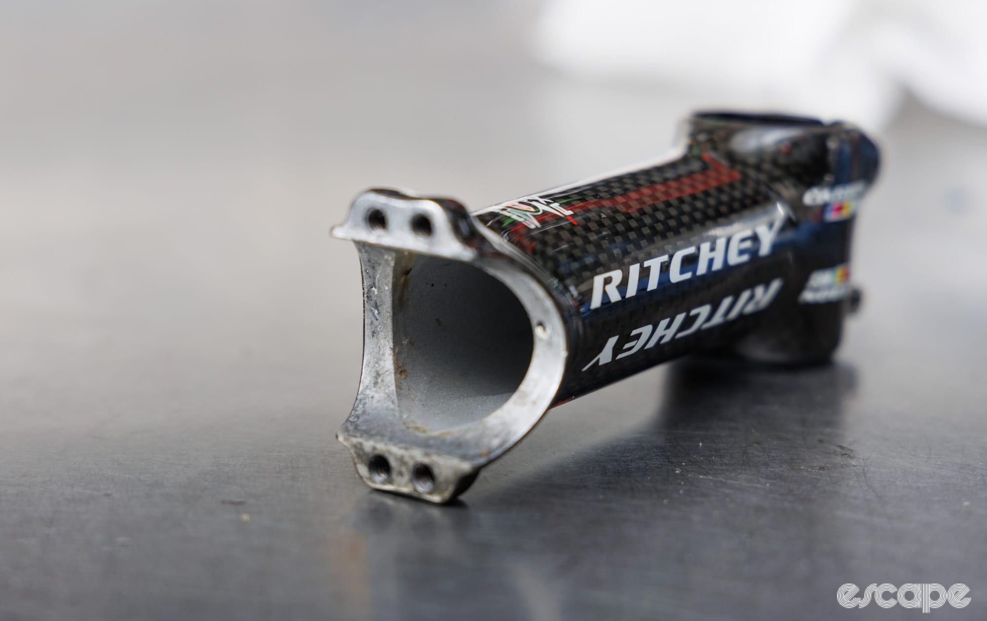

In cycling, you'll most commonly find CFRP used in hollow structures. Add in thin structural walls, and each layer can be critical to the function of the part. Meanwhile, carbon-wrapped components (such as the stem on the right) remain a thing, although they are increasingly rare.
