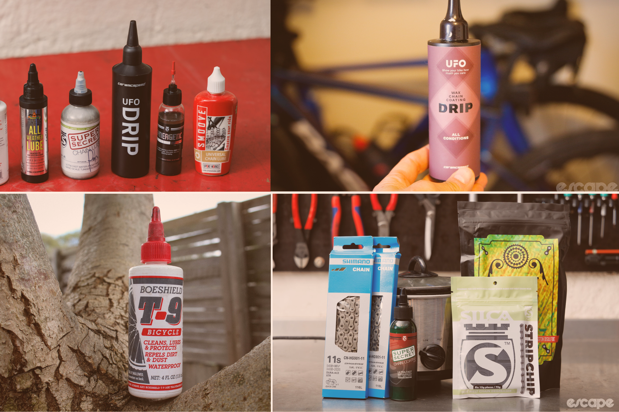

Escape Collective Favourites: Chain lube
