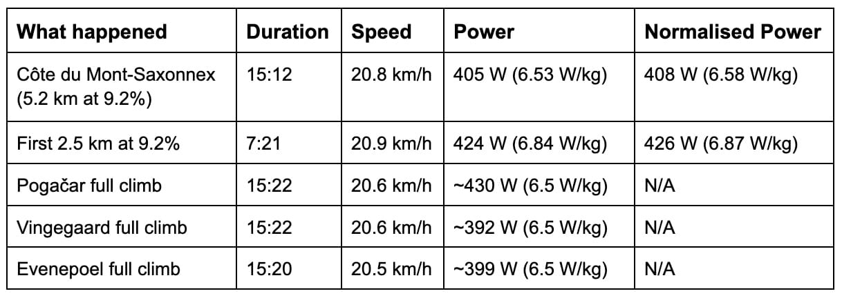

Stage 6 was a very short stage at only 126.7 km. For the stage winner, Pogačar, this was dealt with in under three hours, even if there were 2,600 meters of elevation gain to contend with. Visma-Lease a Bike set an infernal pace on the penultimate climb of the day, the first category Côte du Mont-Saxonnex (5.5 km at 8.6%), before a long false-flat valley section to the base of the final climb.
Although not huge, the lead group on the road was large enough for leaders to shelter from the wind and keep fresh before the final climb of the day.
While the race profile split the final ascent into two discrete climbs – the Côte de Domancy (2.5 km at 9.4%) and the Côte de la Cry (2.7 km at 7.6%), divided by a less-steep middle section – it all blended into one 20-minute threshold effort.
The pace was immediately hot from the start. Johannessen stuck with the Pogačar/Vinegaard group for the first two minutes before settling into his rhythm and pacing himself perfectly for the rest of the climb to finish seventh on the day.

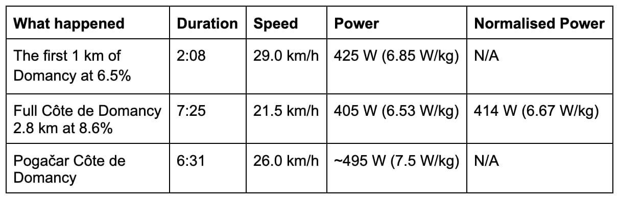

The first part of the climb, the Côte de Domancy, was the location of Pogačar’s brutal attack. Coming into the base of the climb, the pace was high, and as Johannessen’s data shows, hitting the climb did little to slow things down. Considering that around 9 kilometres remained of the climb, it took a 6.85 w/kg effort to hang on.
