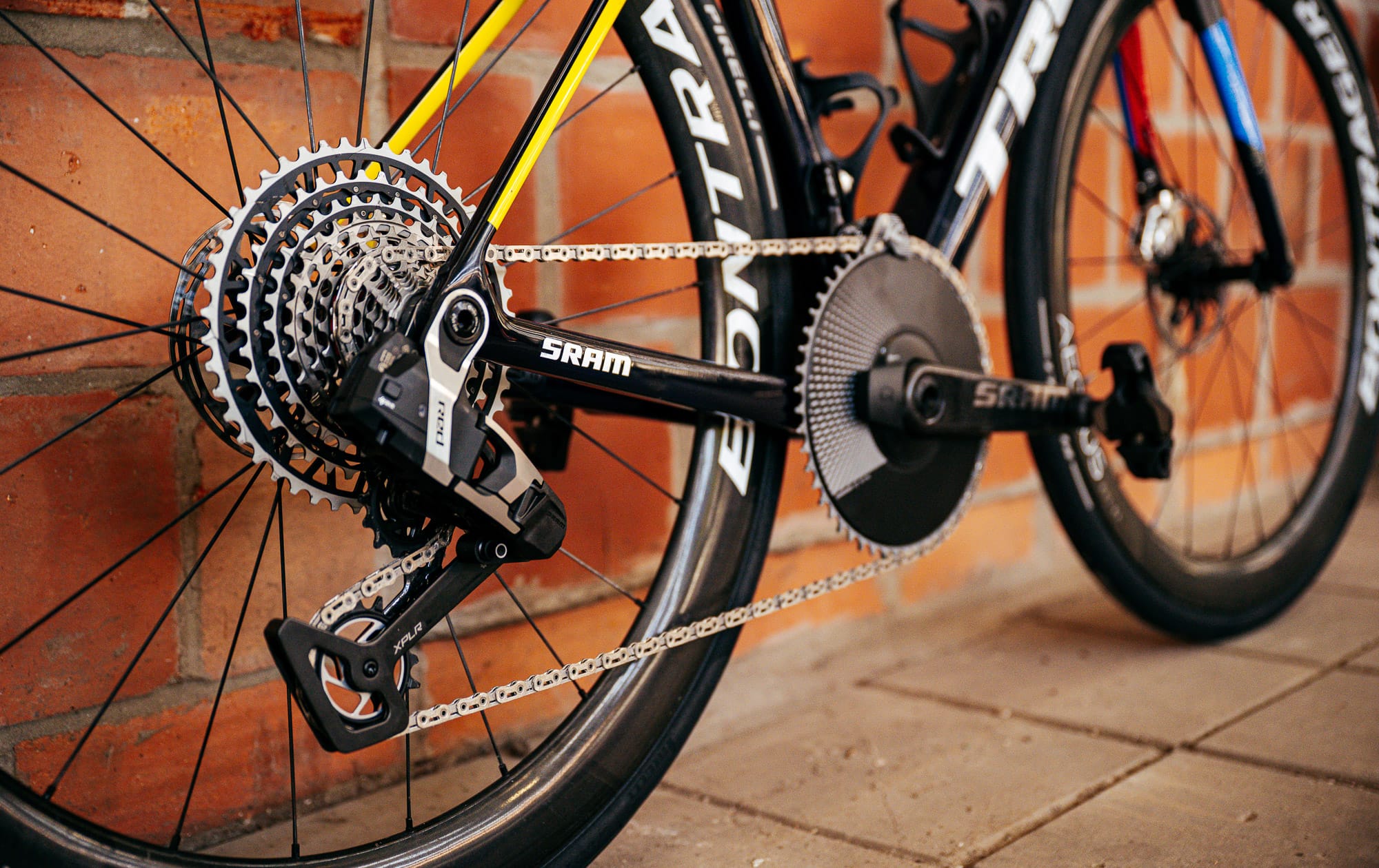

In another blow to SRAM, the restriction would also effectively end experimentation with 1x drivetrains. Last spring, Lidl-Trek's Mads Pedersen won Gent-Wevelgem and finished second at the Tour of Flanders riding a 54T chainring and a wide range 10-46T cassette, which would be disallowed if gear restrictions come into permanent use.
Are we missing the point of Lidl-Trek’s 1X experiment?
Forget marginal gains; the SRAM Red XPLR setup is all about reliability.
