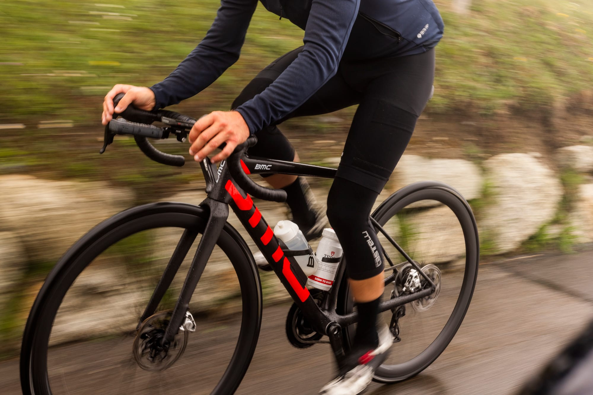

Good stuff: It is a pinpoint-accurate bike on descents. The front end encourages you to get off the brakes earlier and hold more speed, especially through higher-speed corners. The SLR 01 is comfortable and forgiving, making it more appealing for those outside of the peloton than the firmer ride of the Teammachine R.

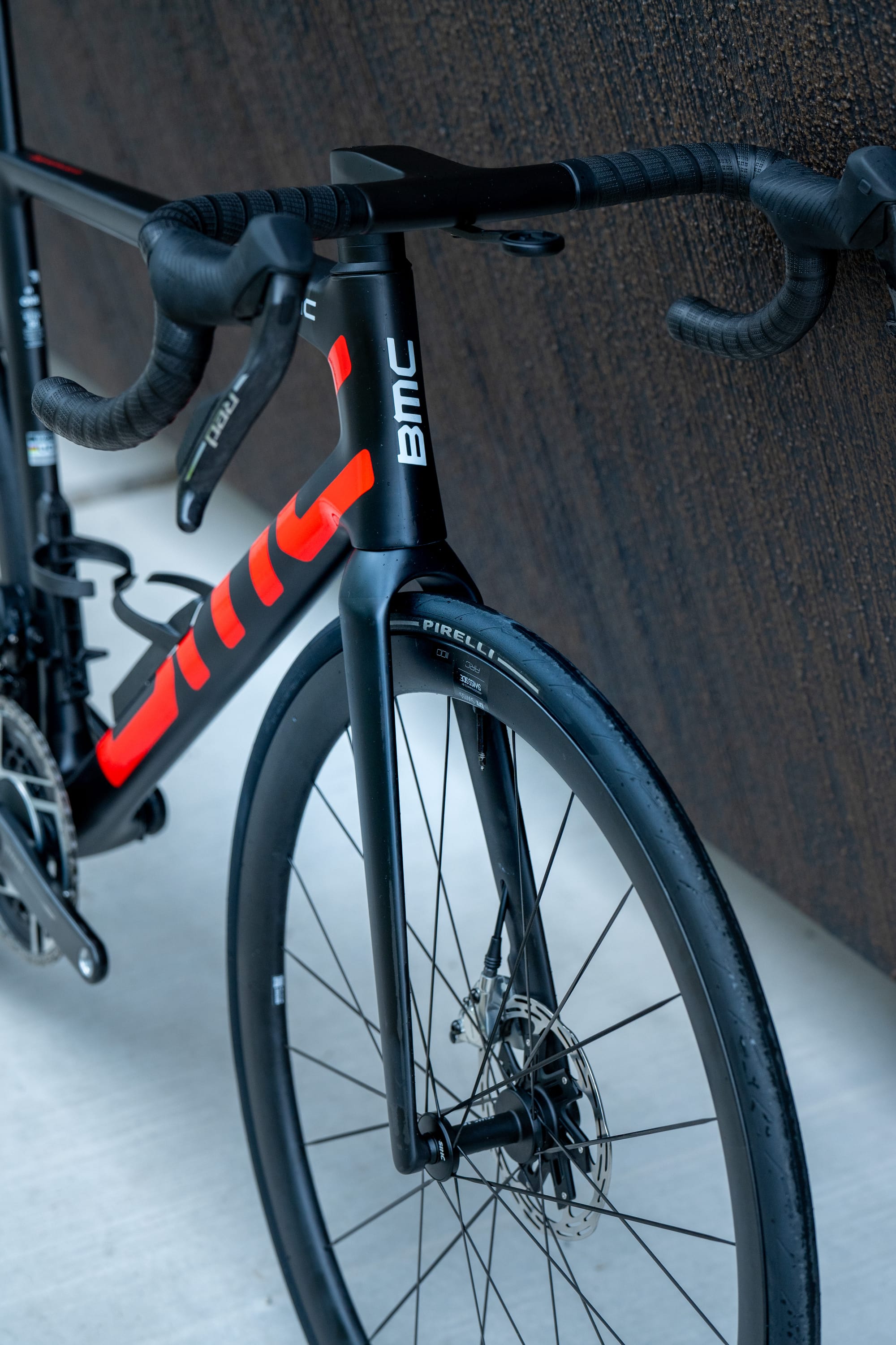

At first glance, the new Teammachine SLR 01 looks much like its predecessor – refined, not reinvented. Subtle design tweaks like a narrower fork, a more sculpted head tube, and a slimmed top tube junction improve aerodynamics and shave weight. The bold graphics disguise a reworked chassis beneath the surface.

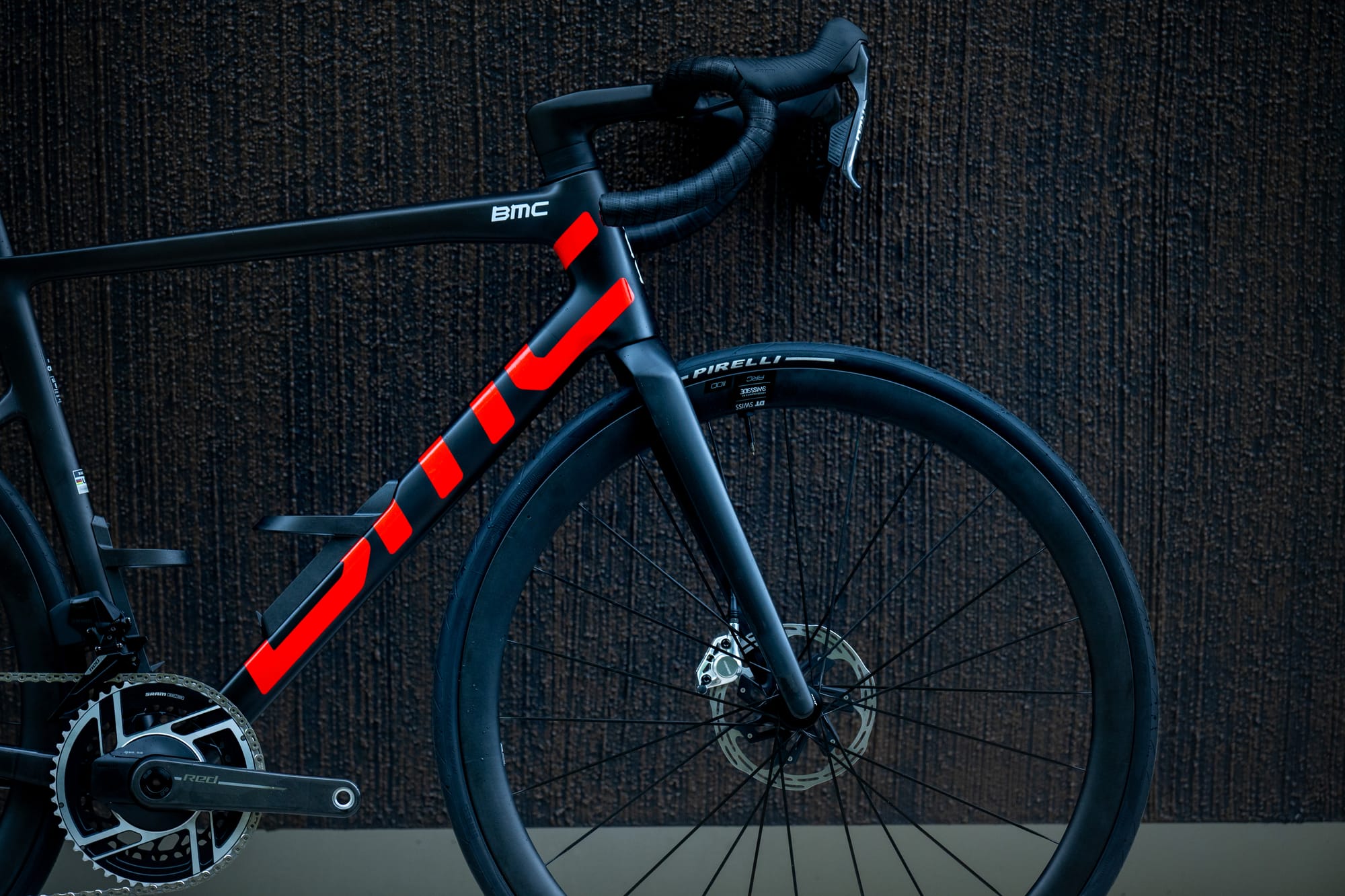

The new BMC down tube graphic has gown so big, it is barely legible.

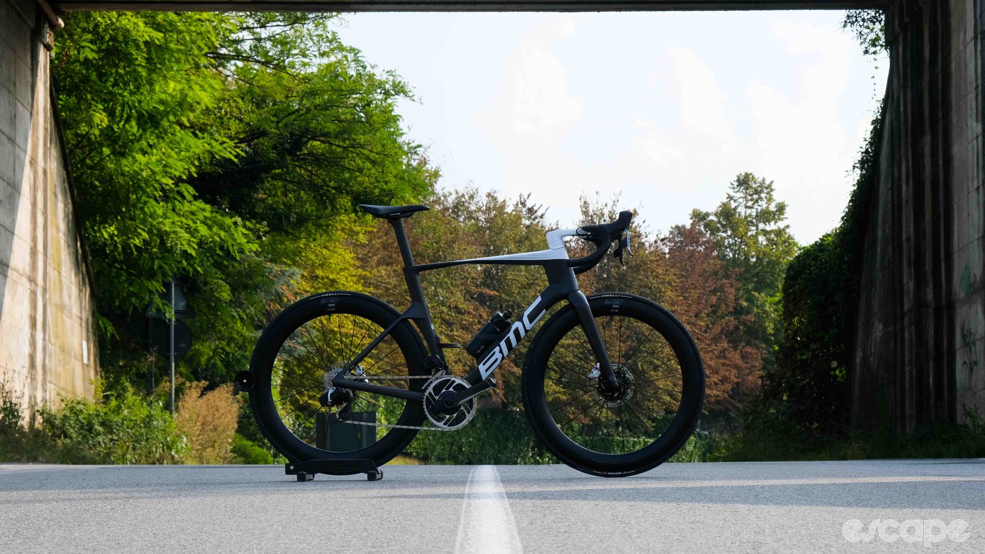

The big headline is weight. Compared to the previous SLR 01, BMC’s engineers have managed to shed 16% of the chassis mass. That’s 222 grams trimmed across the frame, fork, and seatpost. Stack it up against the Teammachine R, and the SLR is now 287 grams lighter, bringing the total chassis weight to a claimed 1,173 grams in a size 54 cm.
Most of those gains came from targeted redesigns around the PF86 bottom bracket (yep, it’s still that) and fork, slimming down high-mass areas without sacrificing stiffness. It’s not the lightest on the market; bikes like the Scott Addict RC and Specialized Aethos fight for that crown, each around 60 grams lighter than the SLR 01.
