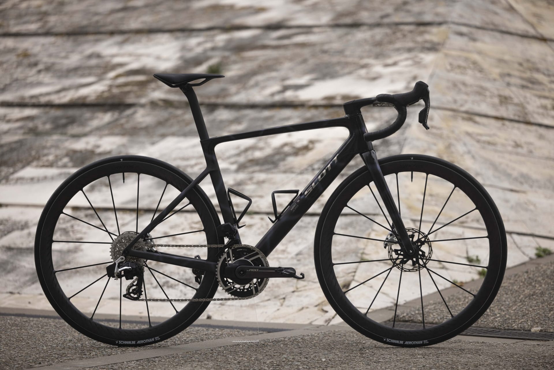

As aero as the old Foil and with geometry designed around wide tyres, the new Addict looks to be more than just a featherweight climber’s bike.

The headline pushed by Scott at the bike’s press launch in Girona was that the Addict RC Ultimate is the lightest production road bike on the market. The top-spec Ultimate model tips the scales at a remarkably feathery 5.9 kg for a size medium. This weight is even more impressive when you find that it is fitted with 28 mm tyres, deep-section wheels, and a nod to aerodynamic design. As is increasingly common with even ultralight bikes, the Addict isn't purely one-note, as Scott claims it's as slippery in the wind as the previous-generation Foil aero road bike.

There are five models in the Addict RC range. Four of the models (RC30, RC20, RC10 and RC Pro) all use the same HMX carbon fibre chassis with the frame weighing a claimed 650 grams for a medium frame size and 295 grams for the fork. This is a 172- and 49-gram saving, respectively, over the previous-generation Addict RC. This brings the HMX frame 35 grams under the claimed weight of Specialized’s S-Works Tarmac SL8. However, this quoted frame weight from Scott was for an unpainted frame with the finished frame with paint around 40-50 grams heavier than this for the Ultimate and around 70 grams for the colourways on the Pro and below models.
The RC Ultimate steps things up using the brand's higher-modulus HMX-SL carbon fibre layup. The Ultimate framesets are also manufactured in a separate facility that uses a new construction process that helps facilitate the further reduction in chassis weight. Part of this new process allows for the membrane used in the fork’s construction to now be removed. Until now the tight and intricate internal profile of the fork meant that the membrane was left in situ. This process saves just a handful of grams, but on a bike like this every gram that can be saved is a move closer to the 5.9 kg target.
 The Ultimate frame comes in at 599 grams with a fork weighing 270 grams. This is a 161- and 54-gram saving over the outgoing RC Ultimate. For reference, Specialized claims that the S-Works Aethos frame comes in 14 grams lighter at 585 grams.
