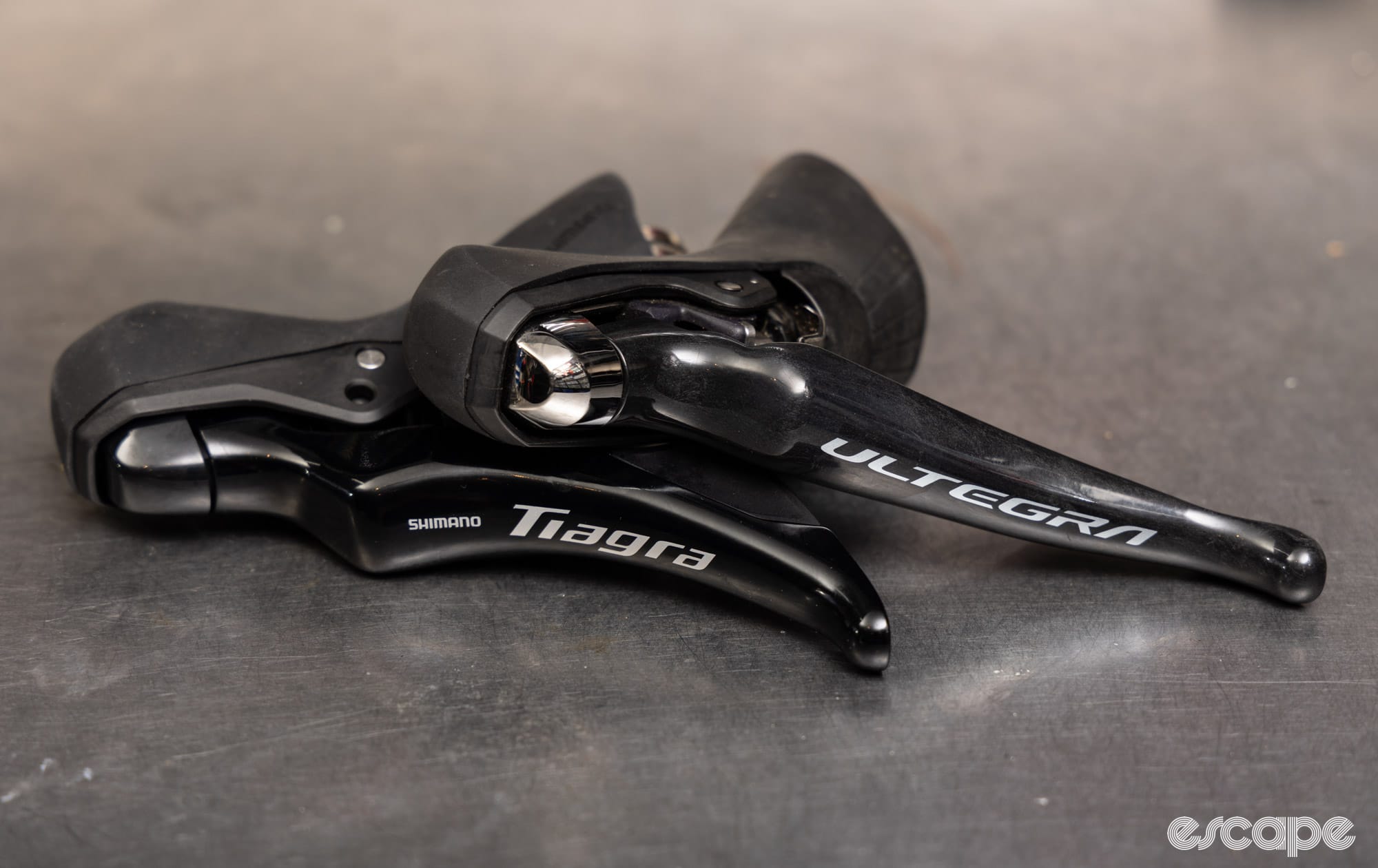

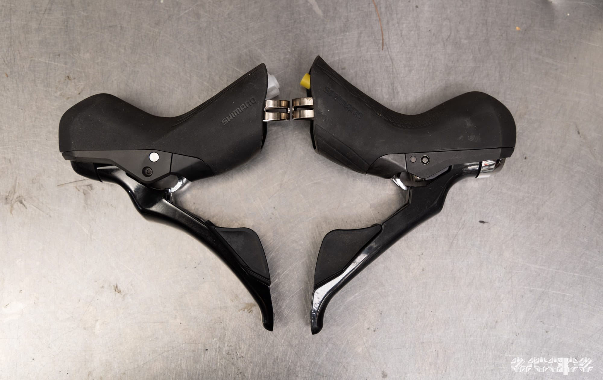

Those new levers look and feel exceptionally similar to the mechanical-shifting and hydraulic-braking 105 R7020 and Ultegra R8020 before them, which is to say they don’t feel like a budget product. The scales also suggest as much, with the new R4020 levers weighing almost exactly the same as R8020s at 289 grams each. Compared to those Ultegra levers, the new R4020 have a subtly narrower profile.
New Tiagra R4020 against Ultegra R8020.

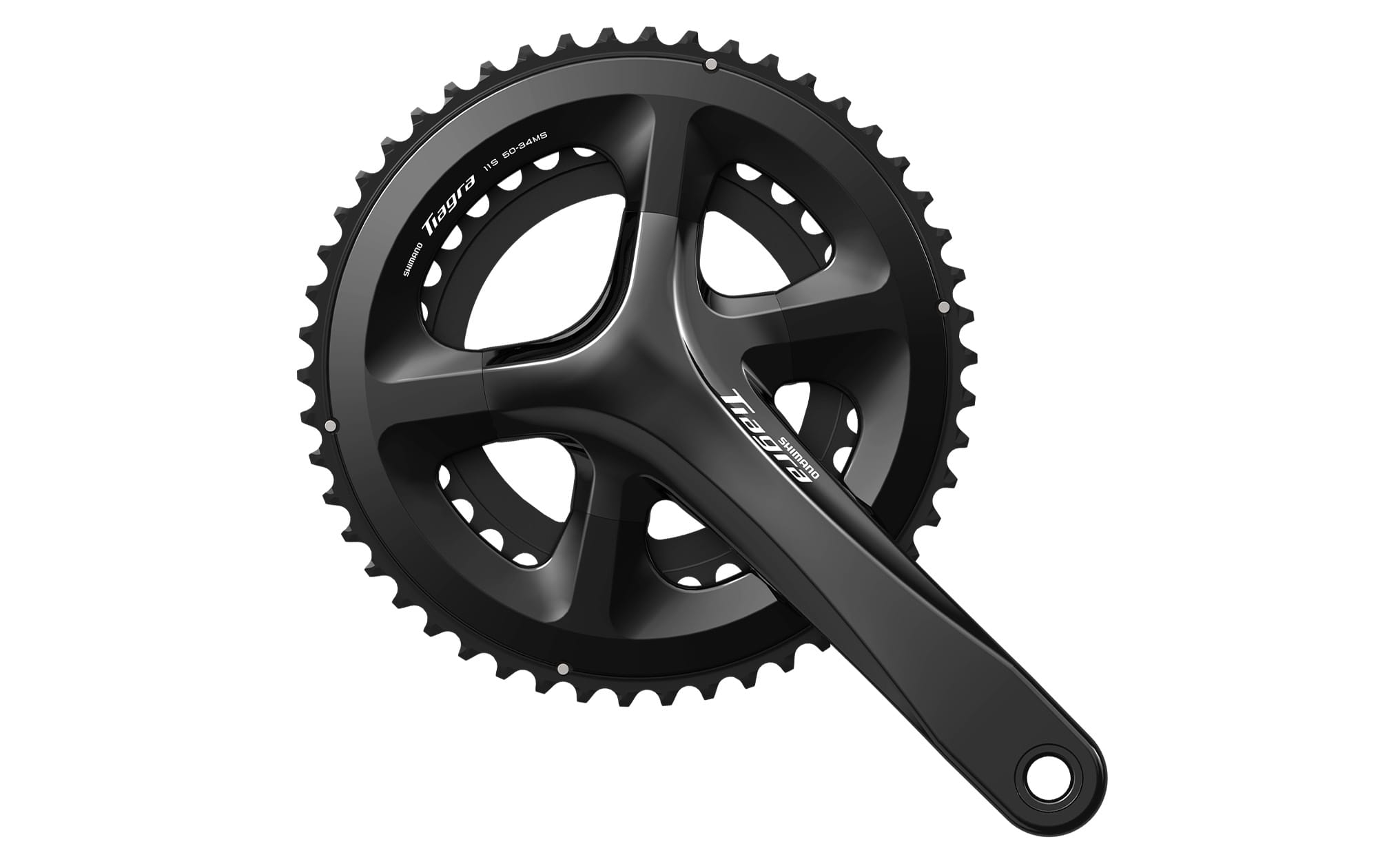

Up front is a familiar-looking crankset that’s available in 50/34T or 52/36T. Crank lengths are 165, 170, 172.5, and 175 mm. And shifting those chainrings is a compact toggle-style front derailleur (95 g, braze-on version) like what we’ve seen with previous mechanical 105/Ultegra/Dura-Ace.
The new 11-36T cassette. Meanwhile, the crankset looks much like the previous R4700 version.
