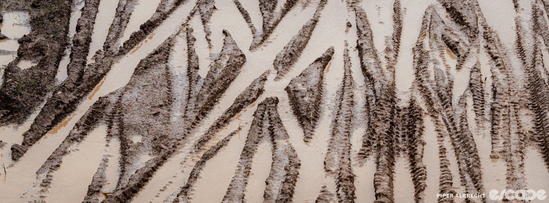

Notice the plastic grid matting on the first ski-slope climb, which helped the course stay together better, as long as you stuck to the inside line.
Adding to this, underneath the gravel, a plastic grid matting had been laid. This was holding together the mud, prevnting it from becoming a deep sludge. This gridding also aided drainage and drying much quicker than sections without it, creating quite a hard-packed main line after just a short time when the sun did poke through.
As is often the case, the course ran quite well whilst the rain was falling, with tyres able to clear the wet mud and leave the tread open to keep grip. It was the hour or so after the rain stopped where the drying mud turned to a peanut butter or Nutella consistency, clogging the tread pattern and stopping the tyres from biting into the ground.

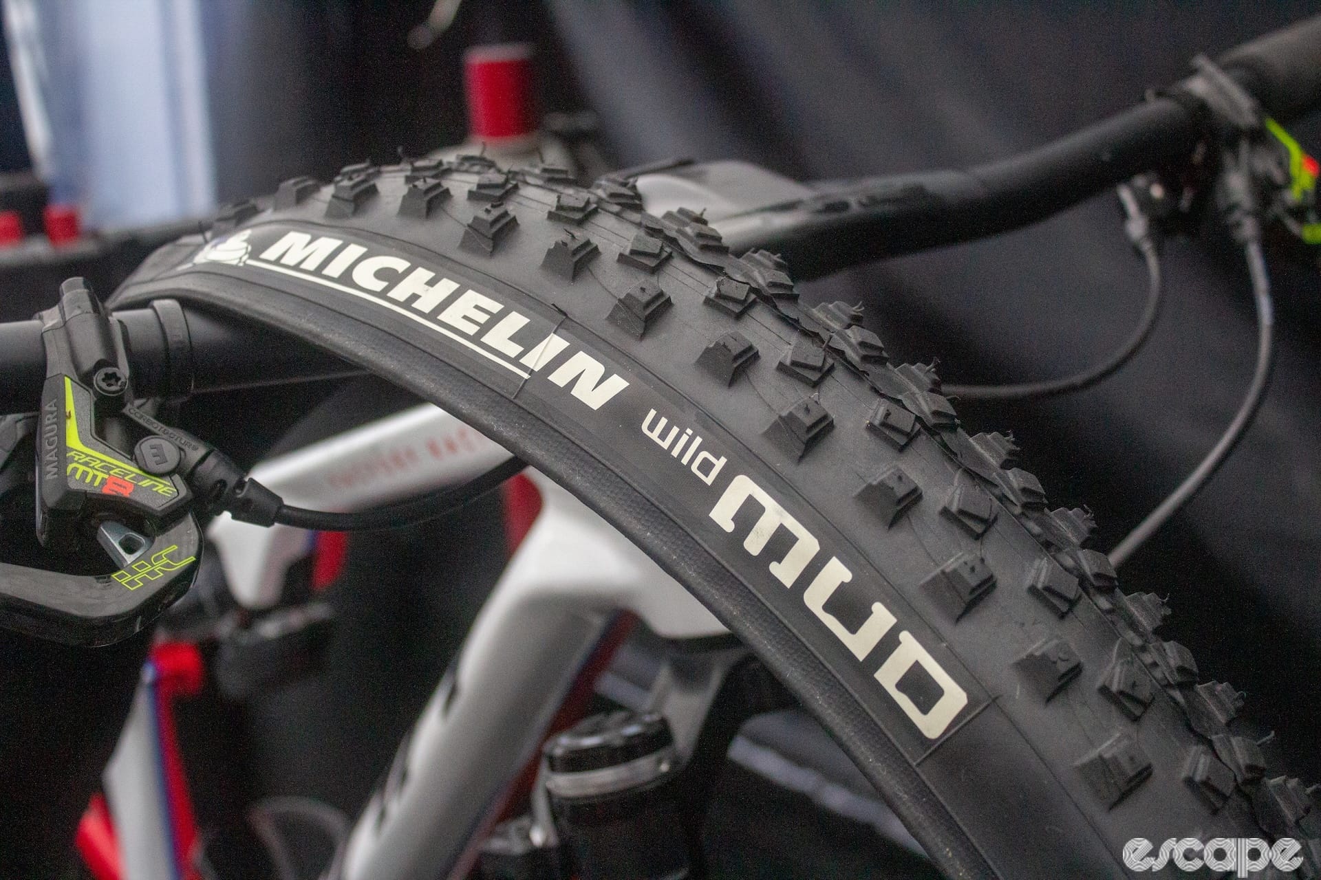

Michelin is the tyre sponsor of Sunn Factory Racing; they have one of the most aggressive cross-country mud tyres available to them in the Wild Mud. Mechanic Vincent Sarthe explained that they were running the 2.0" width, something that not only enables the tyre to cut into the mud better but also gives better clearance on the frame and fork when the mud starts collecting.
Michelin's unique double-stacked tread offers the ability to trim tread blocks for conditions.
