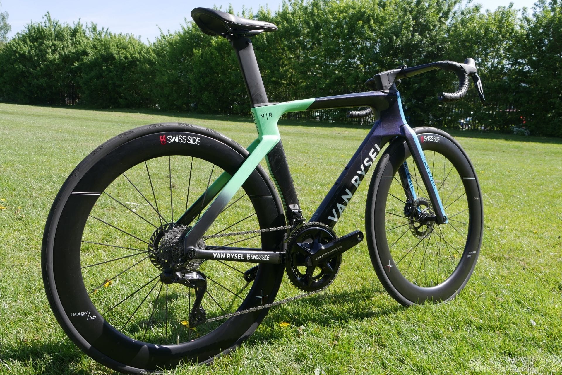

With deep aero tubes that make use of the UCI's newly relaxed rulings, the RCR-F, as you may expect, has gained weight compared to its skinnier, do-it-all RCR brother. The size S Team Replica Dura-Ace model I have for review comes in at 7.6 kg (without pedals or bottle cages) – not the heaviest in the WorldTour, but the Decathlon-AG2R La Mondiale riders were reportedly reluctant to see the weight pushed any higher than this.

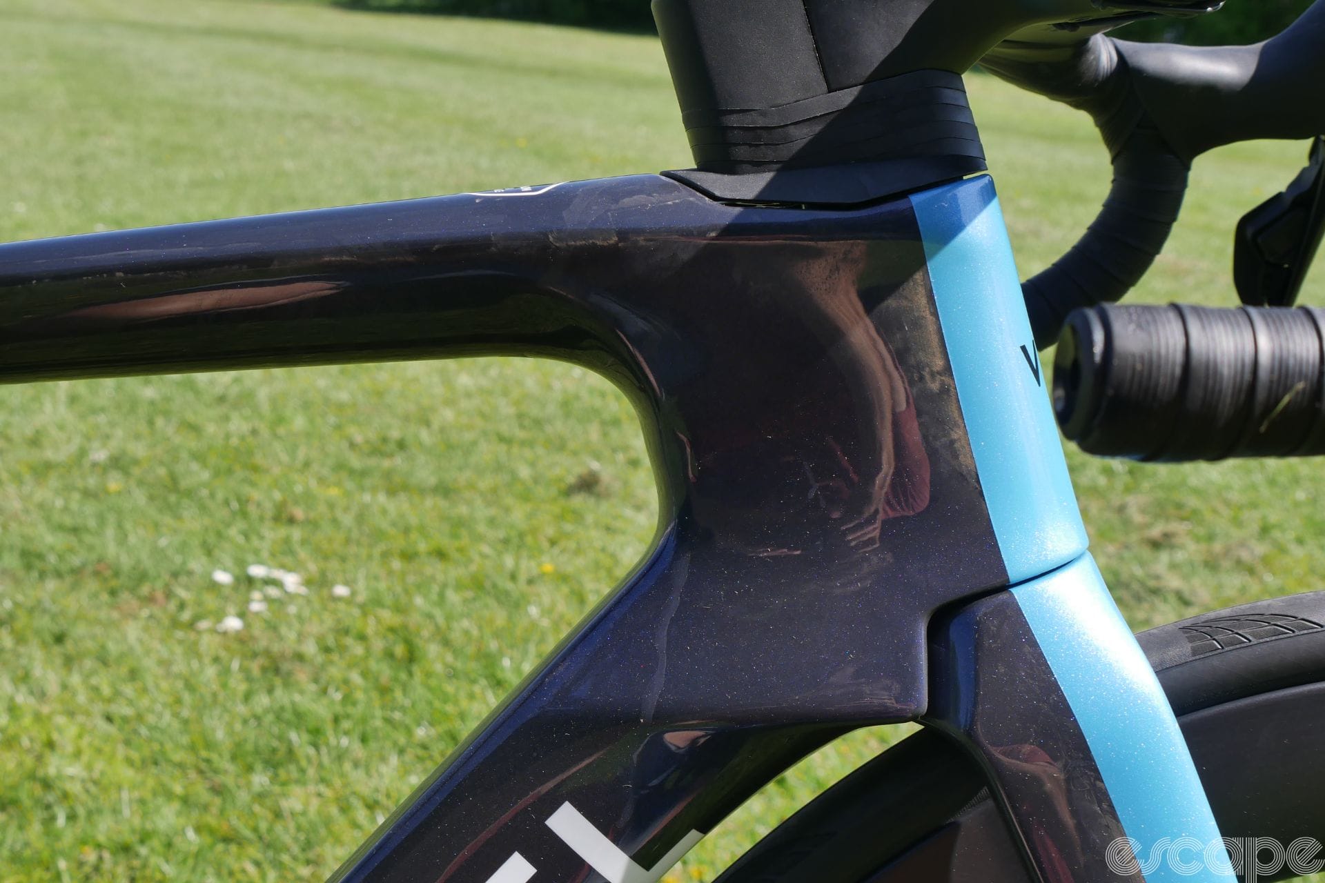

The deep section head tube makes the most of the UCI's relaxation on aero design, resembling Ridley's Noah Fast 3.0.

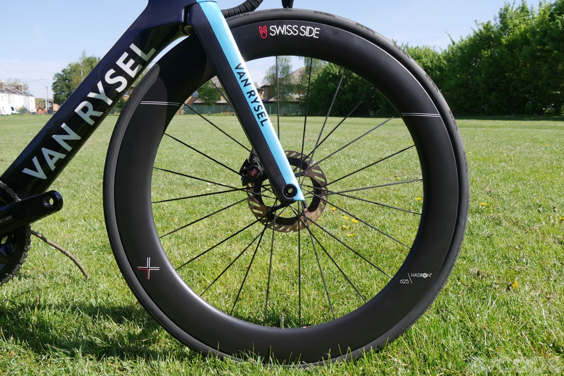

The fork is also a lot deeper than the one found on the RCR, which is claimed to offer a 1.2-watt benefit.
Almost all of the claimed efficiency gains come from the front of the bike. At 45 km/h a 1.2-W saving comes courtesy of a deeper fork, a 4.4-W saving at the head tube with this section moving in the same direction as Ridley’s Noah Fast 3.0, and a 2.7-W saving from the dining table of a cockpit. The down tube, which has also seen a significant overhaul from the RCR, yielded only a 1.7 W of improvement. The other areas that saw improvement were not listed in the brand’s white paper, with these four areas noted as seeing the most significant improvements.

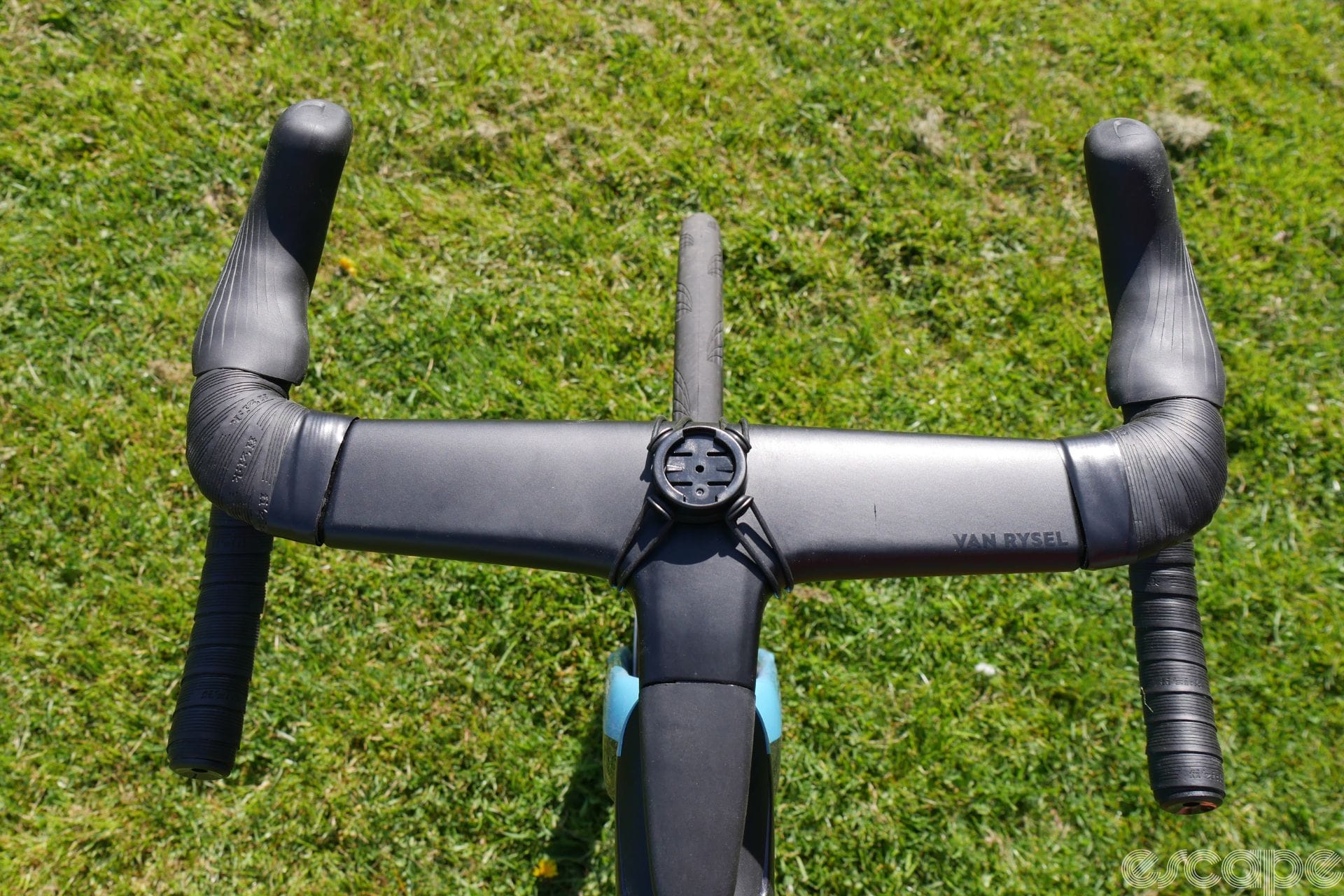

Deda was once again enlisted to produce the bar and stem combo. With a profile that’s far deeper than most, the bar is claimed to save 2.7 W compared to the RCR cockpit. However, this comes at the expense of the riding position, where the tops are now so deep that for anyone with small hands, there is no longer a viable relaxed riding position. And even for those with bigger hands that can wrap around the tops of the bar, it’s far from comfortable.
Unless you have large hands, the tops aren't a position you can securely hold.

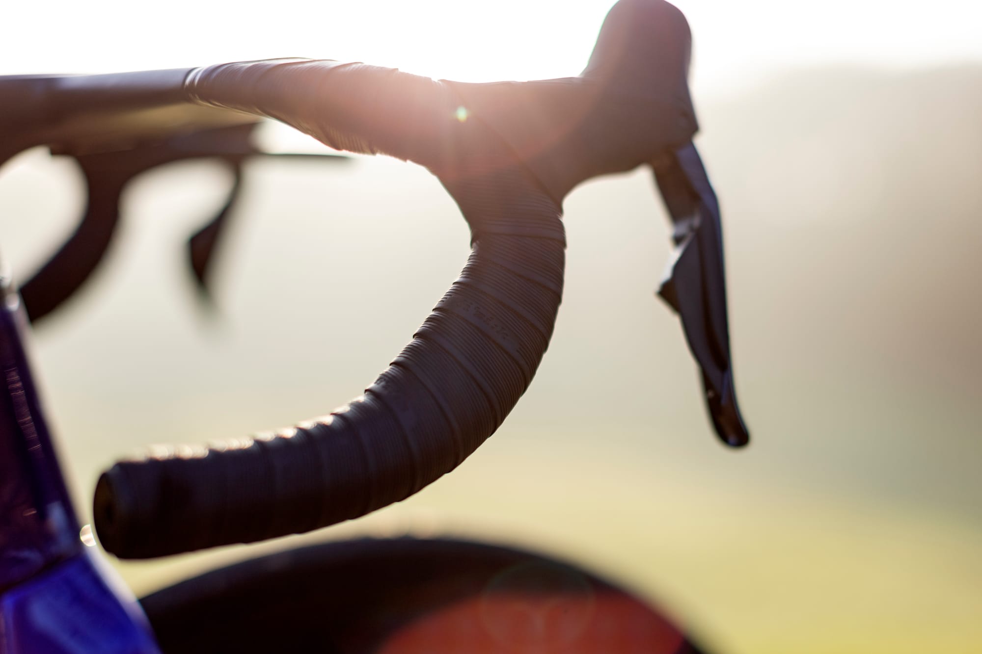

With the tops out of commission, you’re left with the hoods and the drops. As a result, Van Rysel and Deda paid close attention to the drop shape, with an ovalised ergonomic profile that sits in your hands and is far nicer than a traditional round section. On the cobbles of Roubaix, this was particularly beneficial and something that the other reviewers I have spoken with praise greatly.
As a pre-production model, the RCR-F I have to review foregoes the ergonomic drops; however, I did get to try them out whilst on a media event at Paris-Roubaix.

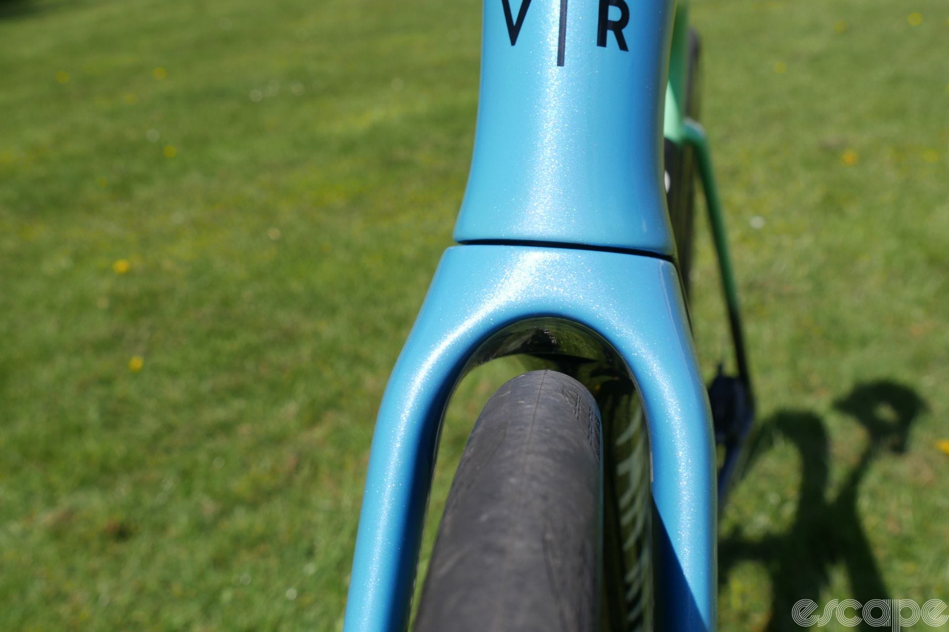

The build I was sent came with 28 mm Continental GP5000S tyres however, retail builds will ship with the Aero 111 26 mm front tyre. It might have some watt savings, but most people are going to want a wider tyre upfront.
Van Rysel has ensured the RCR-F is up-to-date with a 33 mm max tyre clearance, which should future-proof the frame for at least a few years of tyre width trends. A BB86 press-fit bottom bracket bucks the trend for threaded bottom brackets, allowing for a wider shell to be used. A proprietary aero seatpost and wedge clamp round off the frameset.
