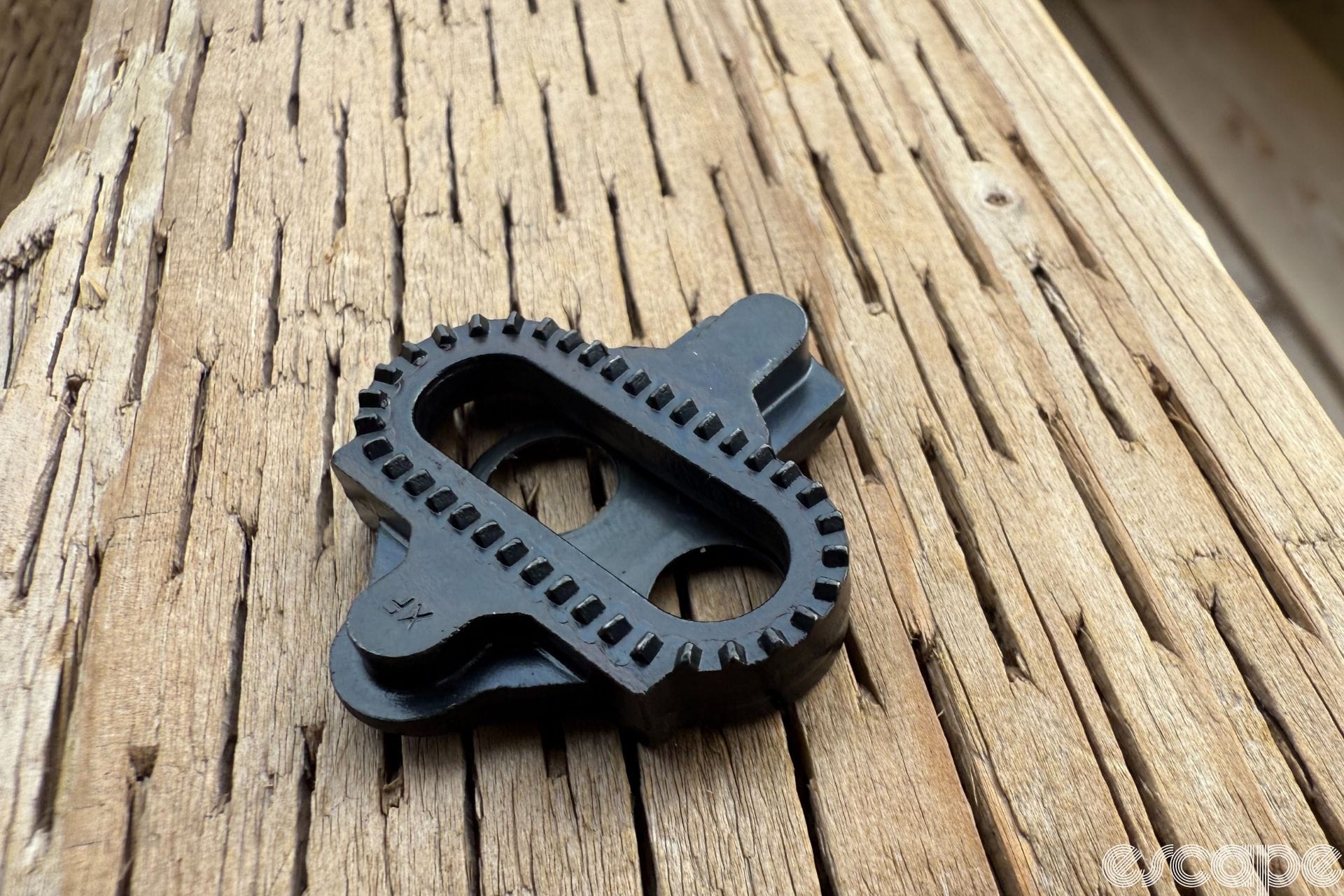

The changes are subtle, but Shimano says they matter
Unless you have an SH51 and an MT001 cleat sitting next to each other, the only way you’ll be able to tell which one you are looking at is by the model number stamped on the cleat body.
Although the silhouette may be nearly identical, the key difference between the two cleats is found at the front. Where the SH51 has a more angular design, the MT001 has a more rounded, less angular taper. There’s also a new central groove, possibly a centring aid for future pedals, though its purpose is unclear and Shimano is being its usual silent self.
The MT001 cleat between the new pontoon system and the existing SH51 cleat.
On the underside of the cleat, everything remains the same; this means that once you are clipped into the pedal, you experience the same security as with an SH51 cleat, the level of float and the resistance are comparable, and the method and tension of release are unchanged.
The underside of the MT001 is identical to the SH51.
Mounting the cleats is also unchanged, with the system simply bolting to any two-bolt cleat interface. Like other Shimano cleats, these include a silver ring that’s used as a cleat spacer if the tread on your shoe protrudes too much to inhibit cleat engagement – you don’t use this part if you don’t need to.
