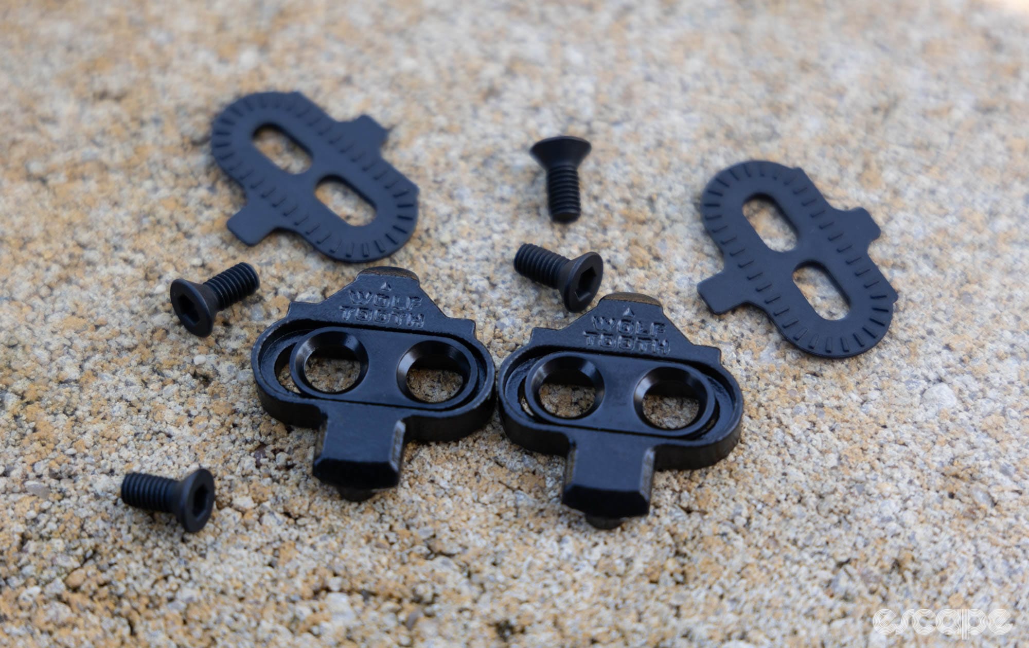

All three models of pedal share the same cleat compatibility. The pedals are supplied with Wolf Tooth’s own two-bolt SPD cleats, but Shimano and similar SPD cleats are fully compatible, too.
Nothing fancy or innovative about these cleats, and that's hardly a bad thing.

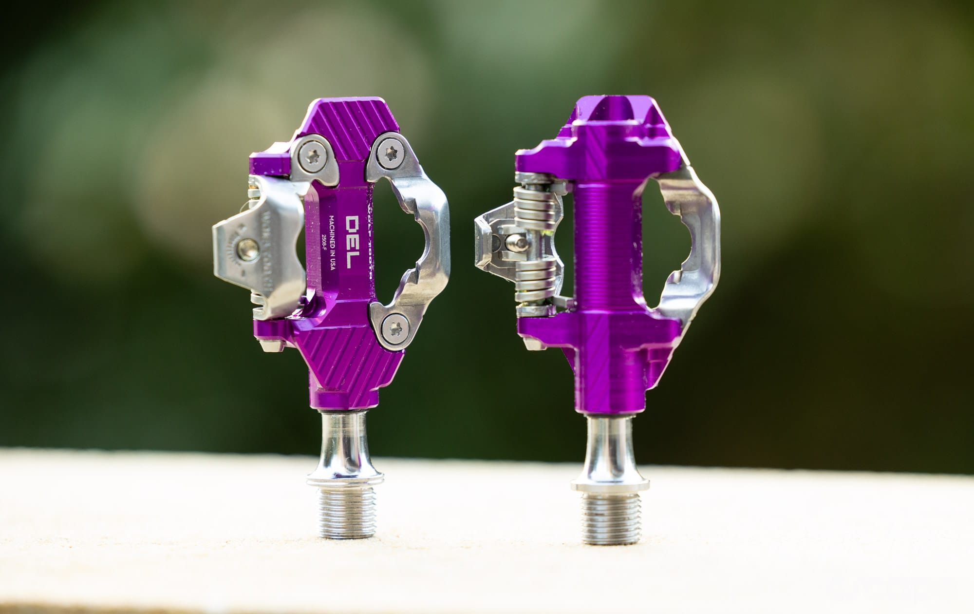

The DEL is a single-sided SPD offering aimed at gravel and road use.
This interesting take on pedals boosts the platform area to a massive 559 mm², which according to Wolf Tooth, aims to provide a contact area that more closely matches a road pedal. Through being single-sided, the stack height is also reduced further, to just 14.7 mm (.3 mm less than the ALT). Watt Weenies will point out that it’s surely a more aerodynamic shape, and it’s of course lighter, weighing an actual 218 g for the pair (cleats not included).
The DEL.
With this, Wolf Tooth is seemingly trying to fill a market gap left by the now-discontinued Shimano A600 gravel pedal, which carries a bit of a cult following who don’t seem satisfied with Shimano’s current offering, the ES600.

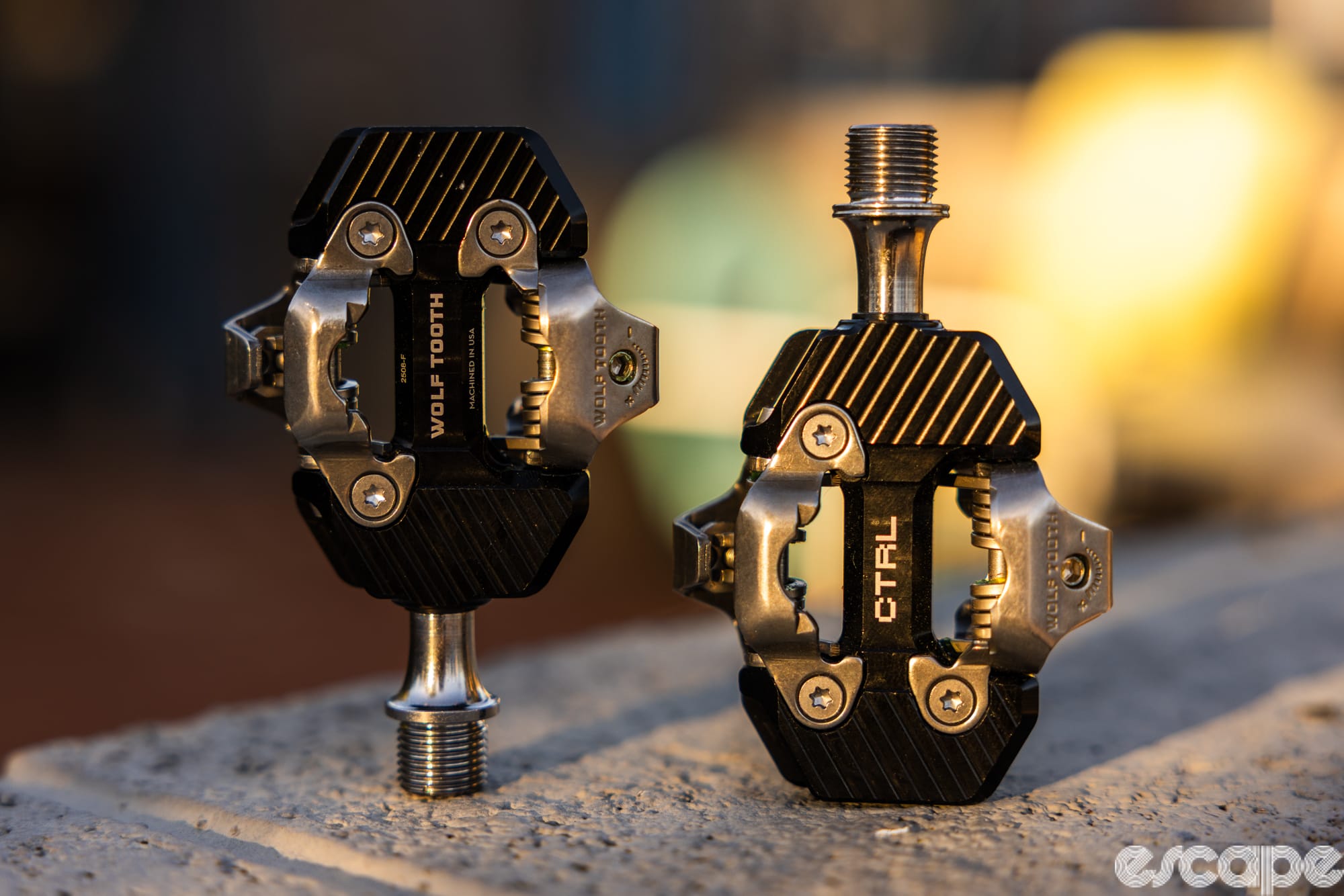

The CTRL for Trail
Finally, the CTRL is the more trail-oriented pedal of the range. However, unlike pedals with grippy surrounding platforms such as the new Shimano XTR M9220, OneUp Clip, or equivalent, Wolf Tooth’s version looks far more like a traditional SPD pedal with an enlarged surrounding surface. Perhaps the best comparison point would be the Crank Bros Candy.
The CTRL.
With a huge 941 mm² contact area, Wolf Tooth claims its design gives a more secure engagement and better bike control. The pedals are claimed to 326 grams and have the same stack height as the ALT model. While we haven’t ridden it, this one is certainly intriguing, especially for riders who typically prefer the feeling of trail-style SPDs for even XC-style riding.

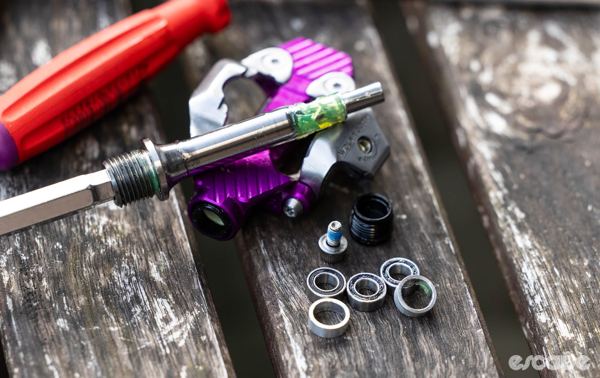

One of the more unique features to the Wolf Tooth’s CTRL + ALT + DEL SPD range is the adjustable spindle width. Ok, so technically it’s an adjustable Q-factor, but semantics aside, it’s a neat feature. Inside the pedal body, you'll find one long bushing (located on the inner side of the pedal body), followed by a row of three cartridge bearings. Alongside those cartridge bearings sit two aluminium spacers that determine where the pedal body sits in relation to the spindle.
Inside the pedals and a look at the spacers.
