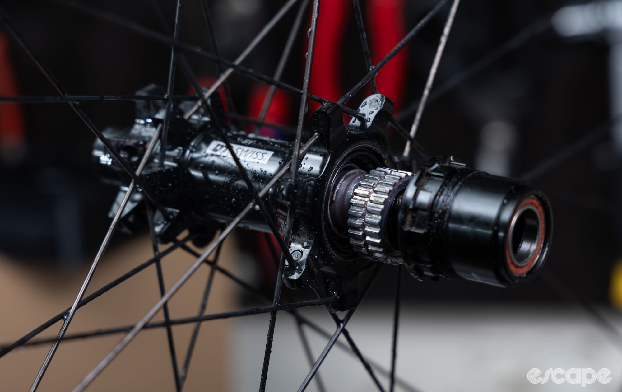

When coasting, the angled geometry of the ratchet rings causes them to separate. The two rings remain in rubbing distance of each other, and the clicking you hear while coasting is the peaks of the teeth knocking over each other (see video). Pedal forward, and the teeth catch, coaxed in by the axial springs.
The original DT Swiss Star Ratchet system.

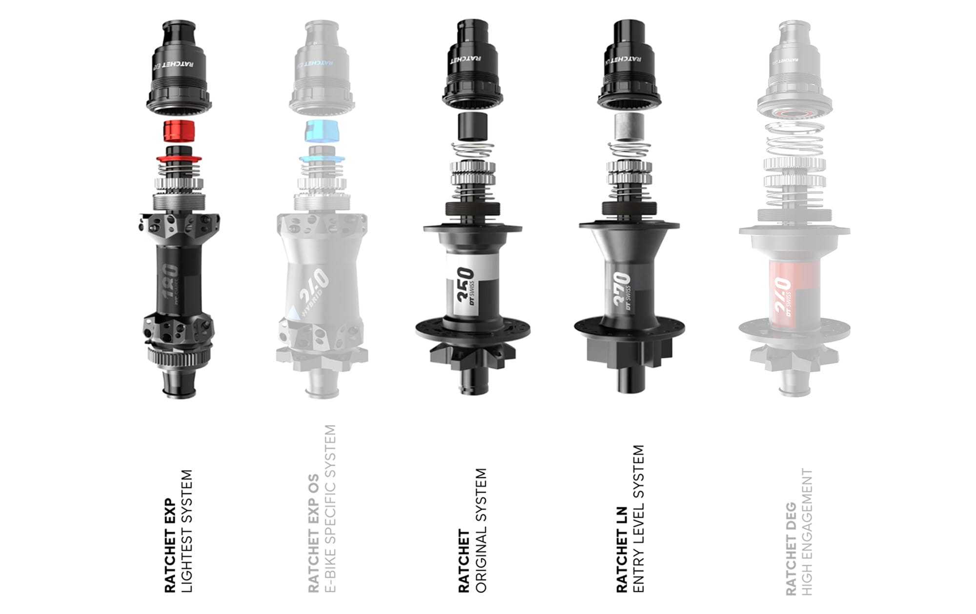

In recent years, the expiring patent saw DT Swiss innovate on its legendary Star Ratchet and introduce Ratchet EXP – a system that fixed one of the sprung ratchet rings in place, aiming to save weight and widen bearing spacing. It also introduced more noise, which some love and many hate. It remains a more premium option in DT Swiss’ line-up, limited to higher-end road, gravel, and cross-country models such as the latest 240s and 180s.
DT Swiss' Ratchet system family has grown greatly in recent years. WRP's kit applies to the most common variants.

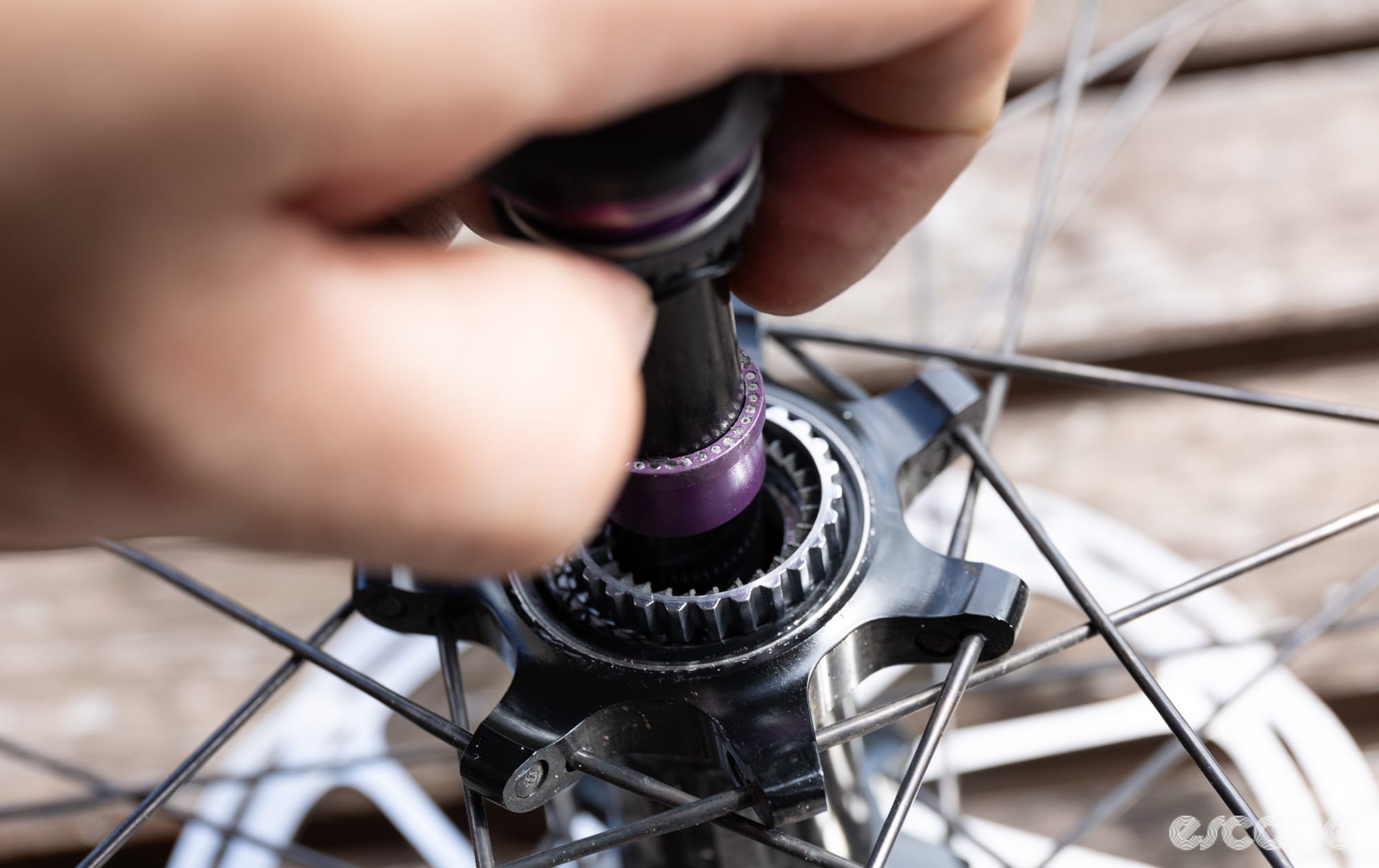

If you’ve ever serviced a DT Swiss Star Ratchet hub, then you’ll be very comfortable with installing the Zero Drag kit.
