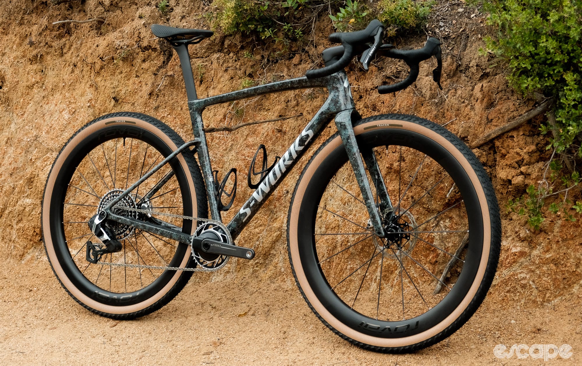

That update lands today as Specialized unveils the fifth-generation Crux. Look away now if you loved the unapologetically classic approach the Crux offered until now.  If the previous Crux was a gravel-going Aethos, the new one is a Tarmac for the dirt. Legacy name aside, Specialized has ditched the bike's cyclocross DNA entirely, redirecting its attention to modern gravel racing.
The result, the brand says, is the fastest gravel bike it's ever made. And while it’s not lighter – in fact, the frame is some 60-odd grams heavier than its predecessor – Specialized claims it is 15.2 watts faster than the old Crux at 45 km/h, thanks to a near-eradication of the round tubes and traditional design that contributed to the previous Crux’s popularity, some new wheels, and a new handlebar. But ditching that classic look seems worth it given the direction of modern racing, with Specialized claiming these updates would have seen Mads Würtz Schmidt finish the 2025 Unbound some 7 minutes 45 seconds faster, while Sophía Gómez Villafañe would have gone 9 minutes 58 seconds faster.
Unsurprisingly, there’s also a significant bump in tyre clearance, and the geometry also got an overhaul. In fact, apart from the naming, there’s very little carryover. There’s also a new “S-Level” spec bringing S-Works level builds to Specialized’s second-tier Fact 10r frame.

Perhaps the better question is what’s not new? Ask what the difference is between an Aethos and a Crux 4, and you more or less have the answer to what the difference is between a Crux 5 and a Tarmac SL8. From its narrower head tube with a mini-speed sniffer, aero-profiled fork, integrated hose routing, shared seat post and similar-looking seat tube, to its dropped seat stays and roundish down tube, the new Crux looks every bit the gravel-going Tarmac. So much so, had Specialized just called it the Dirt-Mac, I’m not sure anyone would have batted an eyelid.
