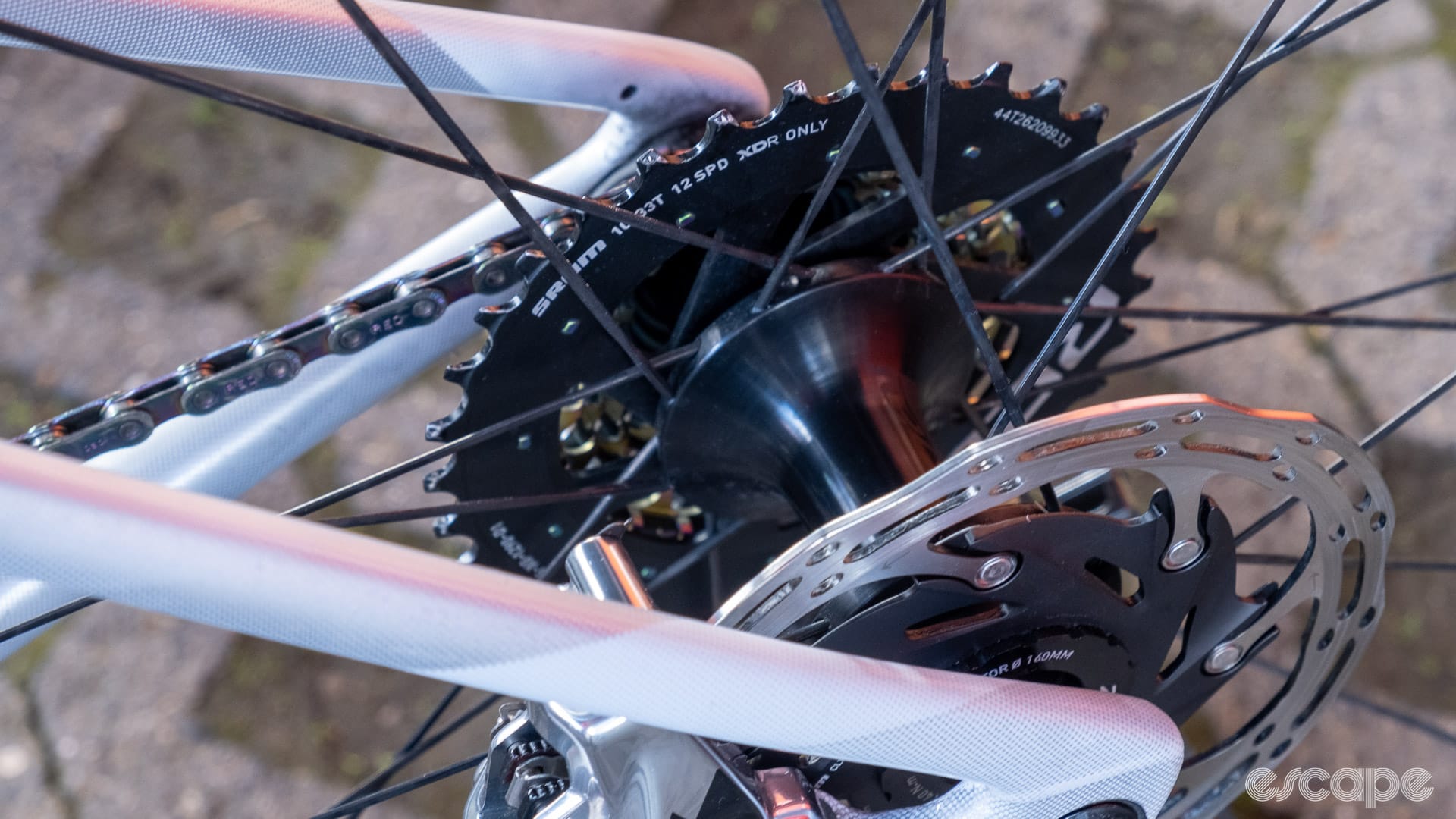

Unlike many riders on SRAM at De Ronde, Kopecky stuck with a 160 mm front rotor.
She also stuck with the existing 10:33 SRAM Red cassette rather than opting for a few extra teeth with the 10:36 on either the existing Force cassette or with what appears to be a new SRAM Red cassette.
