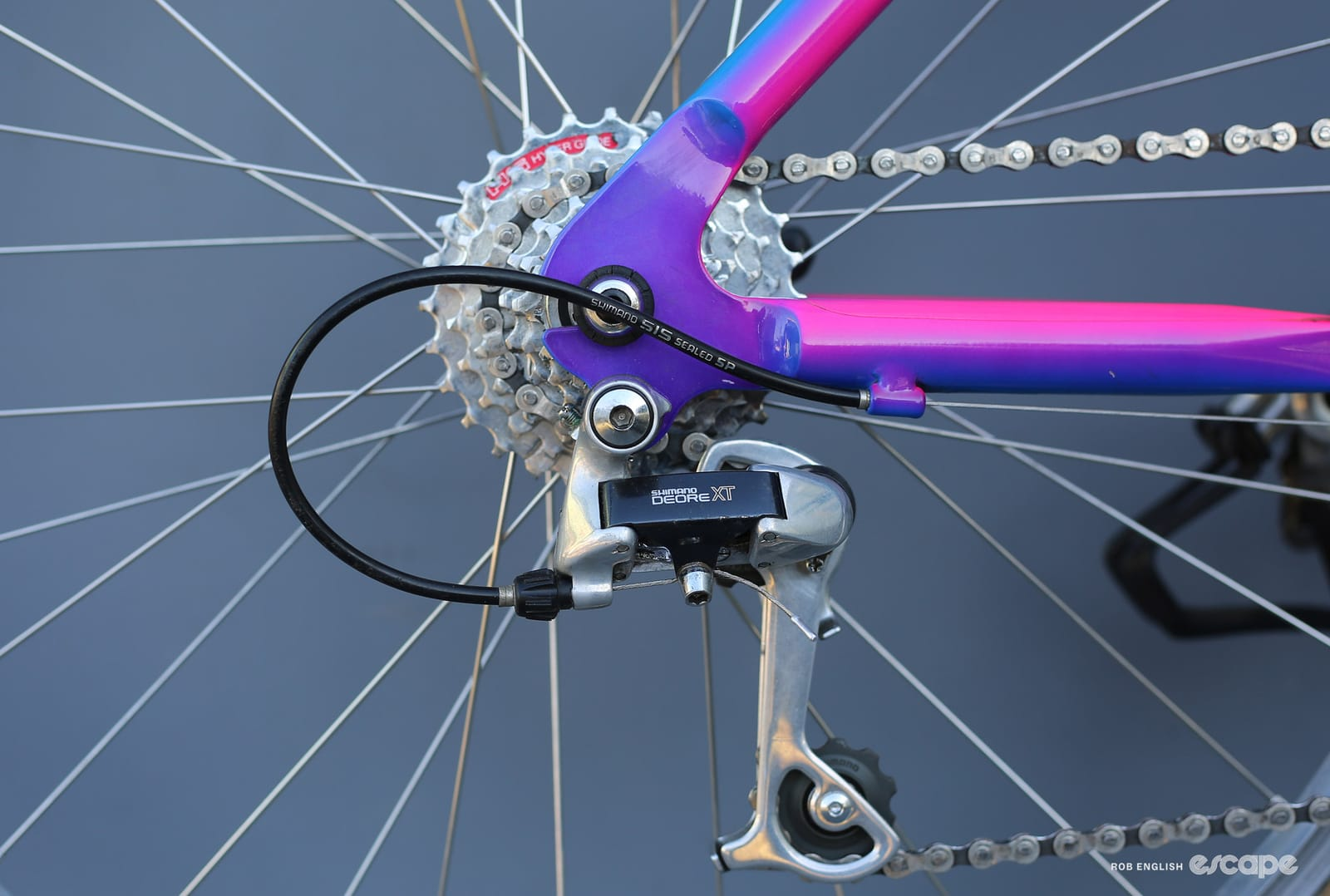

This began for me with my original 1991 Stumpjumper which came with a stock Shimano XT 21-speed groupset. It wasn’t long before I removed the inner chainring to go 2x7. Then, because of the extra ‘hidden’ position of the thumbshifter, I switched to an 8-speed freehub body, and fitted an aftermarket 32T aluminium cog behind the 7 speed 12-28 cassette to get a super-wide range (ha!) with 2x8.
Square-taper bottom brackets and cranksets allowed for adjusting the chainline, pretty much every front derailleur was compatible with any shifter, and so mix-and-matching was easy – John Tomac could even run the early drop-bar STI levers with mountain bike derailleurs.
Things used to be easier. Also: bring back 90s-era neon fade paint jobs.
