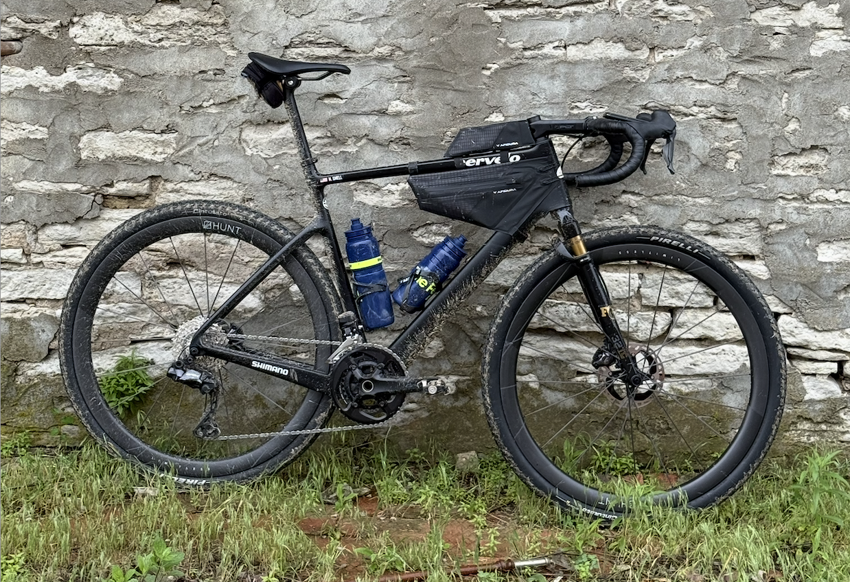

Two recent four-day testing blocks conducted by Marc Graveline, a performance engineer best known for co-developing the Notio Konect aero sensor and consulting for WorldTour teams on aero and tyre testing, using his in-house drag measurement system, IMUs (Inertial Measurement Unit, which track acceleration and angular velocity) and Unbound-bound pro racer Hannah Shell, turned a belief that big, fat, mountain bike tyres are fastest on rough gravel on its head.
Gravel racing has always sat in the grey area between road and mountain biking. And lately, a growing number of riders have been leaning toward the MTB end of the spectrum, fitting mountain bike tyres for improved speed, comfort and control on chunky terrain. Testing has shown that these big tyres are faster. But Graveline's testing adds a large caveat to that idea.
The big revelation? On the rough gravel roads, mountain bike tyres were only faster than narrow tires when paired with a rigid fork. Once a suspension fork was introduced, gravel tyres flipped the script, outperforming not only the gravel tyres paired with a rigid fork, but also MTB options. The improvements came in both feel and in considerable, measurable wattage savings.

“It really shocked me,” he said. “We ran both tyre types on both fork setups, and the performance reversed completely when we added suspension. The gravel tyre became faster. That was the moment the penny dropped, every component interacts with the others on gravel in ways we didn’t fully appreciate before.”
