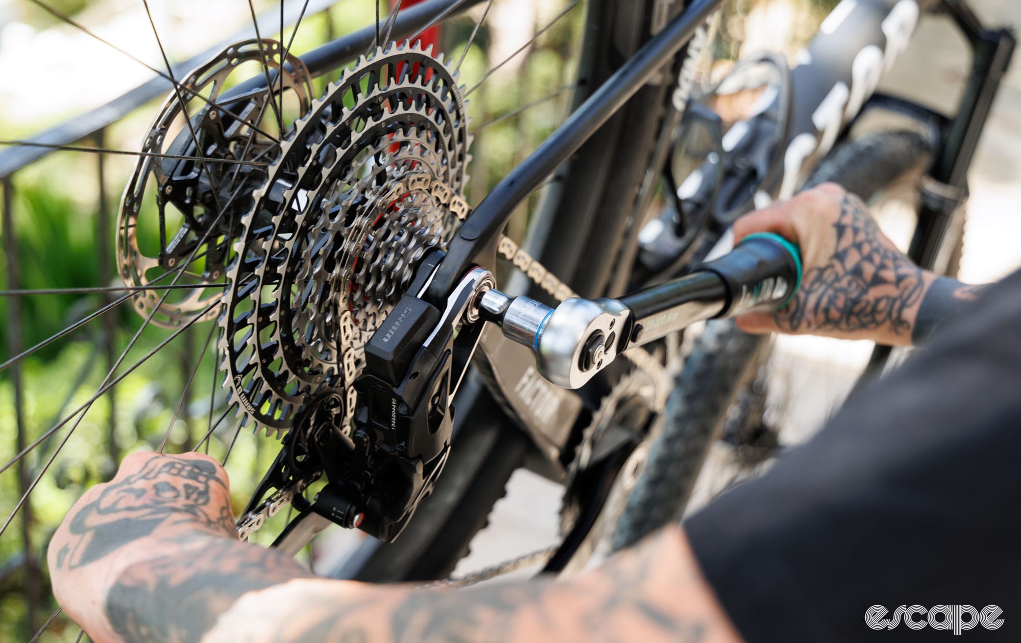

Wet vs dry fasteners
Fastener torque is a tricky subject. For a deeper understanding, you could read NASA’s Fastener Design Manual or a copy of Machinery’s Handbook. Or you could just understand that for the purpose of bicycle mechanics, the recommended torque values are based on measuring the fastener friction, with the goal for it to achieve the desired clamping force across a bolted joint interface.
For a torque wrench to accurately apply the intended clamp load there are some assumptions made regarding the condition of the thread and how it is prepared. "The difference between a dry and lubricated fastener will affect the amount of clamping load you can apply to that fastener for a given torque," explained Boone. "A lubricated fastener allows you to apply more clamping force for the same twisting force."
Grease, anti-seize, thread locker, or just dry? It can make a big difference.
“When the fastener is dry, you have unknown and often variable friction between the thread surfaces, and are also much more likely to experience high and/or inconsistent forces or binding under the bolt head," Josh Poertner of Silca previously shared on the topic.
This quickly descends into a deep rabbit hole regarding thread preparation, quality of fasteners, material, diameter and shaping of fastener heads, alignment, coatings, types of lubrication used, and even how the lubrication is applied. I’m not going to get into the weeds about how using anti-seize will produce more clamp force for a given torque than standard grease (it does), rather, I’ll just say to follow the manufacturer's instructions whenever provided.
An increasing number of component and bicycle manufacturers will outline what to apply to a thread or when to keep an interface dry (clean and not lubricated). If in doubt, apply a small amount of grease to the thread, or consider using a thread locker if there is concern it may loosen due to insufficient torque or excessive vibration (such as around brakes).
Regarding thread lockers, running torque is common in bicycle wrenching. “Running torque is basically just friction between the fastener and the thread interface," said Boone. “Anyone who has installed a six-bolt rotor onto a wheel will have experienced running torque from the big blob of blue Loctite that prevents you from freely screwing in the M5 fastener. That force that you're feeling as resistance is a form of running torque.”
SRAM lever clamp bolts have proven to be a component impacted by running torque.
Often, that increased running torque isn’t a concern, but occasionally it can present problems, such as with the tightening of SRAM’s dropbar levers where excess running torque resulted in component slippage and a subsequent recall. “For practical purposes, it makes more sense to just clean the threads, maybe put some fresh liquid Loctite on there, and then just do it up to whatever the factory specification is,” said Boone – advice for when you’re experiencing excessive running torque from a dry patch thread locker.
