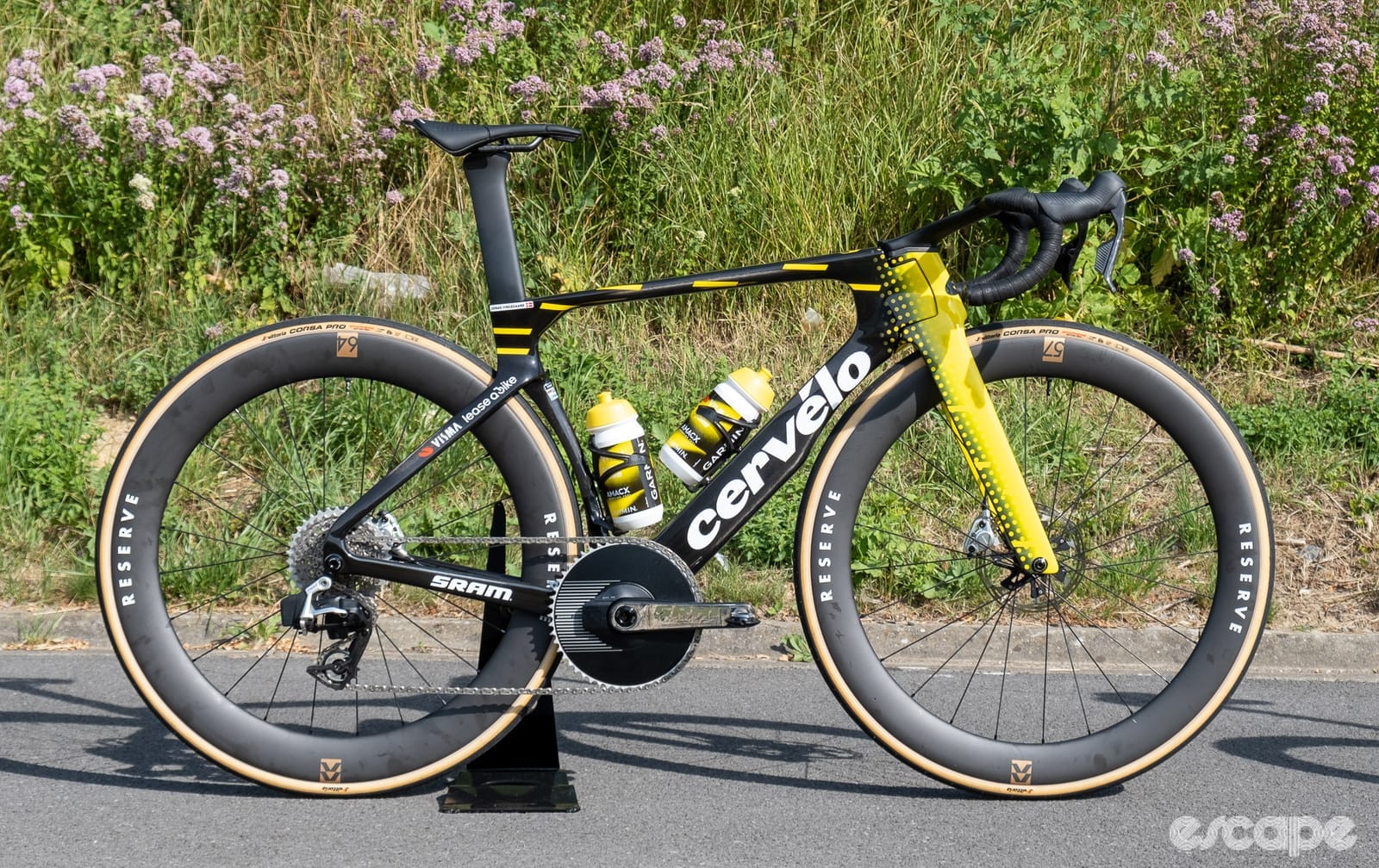

Visma-Lease a Bike has been racing the new bike at the Critérium du Dauphiné and now at the Tour de France, it has finally been officially revealed. For those looking for a grand upheaval of the existing S5 platform, this isn’t it. The familiar silhouette of the S5 remains, with small but meaningful tweaks to the frame, cockpit, and wheels all working towards the dual goals of decreasing weight and increasing aerodynamics.

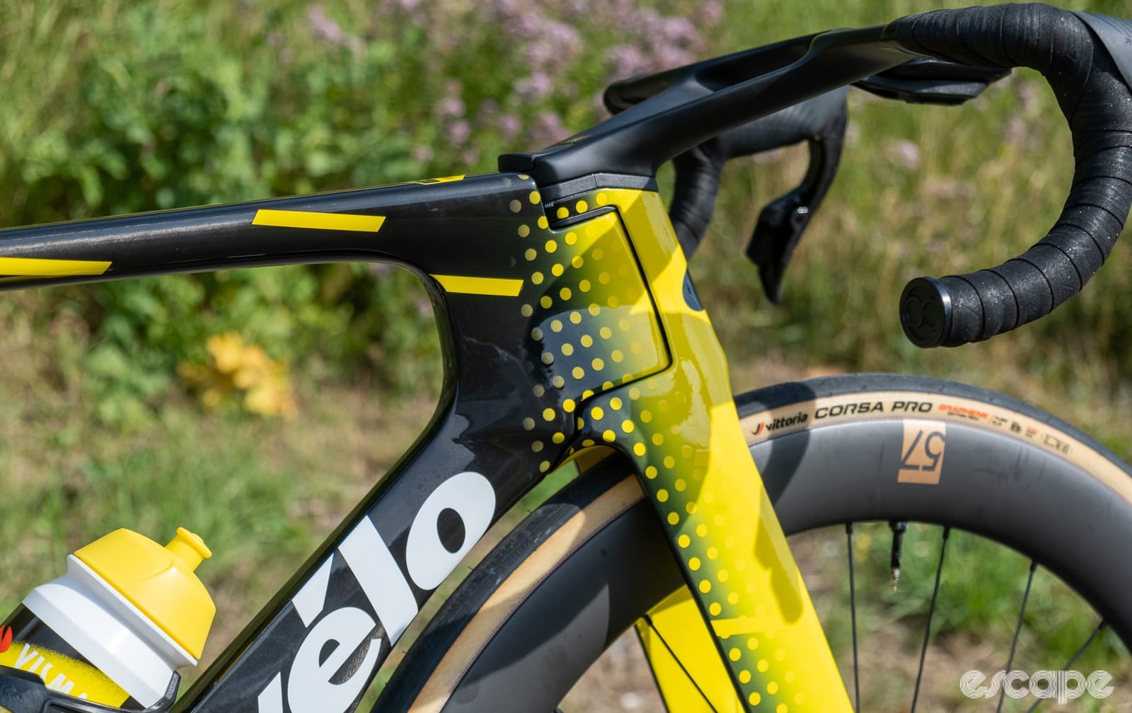

The head tube and fork are now deeper, with the trailing edges becoming sharper.
The DNA of the S5, including the wildly unique front end, is clearly intact with this new model, but subtle changes to the frame profiles have been made in pursuit of watt savings. The trailing edges of the tubes have become sharper, gussets are deeper, the seat tube has been shaped specifically for the Reserve 64 rear wheel to create an optimised aerodynamic system, and the head tube has increased in depth.
The fork has also seen a subtle redesign, with the brake caliper mounting point now deeper, and a change to the threaded insert, made to save weight. However, tyre clearance remains the same as the previous generation, at 34 mm.
