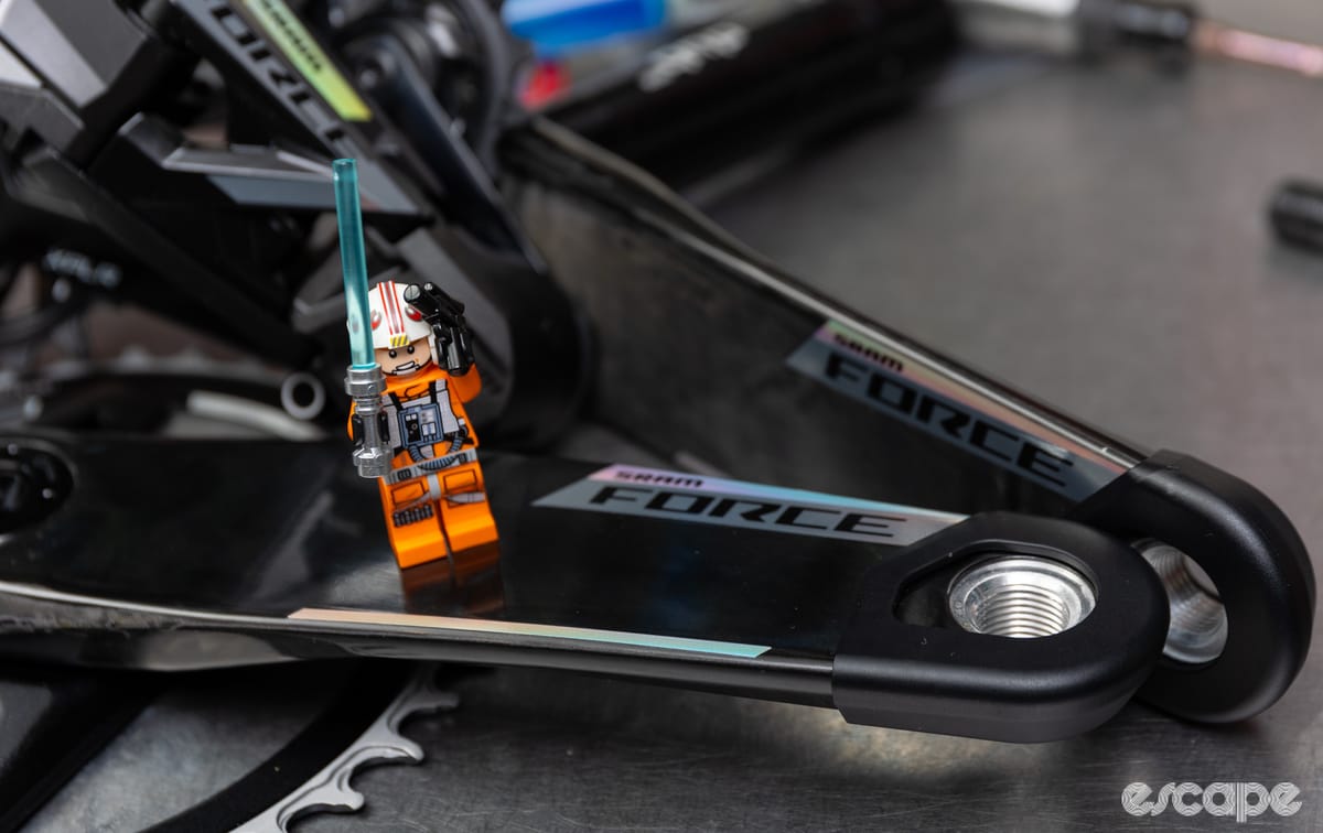

Let’s begin with SRAM’s Force AXS XPLR E1, a groupset previously reviewed. While not at all a budget groupset, it’s a more affordable version of SRAM’s flagship Red AXS XPLR E1. This 1x13-speed groupset repurposes the brilliantly light-action brakes from SRAM’s Red AXS road group and then borrows the Full Mount rear derailleur concept from the American company’s Transmission mountain bike range

The result is a unique rear derailleur that’s designed around a specific 10-46T cassette. That derailleur requires a frame with a Universal Derailleur Hanger (UDH), which only new gravel bikes have. Meanwhile, the derailleur uses the same removable battery that has powered SRAM’s wireless gearing for the past decade. For the data lovers, SRAM Force also offers two native power meter configurations with its carbon crankset.
