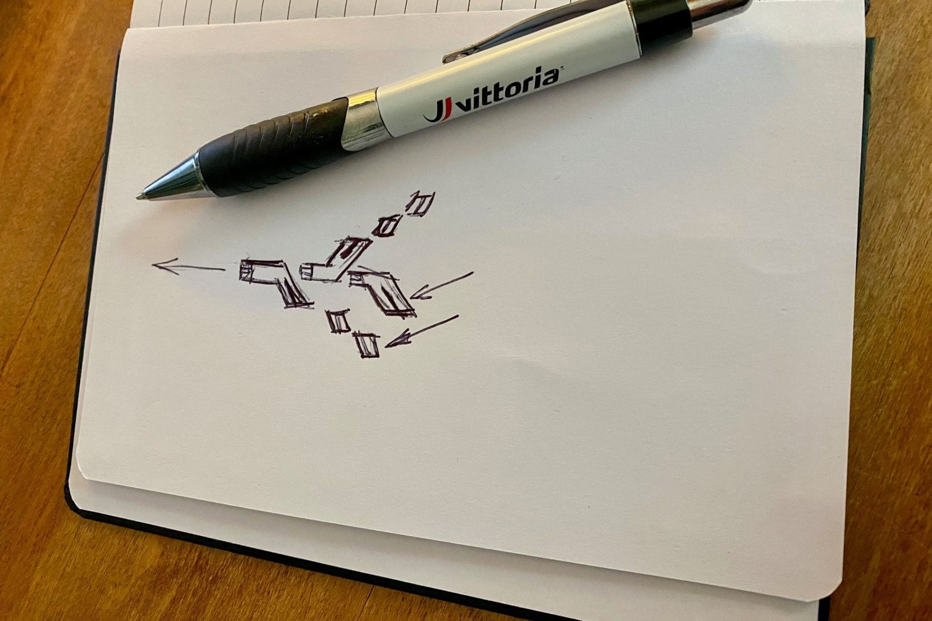

Ken Avery, senior vice president of product development at Vittoria, calls tread design a "dark art," still sketched on napkins rather than spat out by software. That might sound romantic, or old-fashioned, depending on your view.
Of course, that mystique also helps keep the process opaque, keeping the specifics hidden and consumers reliant on brand authority.
Avery has designed tyres for Vittoria for a decade and, prior to that, spent over a decade in a similar role at Maxxis, where he helped create some of the most recognizable designs on bikes today, and that cumulative experience is essential in the field. “You can't just go to AI and have it spit out a tread pattern,” Avery explained. Although that isn’t off the table in the future, for the time being, tyre design is a deeply human endeavour.
Tread patterns initially start as a rough sketch, highlighting the key elements of the tread.
Explaining what it takes to become a tread pattern designer, Avery said, “You need to have some sort of background or experience to do that because it has to be something that authentically relates to a real rider situation.” For Avery, tyre design is a mix of gut instinct, material science, and rider feedback – a process that still resists being reduced to pure data.
