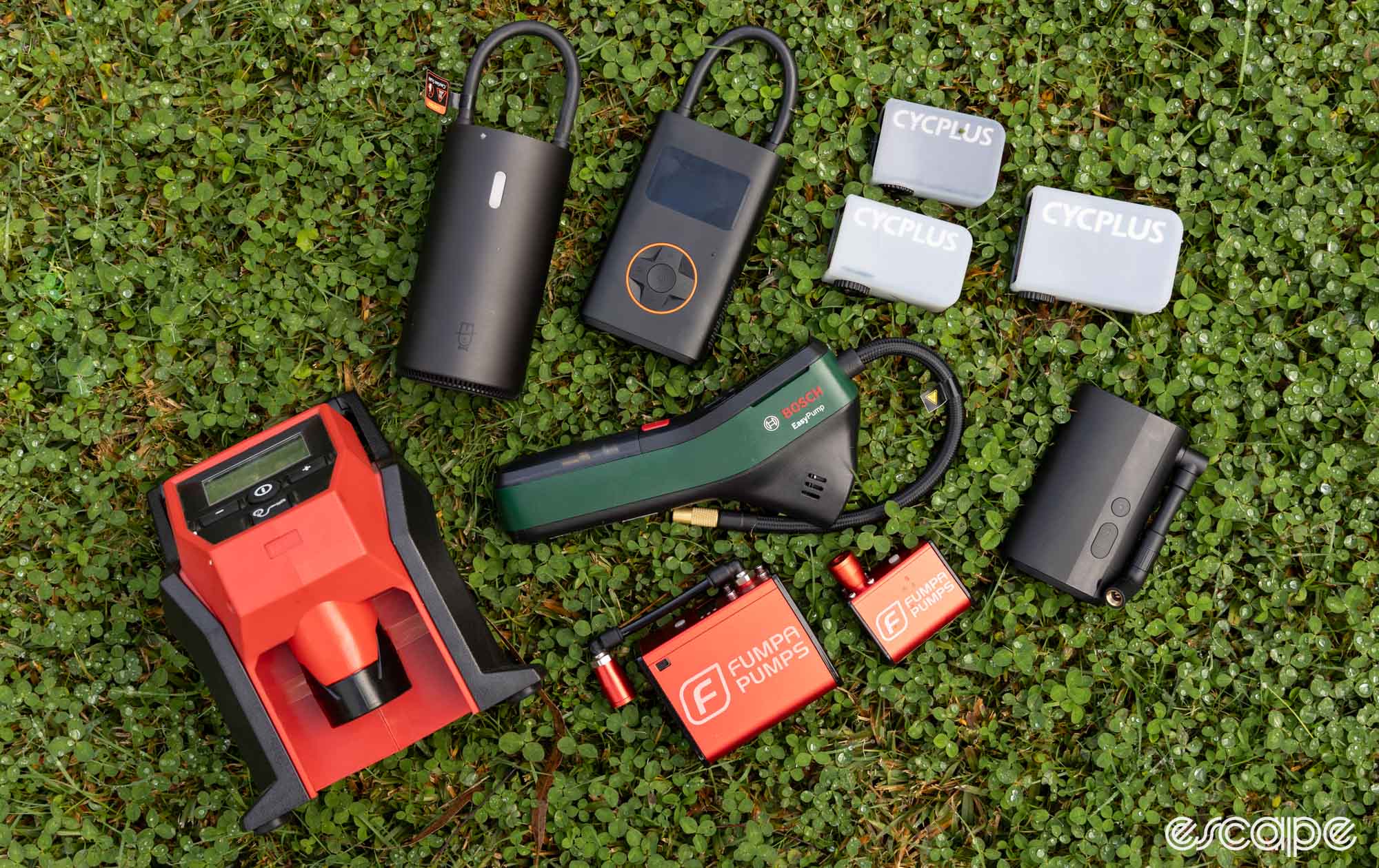

The most saturated and arguably most mature segment is that of small to medium-size inflators. For bicycles, these inflators are effectively competition to the humble floor (aka track) pump and are best used to top up and check pressures before the ride. It’s also a fantastic option as something compact and portable to leave in the car or take on a holiday. Some riders also happily carry some of the smaller inflators on rides (such as the original Fumpa or QiCycle Mini), but I find them too weighty for that. Meanwhile, the medium-size inflators, such as the Bosch Easypump or QiCycle N3, are typically less cycling-specific in intended purpose, but will certainly inflate a bunch of bicycle tyres without fuss.
![Best-portable-cordless-tyre-inflators-threaded-2024-dave-rome-10](https://escapecollective.com/content/images/wordpress/2024/08/Best-portable-cordless-tyre-inflators-threaded-2024-dave-rome-10.jpg)

Rather than write endlessly about the features of each pump, I instead decided to distill it into numbers. There’s a whole lot to unpack in the chart below and I still hear the buzzing from the hours spent putting this data together.
Product | Weight (g) | Dimensions (mm) | Size category | Price (USD) | Time to 80 psi (700 x 28 mm tyre) | Time to 25 psi (29 x 2.6″ tyre) | Inflations of a 29 x 2.6″ tyre | Inflations of 700 x 28 mm tyre | Actual pressure at device 25 psi / 80 psi | Decibels at 20 psi | Actual Max Pressure (psi) |
NanoFumpa | 98 | 58x66x28 | Mini | $99 | 1 min 40 seconds | 2 min 48 seconds | 1.8 | 2.6 | No Gauge | 83 | 93 |
Cycplus AS2 | 119 | 67x48x31 | Mini | $89 | 1 min 45 seconds | 2 min 26 seconds | 1.48 | 1.96 | No Gauge | 88 | 102* |
Cycplus AS2 Pro | 137 | 73x50x31 | Mini | $109 | 53 seconds | 1 min 33 seconds | 3.16 | 4.5 | 23.6 / 79.2 | 86 | 120 |
Cycplus AS2 Pro Max | 231 | 83x61x35 | Small | $129 | 35 seconds | 1 min 05 seconds | 6.76 | 8.8 | 23.2 / 78.9 | 86 | 119 |
Fumpa | 375 | 89x93x44 | Small | $149 | 24 seconds | 55 seconds | 3.52 | 7.75 | 25.4 / 80.1 | 89 | 120 |
QiCycle Bike Pump Mini | 386 | 107x77x38 | Small | $60 | 1 min 28 seconds | 2 min 34 seconds | 11.98 | 13.87 | 25.3 / 80 | 91 | 150 |
QiCycle N3 | 434 | 188x74x46 | Medium | $60 | 44 seconds | 1 min 28 seconds | 15.28 | 22.68 | 25.2 / 80 | 95 | 150 |
Mojietu Electric Inflator Pump | 494 | 205x70x70 | Medium | $50 | 1 min 28 seconds | 2 min 40 seconds | 12.32 | 16.85 | 26.9 / 79.2 | 89 | 153 |
Bosch EasyPump | 421 | 270x100x49 | Medium | $85 | 1 min 21 seconds | 2 min 09 seconds | 9.76 | 9.56 | 24.8 / 80.7 | 93 | 151 |
Milwaukee M12 Compact Inflator | 1,601 | 190x165x145 | Large | $95 (no battery) | 22 seconds | 43 seconds | 9.88 | 14.94 | 22.2 / 79 | 93 | 122 |
*Cycplus AS2 suffered from a smoking smell during the max pressure test.
The controlled tests were conducted with two different wheel/tyre setups to replicate different high-volume (off-road) and high-pressure (road) needs. Testing each pump’s capacity off a single charge proved to be truly maddening, but the longevity is useful information. The numbers here represent the number of full inflations to the specific pressures, with figures after the decimal point being a percentage of how much pressure was achieved in the final inflation before cutting out.
The time to 25 psi is based on filling a 29 x 2.6" tyre, while the time to 80 psi is based on a 700 x 28 mm tyre. You may be wondering how these inflation speeds compare to a floor pump, and the results may surprise you. Using a Lezyne CNC Floor Drive HP, I inflated the 700 x 28 mm tyre to 80 psi in 18 seconds, and the 29 x 2.6" tyre to 25 psi in 38 seconds. To be fair, I gave it a proper go, and both of these felt like interval training, but it does prove that a good floor pump can be wonderfully efficient. Still, to top up pressures before a ride, the better electric inflators are faster simply because they do not lose much air to backfill and you're not having to move far between the valve and the pump.
