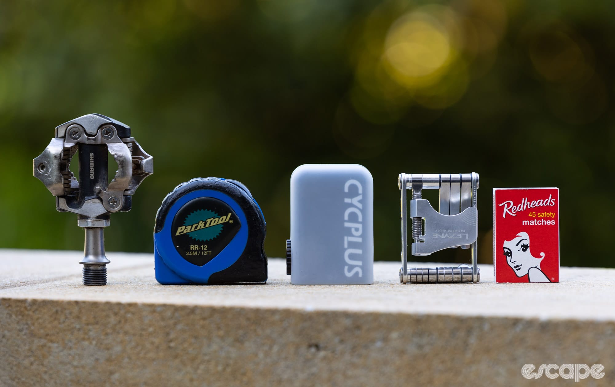

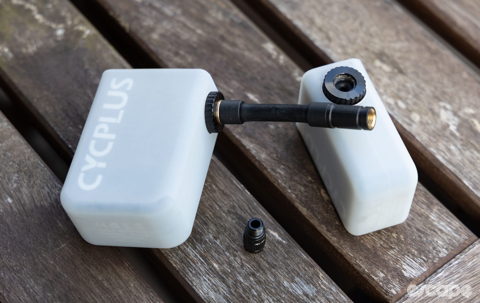

The Cycplus AS2 Ultra (centre) is one of the smallest pumps on the market. Here are some items for scale. Yep, these things are now tiny.
The smallest size category, which I’m designating as Mini, is the newest category of inflators and the one that’s getting the most attention. I’ve defined this category as any inflator small enough to fit into the rigid confines of a large down tube storage area (Santa Cruz Stigmata used for test). In the case of pumps like the Trek Air Rush Mini and Viair Recon Mini, you’ll need to unscrew the valve head to do so, but given its simple and designed to do that, I've counted them. Anything bigger than this, or with an awkward shape (such as the Flextail Mini), does not qualify for this Mini size.
Two years ago, this smallest size category had fewer than five options, and all without pressure gauges. Things changed quickly and now all but two pumps of this size have gauges. The best in this category will inflate a tyre to pressure in approximately one minute (specifics shared later), do it 3-4 times on one charge, and all with an accurate gauge – meaning that these pumps could be the only pump you need for before and during the ride, and regardless of whether you ride road, gravel, mountain bike, or whatever.

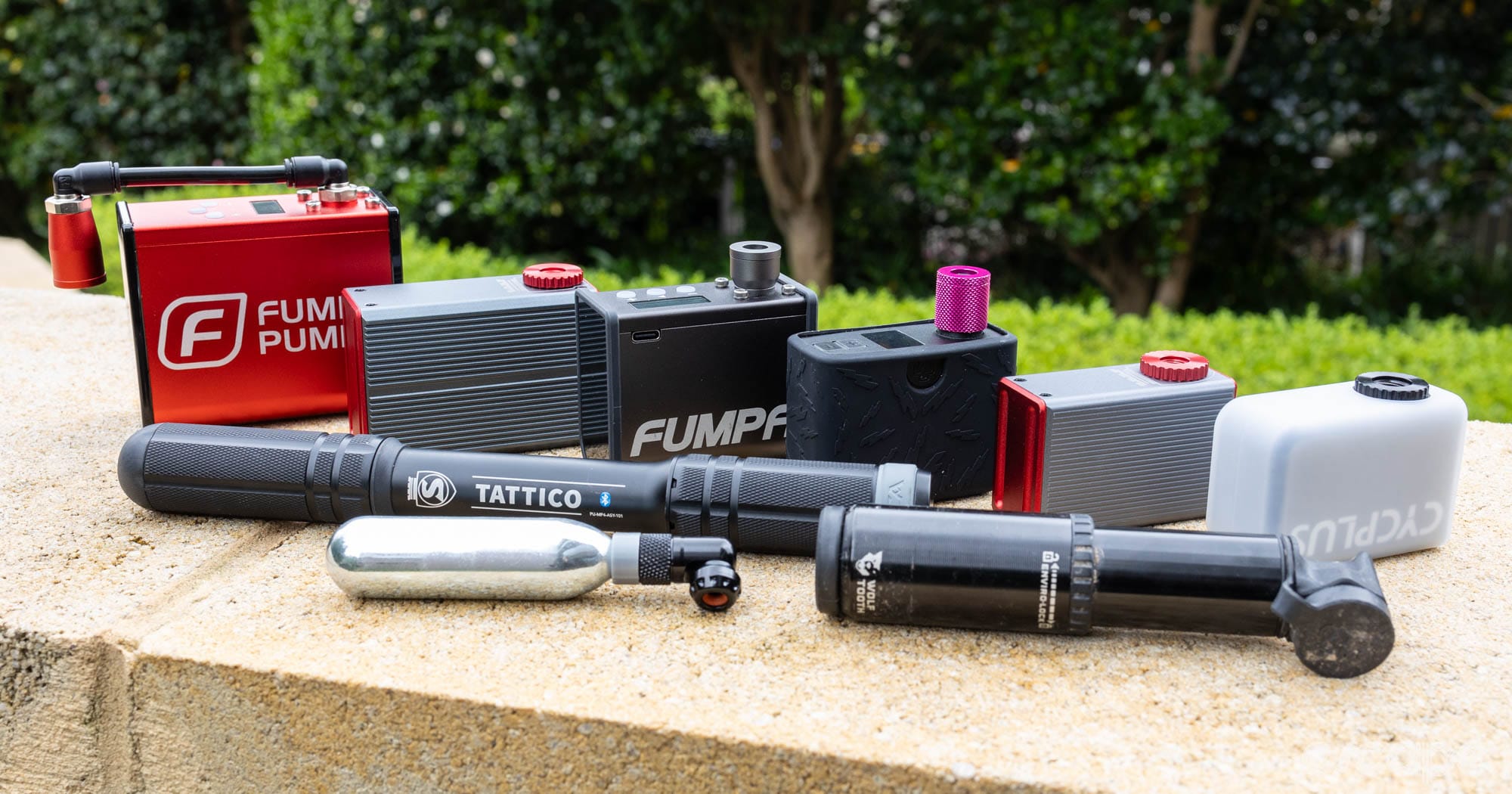

An example of the size range on test. The three inflators on the right are in the Mini category. The next two next to those are in the small-size category, while the red Fumpa pump on the far left is a medium-size pump. All fit in your hand.

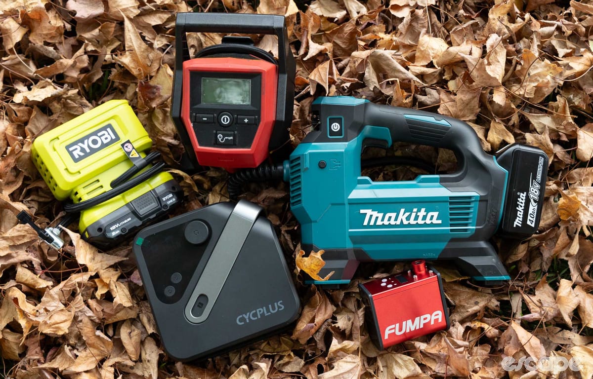

Lastly, there's the workshop size of inflator, one I’m classifying as Large. Think of brands such as Milwaukee, Makita, and Ryobi that fill this space – often powered by a drill-type battery and now a common sight amongst WorldTour mechanics. The likes of Fumpa and Cycplus now have larger versions with integrated batteries, too. These aim to fill tyres quickly and do it many times off a single battery charge. I consider these to be far too big to ever consider taking on a ride, and often even too big if you were to fly with a bike. I've reviewed these large-sized electric tyre inflators separately.

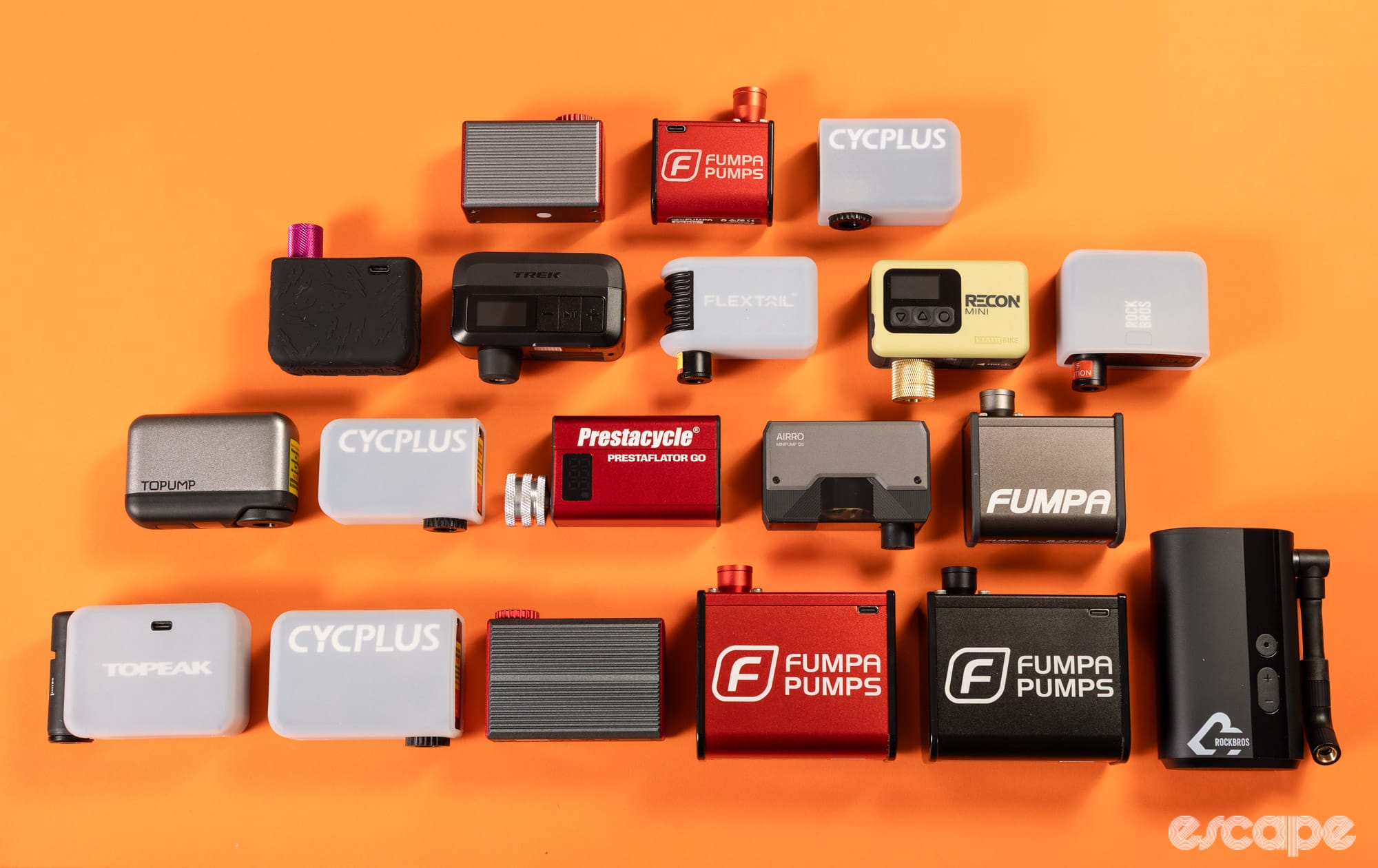

Looking at the photo below may have you pondering how similar some of these inflators are to each other. The short answer is "very".
Many of these pumps have plenty in common.
Like many product categories in cycling, there are just a small handful of specialist manufacturers who produce these for a swath of brands. All the pumps in this test are manufactured in China, except Fumpa, which is made in Australia (using some Chinese-made parts).
Sometimes the pumps are only different by the brand name stamped on them, but more often, back-to-back testing of identical-looking pumps does reveal subtle hidden differences, such as how they draw power from the battery which can result in differences in run-time, speed of inflation, heat build-up, and noise. For example, Silca’s pumps are manufactured by Cycplus, but its Electtrico Ultimate performs subtly differently from the most comparable Cycplus model.
