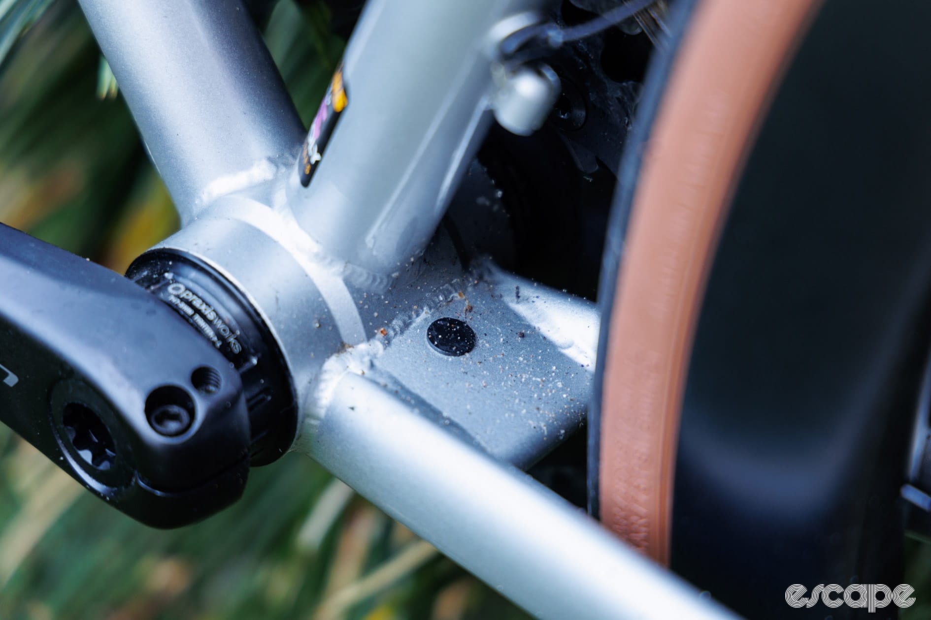

If you know you’ve just had a flat, and have some water in a bidon to spare, then a quick rinse is the best approach. Whether sprayed on your sealant-marked clothes or bike, it will almost certainly solve the problem before it begins.
Even a small mess like this is a quick fix while wet.
Failing that, washing your bike and/or clothes as soon as you get home should do the trick, too. Whether it’s a sponge bath or the caress of a baby wipe, it should be enough. In my effort to test the efficacy of these tyre sealant removers, I was surprised to find that it took the sealant some 48 hours before it had dried onto paint in a stubborn way. You've got a window multiple hours wide for when a quick rinse of water will be a sufficient fix.
