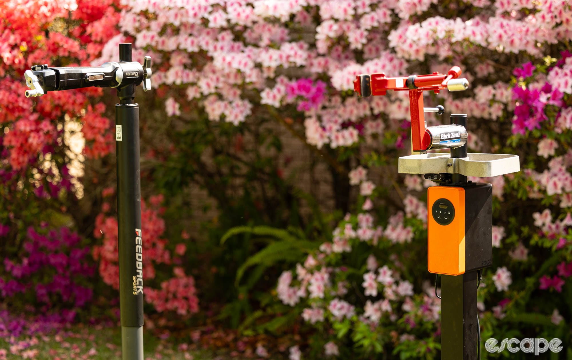

Both the Remco Bike Lift and Feedback Sports Pro E Lif are workshop-style repair stands designed for indoor use where you have a dedicated area for tuning, tweaking, and assembling bikes. Since they're electric, you’ll need a way to plug them into a standard household power outlet. That’s a big departure for Feedback Sports as all of its previous stands were foldable and made with transport in mind – though there are still elements of that here.
Both stands are of the workshop clamp variety, meaning they’re designed to hold a bike by the seatpost. You can also use a frame clamp adapter such as the Silca Hirobel if you want to grab something other than the seatpost. Clamping the frame with a stand like this is never recommended unless it’s thick-gauge steel and unpainted.
Feedback Sports Pro E Lift on the left, Remco Bike Lift on the right.
The Feedback Sports stand comes as a turn-key product that includes its own integrated base and clamp, with the whole kit and caboodle retailing for US$1,250 / AU$1,900 / £1,300.
Things are significantly more complicated with the Remco. Remco initially designed its Bike Lift stand to be an upgrade for the thousands of shops and home mechanics who already owned a Park Tool PRS workshop-style stand. If that’s you, Remco offers just its electrical Bike Lift column at US$645 / €720 / AU$TBC, which would then sit between the old Park Tool steel base (or floor mounting plate) and clamp assembly.
Of course, Remco also offers all the other pieces you may need if starting from scratch, including its own steel base and a variety of pro-level clamps from Efficient Velo Technology, Unior, and Feedback Sport. A stand, with Remco’s steel base, and an offshore-manufactured version of EVT’s wonderful Right Arm Clamp (Field Unit Edition) retails for US$1,244 / €1,432 / AU$N/A.
Remco offers its stands in a number of configurations with a growing list of optional add-ons and more premium pieces (such as the Heavy-Duty Chuck Adapter, not pictured).
Neither stand includes a tool tray, but both offer them as an add-on. Feedback Sports has two new options to choose from, costing either US$30 or US$50 (covered in Threaded #49). Remco’s stand can be used with Park Tool trays or its own premium offering (US$120).
Winner: It’s a draw. While the Remco is cheaper for those already with a fixed Park Tool workshop-style stand, it’s on par if you need a base and clamp.
