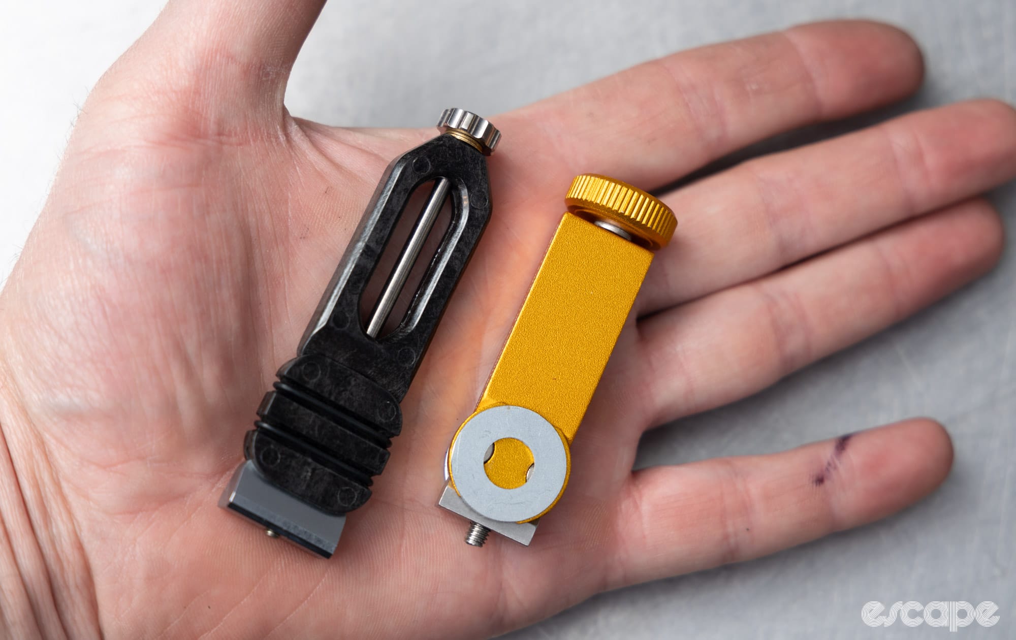

I've covered the topic of pressing pistons before, and there are an increasing number of tools for the task. AbsoluteBlack (second from the left) has joined the likes of Sumart (far left) in offering a tiny threaded tool that expands to press pistons back squarely and safely.
Let's focus on how it compares to that Sumart UBB-20 tool. The two tools are extremely similar in concept and price, but wholly different in execution. AbsoluteBlack's use of a carbon fibre-reinforced composite actually makes good sense for a tool that will be pushing on ceramic pistons (Shimano) and that you want to be non-marring. Meanwhile, the use of a titanium bolt is just because they can.
As covered previously, the Sumart tool does the job, but I don't like how it's held together magnetically and can fall apart quickly. By contrast, the AbsoluteBlack tool fixes this with a design that's all contained together by o-rings. Truly a great improvement.

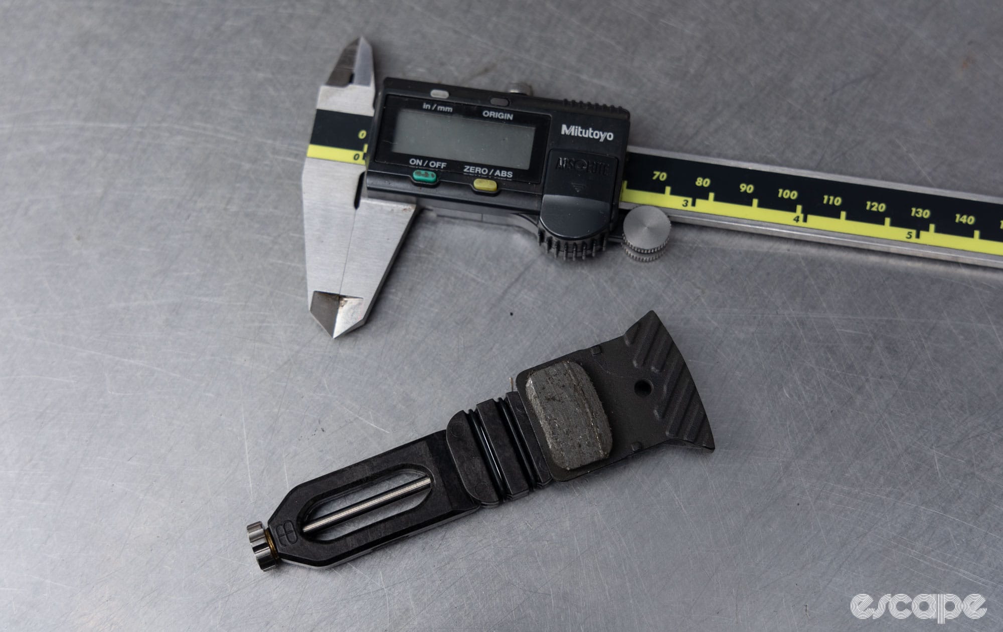

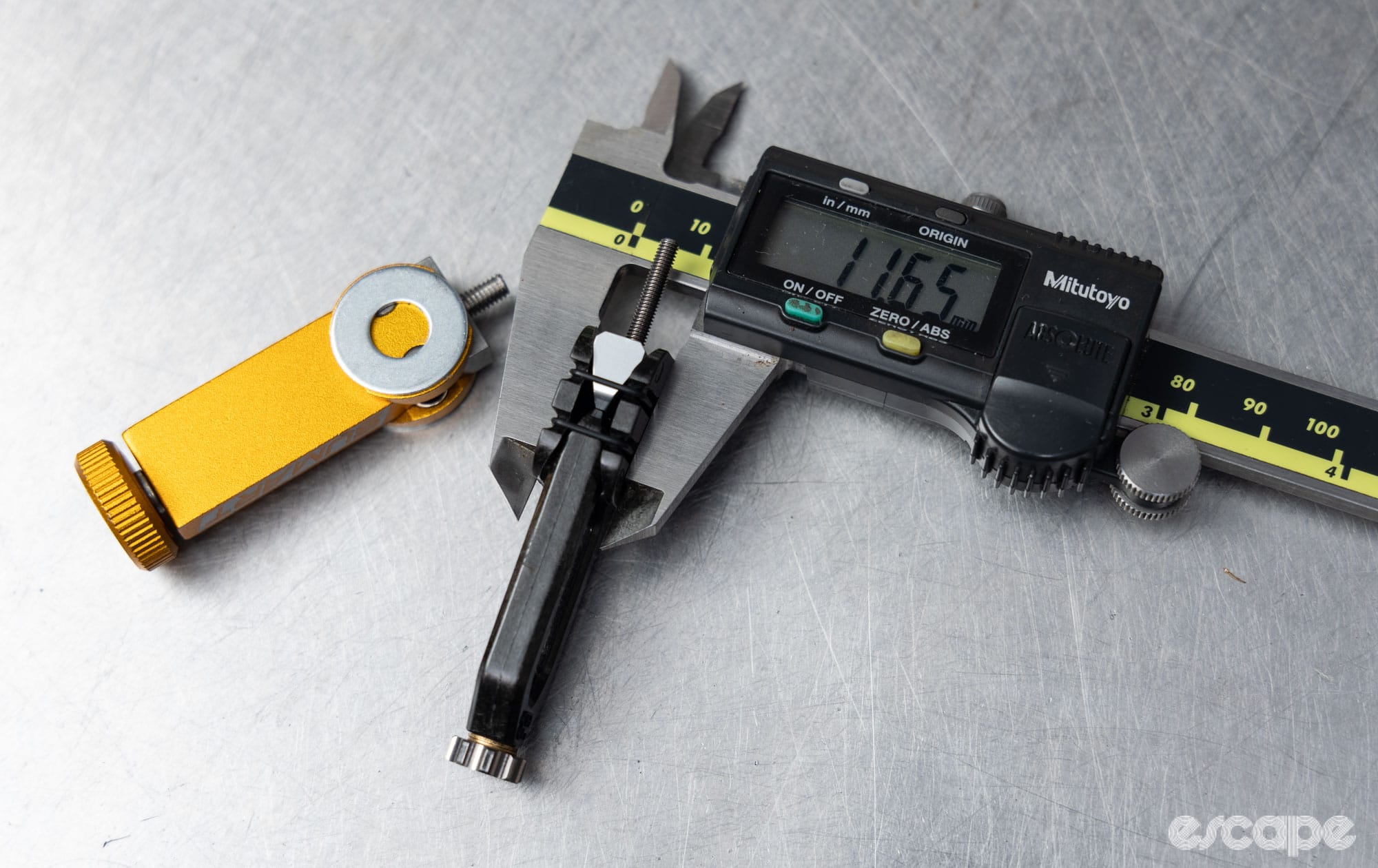

Dimensionally, the Sumart tool is arguably a little more versatile in the brakes it'll fit. The Sumart tool has a minimum piston gap thickness of 6.32 mm, while the AbsoluteBlack is a bit thicker at 6.96 mm. Less can be advantageous when doing a piston clean with certain brake models.
At the opposite end, the Sumart expands out to 12.34 mm (with provided steel washers), while the AbsoluteBlack grows to 11.65 mm. That figure is right on the edge for working on Shimano calipers, while more is needed for certain wider-gapped mountain bike calipers, such as SRAM Code.

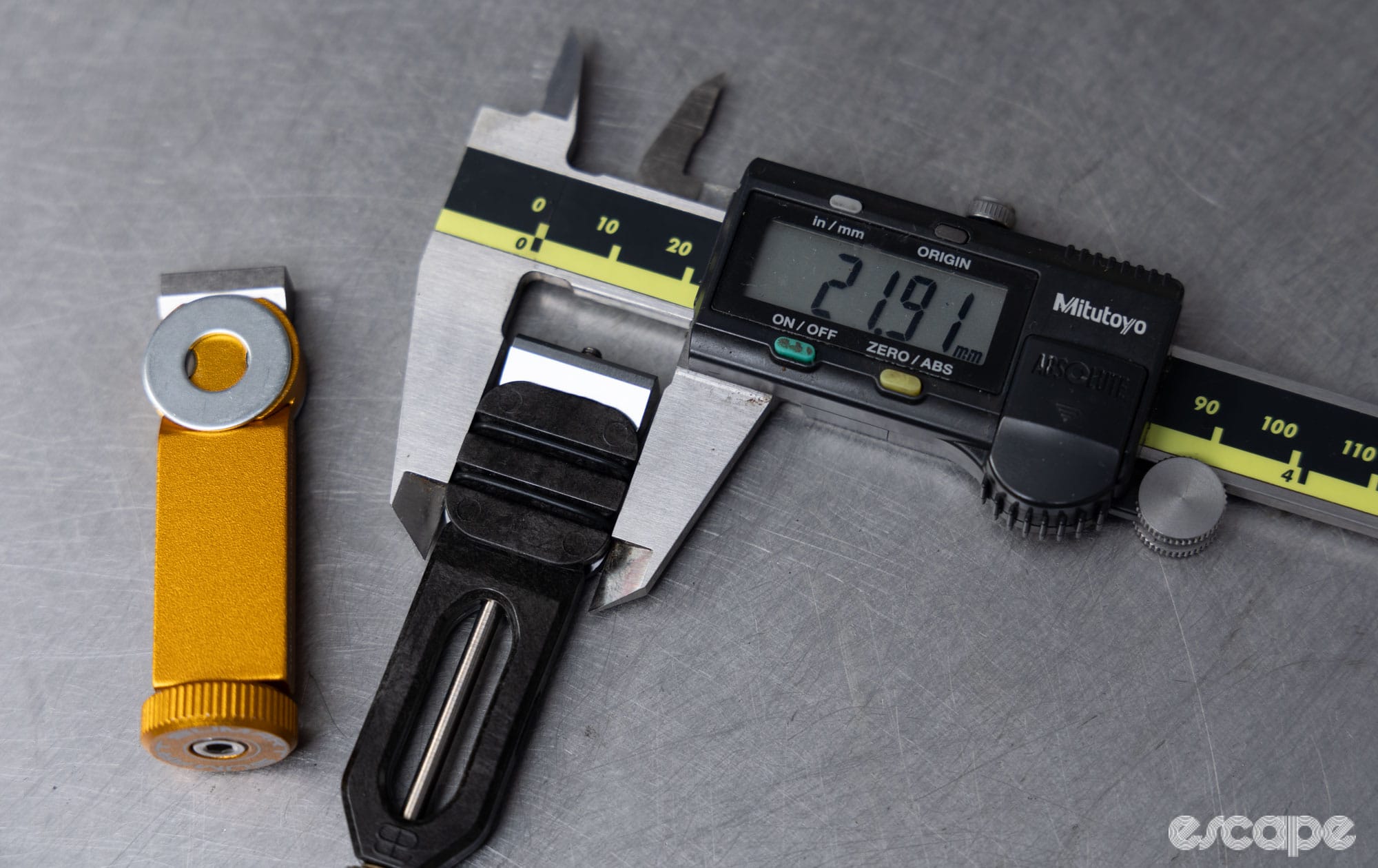

Then there's the difference in width. The Sumart has a width of 20.17 mm, meaning it’s more likely to fit into narrow calipers versus the greater 21.91 mm width of the Absolute Black. Still, both fit into most modern two-piston calipers from Shimano, SRAM, and Campagnolo.
Both the Sumart and AbsoluteBlack can be turned with your fingers or driven by a tool. The larger thumb screw on the Sumart is superior here and more comfortable to use by hand. Both of these tools require you to make many turns to expand and collapse them but the thread pitch on the AbsoluteBlack is even finer, so it takes longer. That fine pitch can have these tools feeling inefficient in a workshop setting (unless you're driving them with an electric screwdriver, wheeee!).
Pedantic sizing differences aside, the tool fits well in the type of higher-end calipers that AbsoluteBlack customers will own (Shimano L05A road pad pictured). The tool works as claimed, but I think the unnecessary focus on weight has resulted in a tool that's not as comfortable (due to the small turning knob) or fast (due to the fine thread pitch) to use as it should be. It improves on the popular Sumart in some important ways, but I'm not in love with it either. With that said, I still find myself more often reaching for a faithful Pedro's tyre lever. Old habits ...

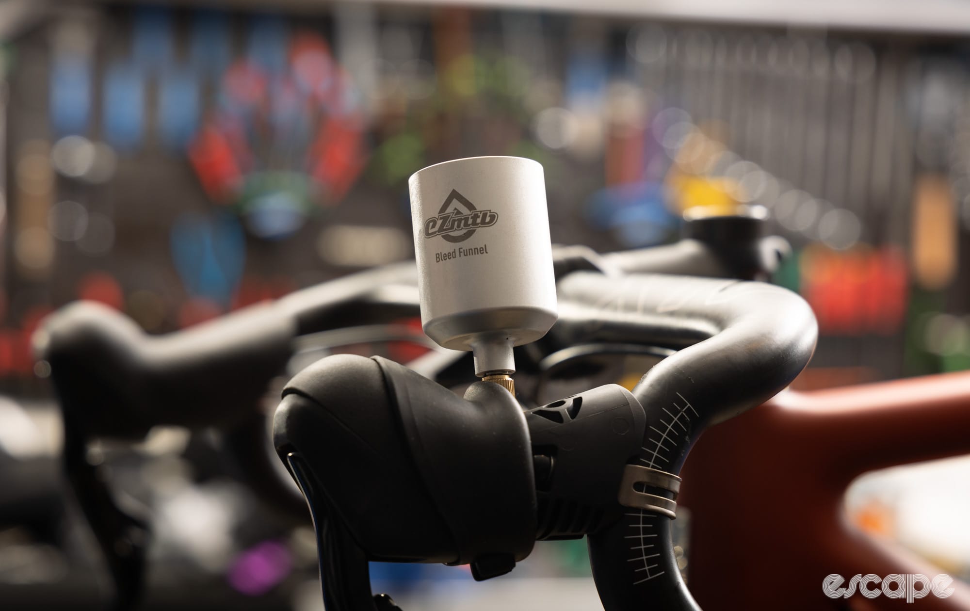

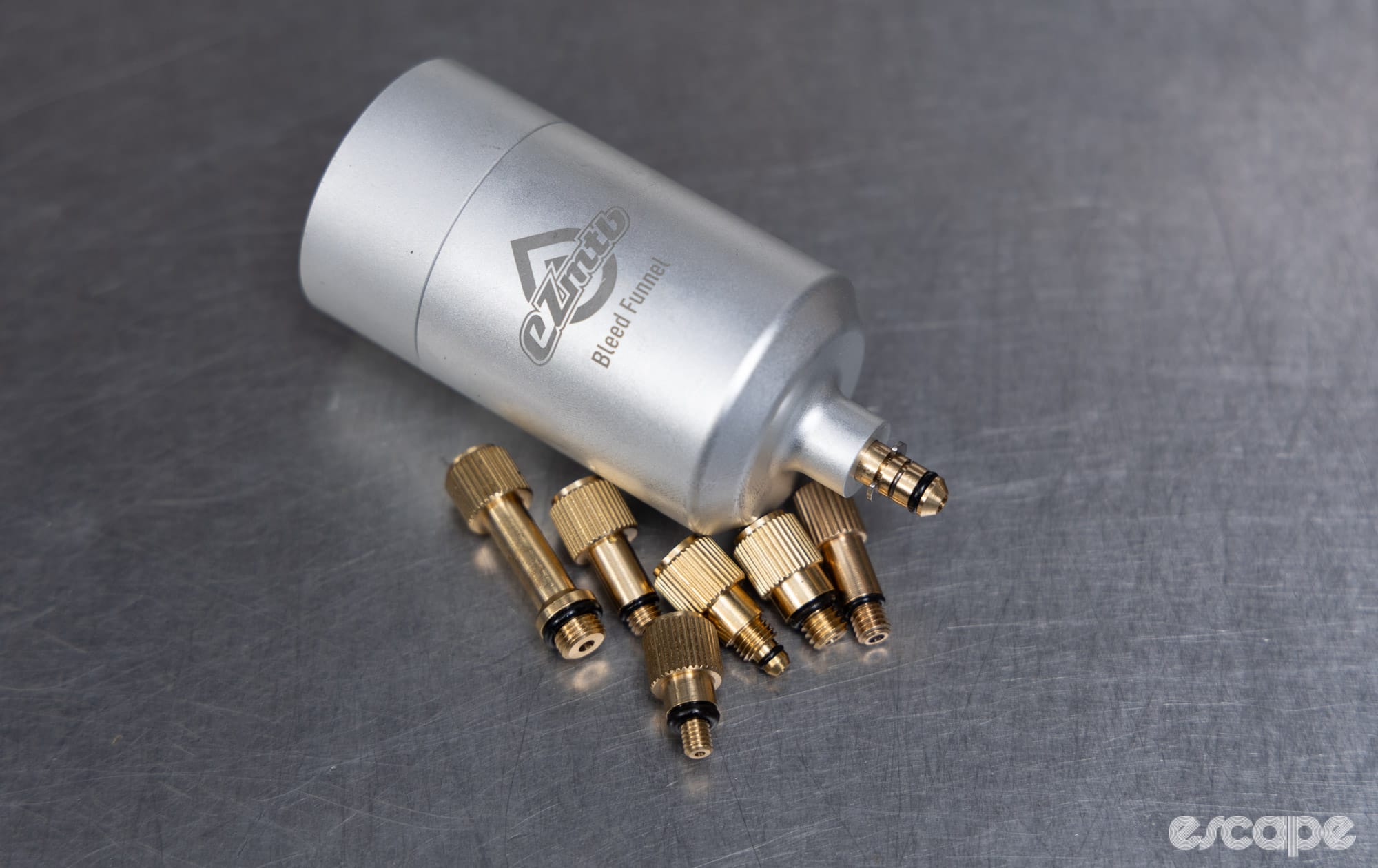

EzMTB got its start with budget and largely plastic bleed kits to suit all sorts of disc brakes on the market. A couple of years ago, the Chinese brand added a few products aimed at pro shops. One such product is the Pro Bleed Funnel, an aluminium bleed cup with a number of modular threaded fittings.
The full kit comes with brass fittings for common M4, M5, M6, M7 (long length) sizes. In Australia, this set retails for AU$60 (US$40 via AliExpress).

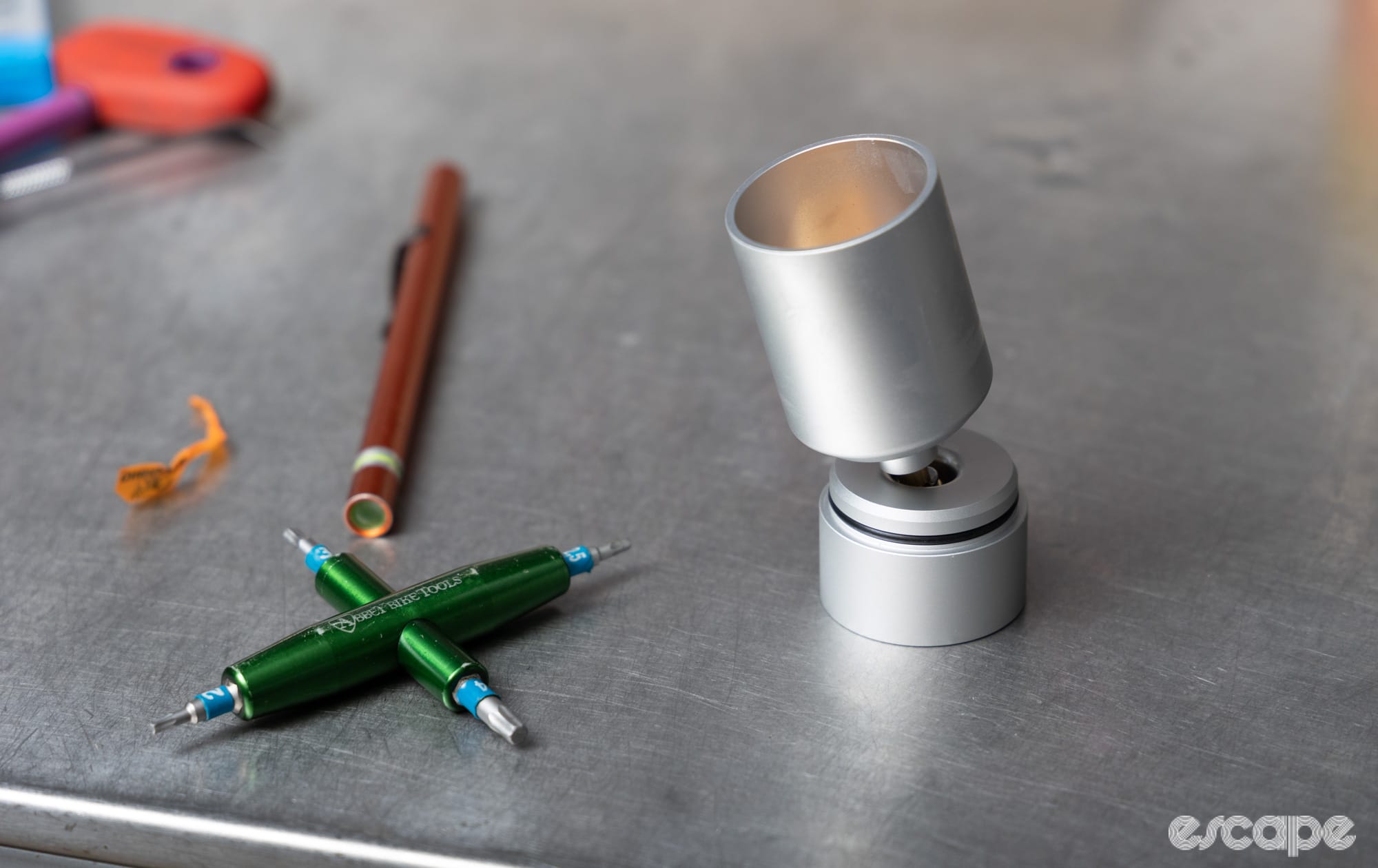

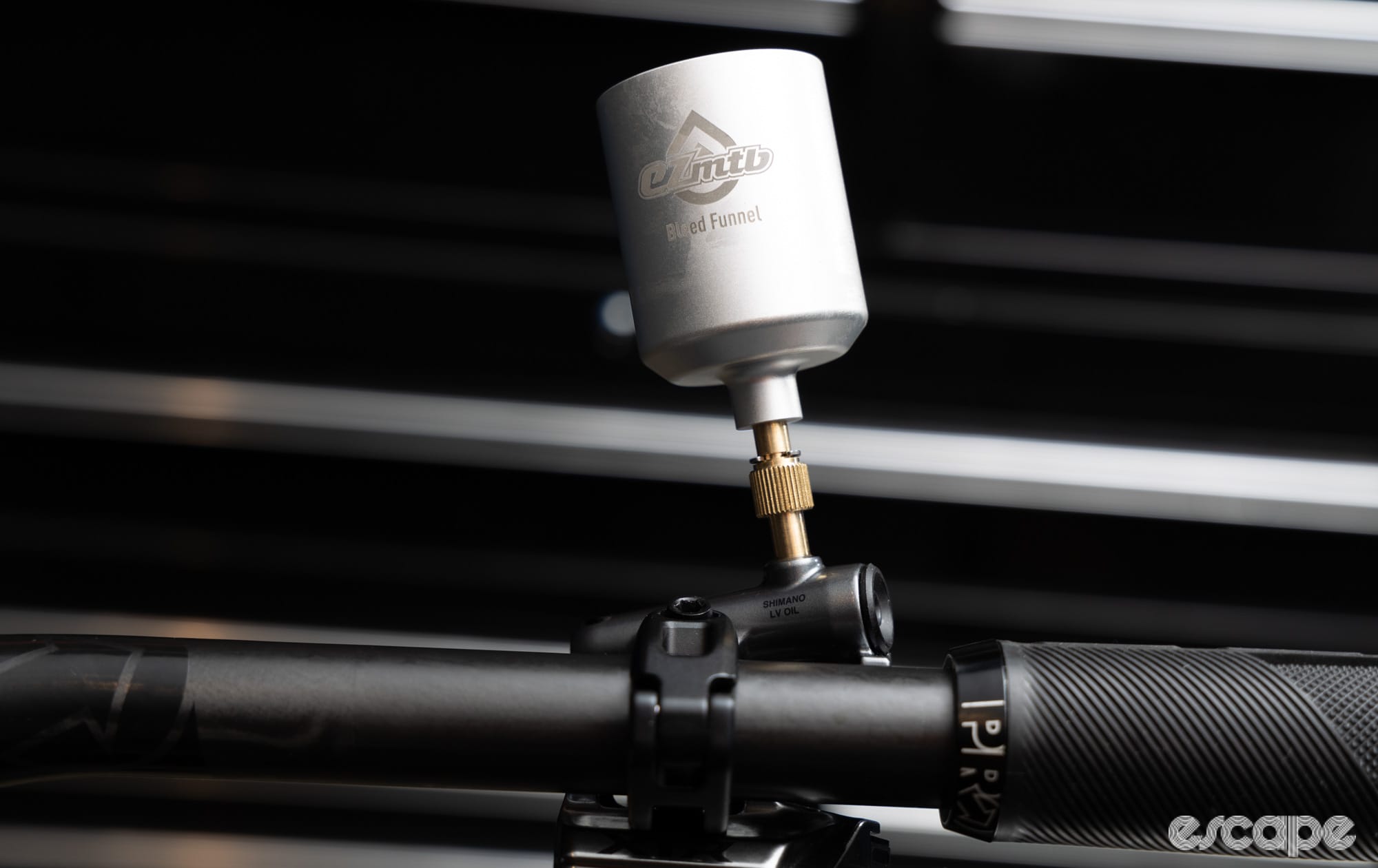

The weighted lid has a seal on it, and it doubles as a stand. Although that stand could be a little deeper in order to keep the cup upright when a threaded fitting is in place.

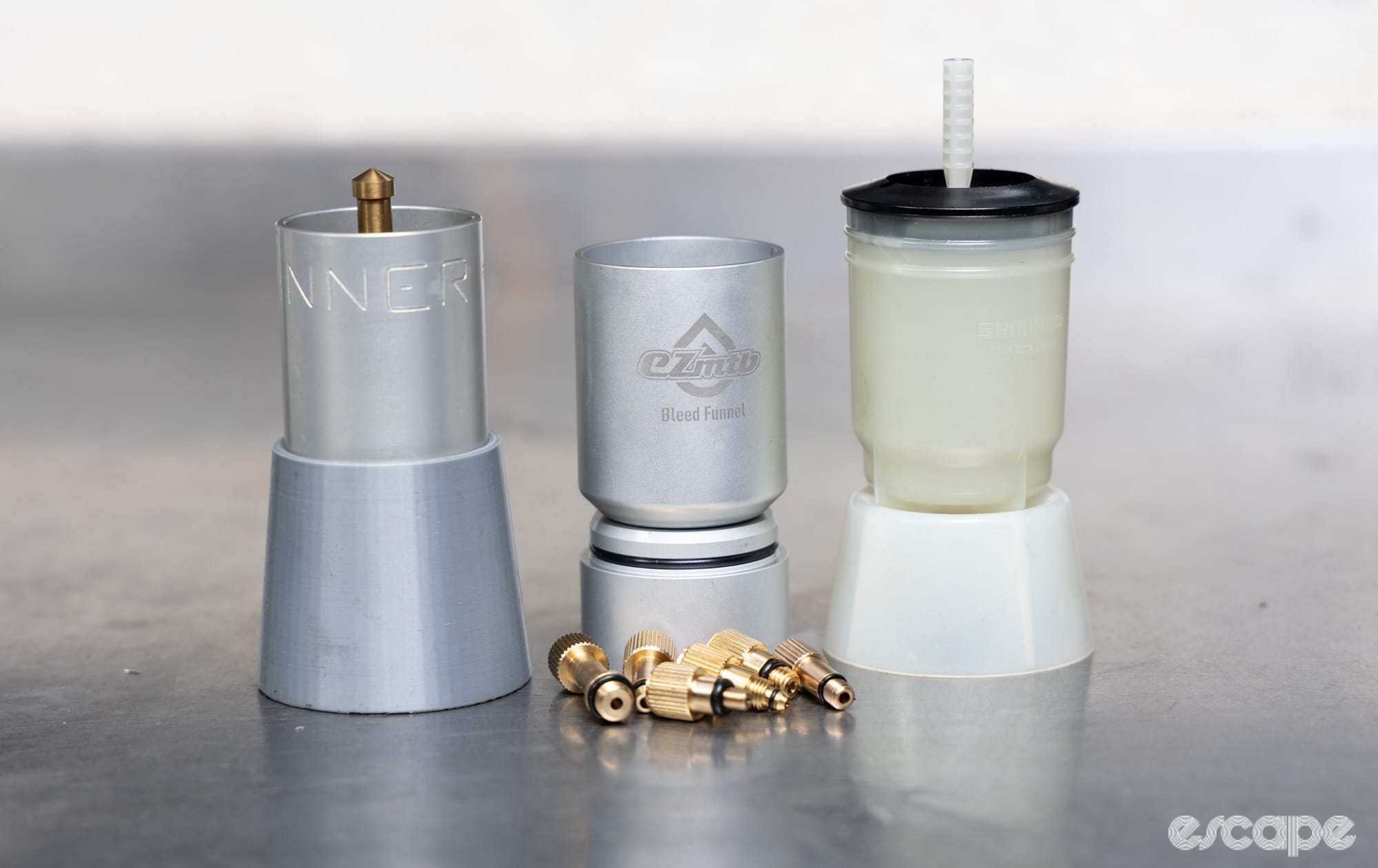

EzMTB is certainly taking some design cues from the likes of Pinner (left) and Hope (not pictured) in offering a metal bleed cup. Meanwhile, Shimano (right) sticks with plastic, which offers a bit of translucency.

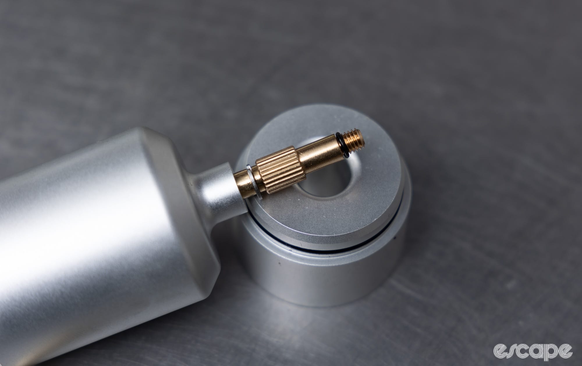

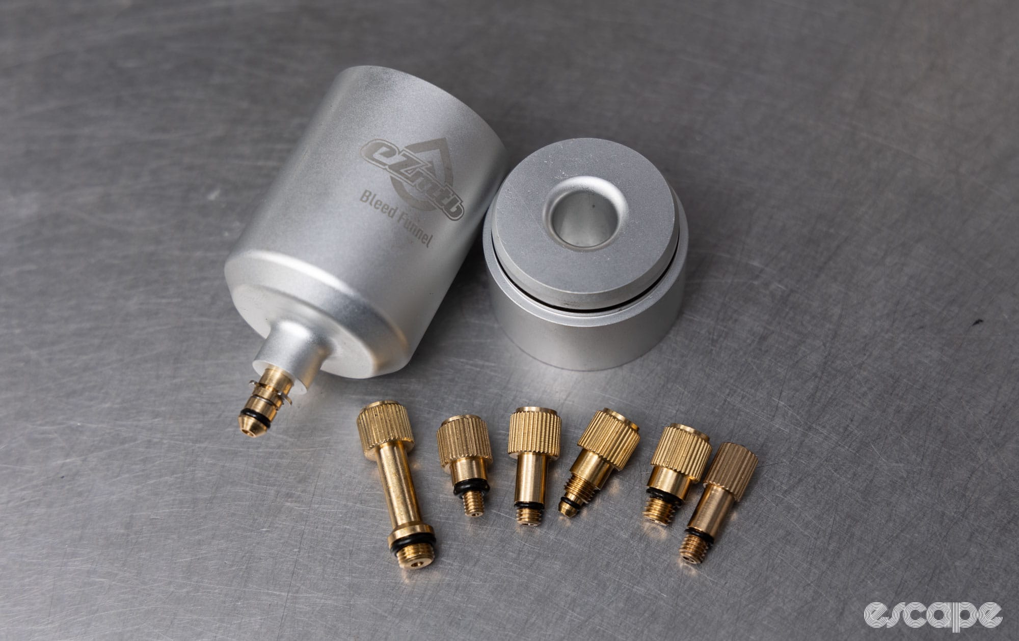

Those threaded inserts are a little fancier than you might think. The bleed cup slip fits into each fitting, with sealing handled by a small o-ring. So you can thread in the fitting, and then simply push the cup into place.
Another clever detail is that the push fitting is also a plunger. Where Shimano has a plug that seals the contents, this cup opens when pushed into place and seals itself when pulled up.

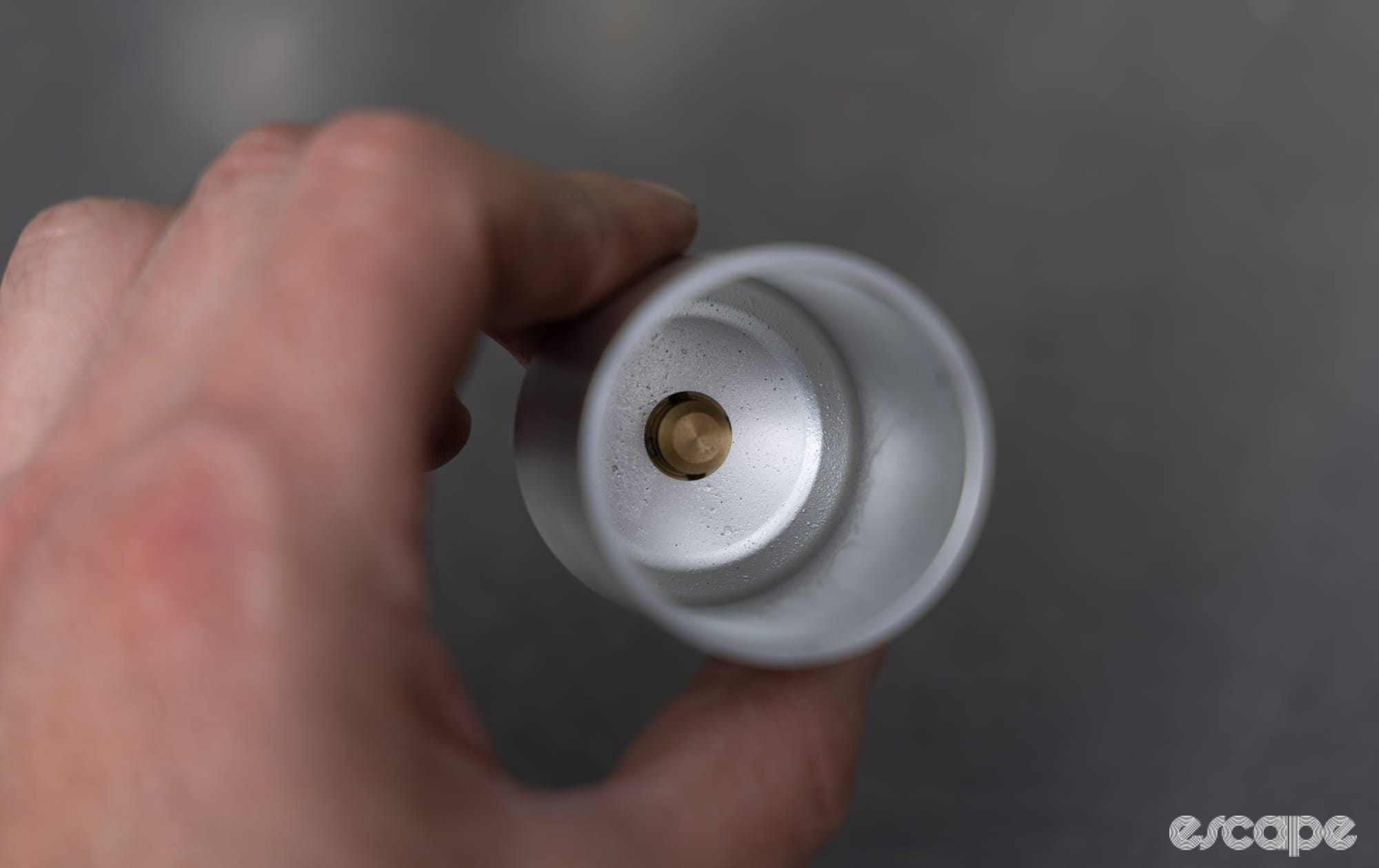

It works well, but such small o-rings never last forever. With regular use, that plunger system will clog, or the seal will degrade. Also, it prevents you from looking down into the cup and spotting air bubbles hanging on for dear life within the master cylinder – something I always do when using a Shimano bleed cup.
Overall, a cool product at a fair price that has a few neat features. Still, with a few extra moving pieces this is one that'll need occasional maintenance. Also, for Shimano road brakes, I keep returning to Shimano's larger-volume plastic cup with its anti-spill open lid, translucent material, and a straight view into the fluid reservoir below.

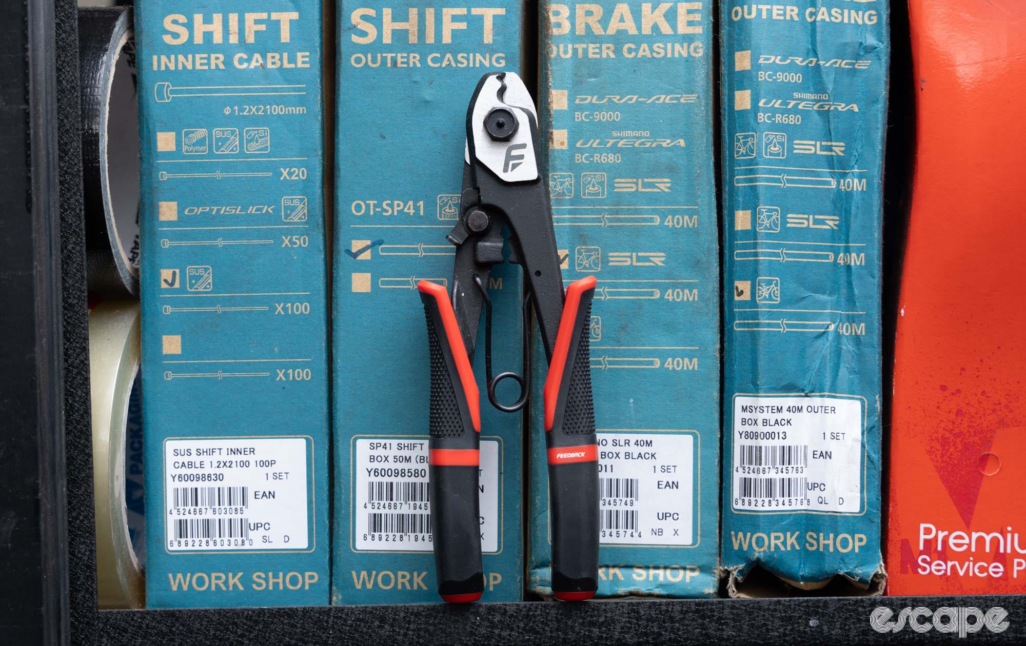

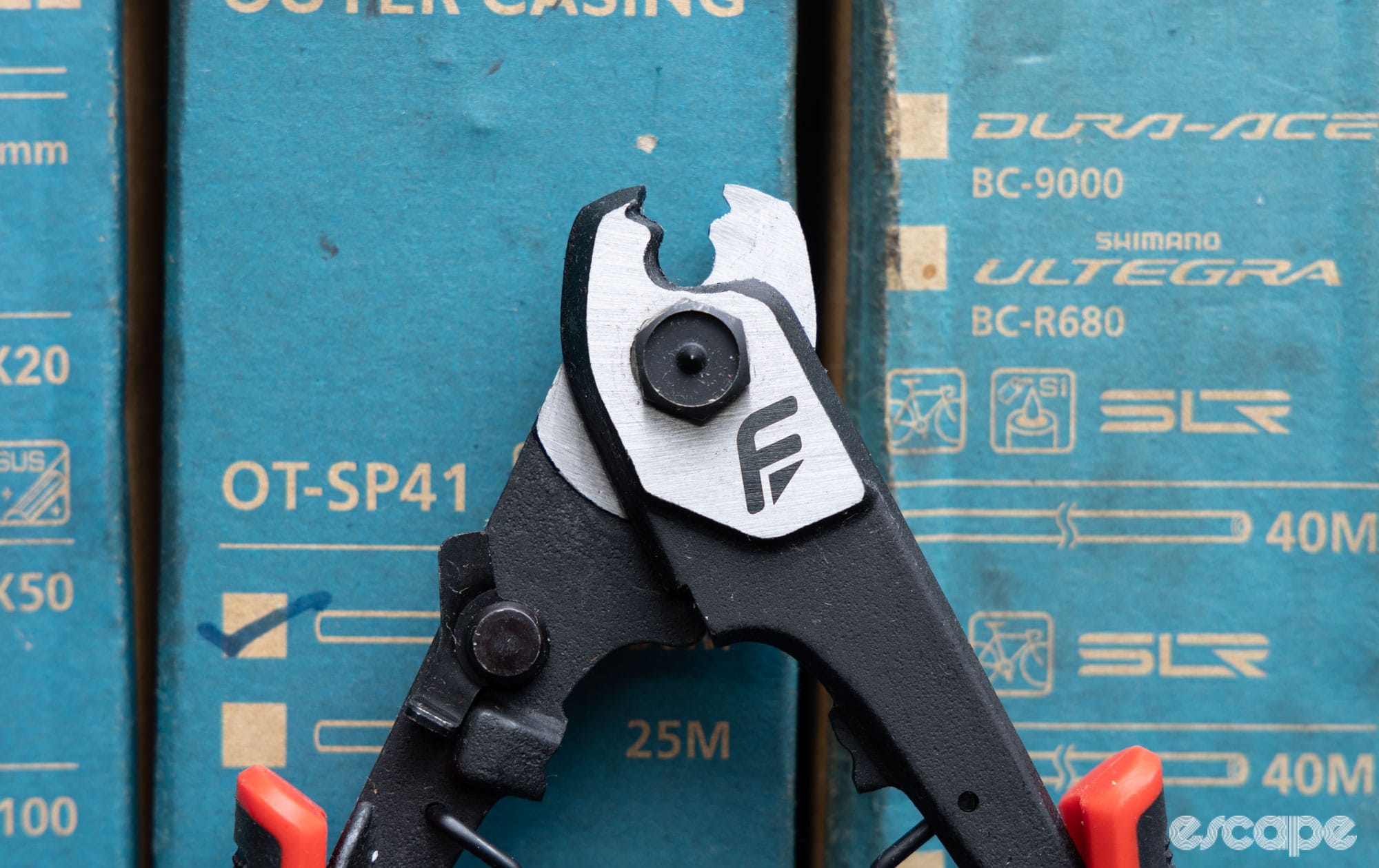

Feedback Sports has been slowly updating many of its hand tools, and the most recent to get a makeover is the new Cable and Housing Cutter 2.0 (US$45). The Colorado-based company recently sent me one to try out.
A key feature of this new cutter is that it has two cutting jaws – one for inner cables, and the other for outer housing. I've used two different cable cutters for years and so this tool speaks to me.
New (left) with old (right). The new Cable and Housing Cutter is a big step up in quality and features.
