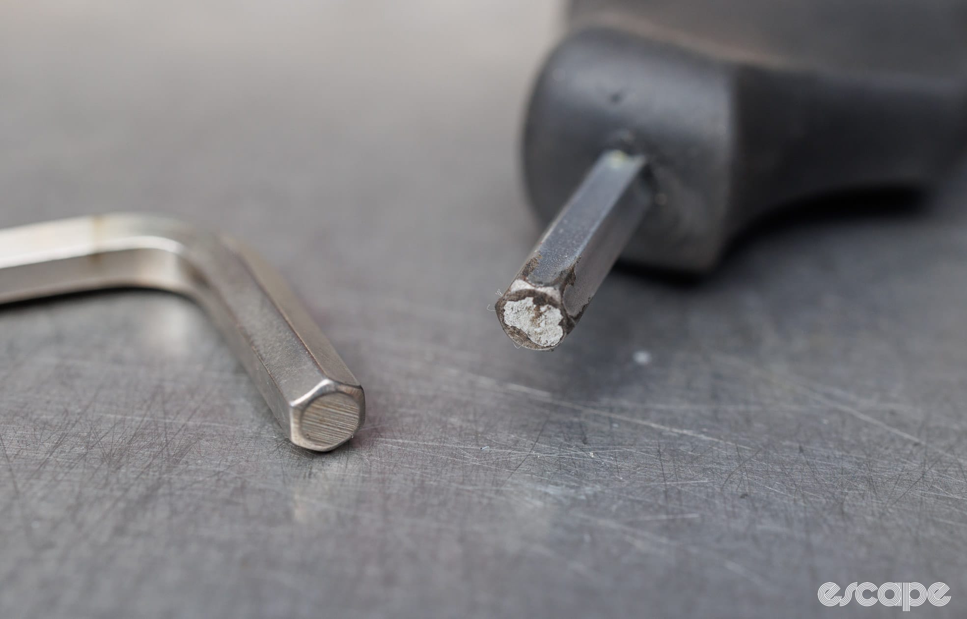

Your most commonly used types and sizes of hex keys would be first on the list to check, simply because they’re the most-used tool in bicycle repair. “Compare the very ends to new ones or unused ones, and replace if you see (or can measure) any wear,” says Calvin Jones of Park Tool.
“Worn tools just cost more time,” says Jason Quade, founder of Abbey Bike Tools. “Dull cable cutters require more housing clean up, worn hex keys are more likely to strip bolts, which in turn takes a lot of time to correct. Don't cut corners here – it will absolutely cost you more time when you are busy.”
Compare your tools against fresh ones.
On this, if you have some preferred hex or Torx tools that you know fit bolts snugly and securely, and then you have some keys (or bits) that worry you, get rid of the crap. If you find yourself rounding out bolts, then your tools or technique are almost certainly to blame.
Unfortunately, unlike measuring chain wear, there are no exact guidelines to tell when to replace tools. Some high-end tools will last users a literal lifetime, while it’s not uncommon for busy bike shops to go through multiple 4 mm hex keys (of a decent quality) in a season. Look for rounded or marred edges, a change in thickness, or a sense that the tool isn’t as secure as it once was.
“Tools can be used on a daily basis by a pro and not have issues for years and years,” says Truman Purdy of Park Tool. "If the tool was used by someone less experienced for the first time, it could have more wear after one use than after years of professional use, just because one knows the limits involved."

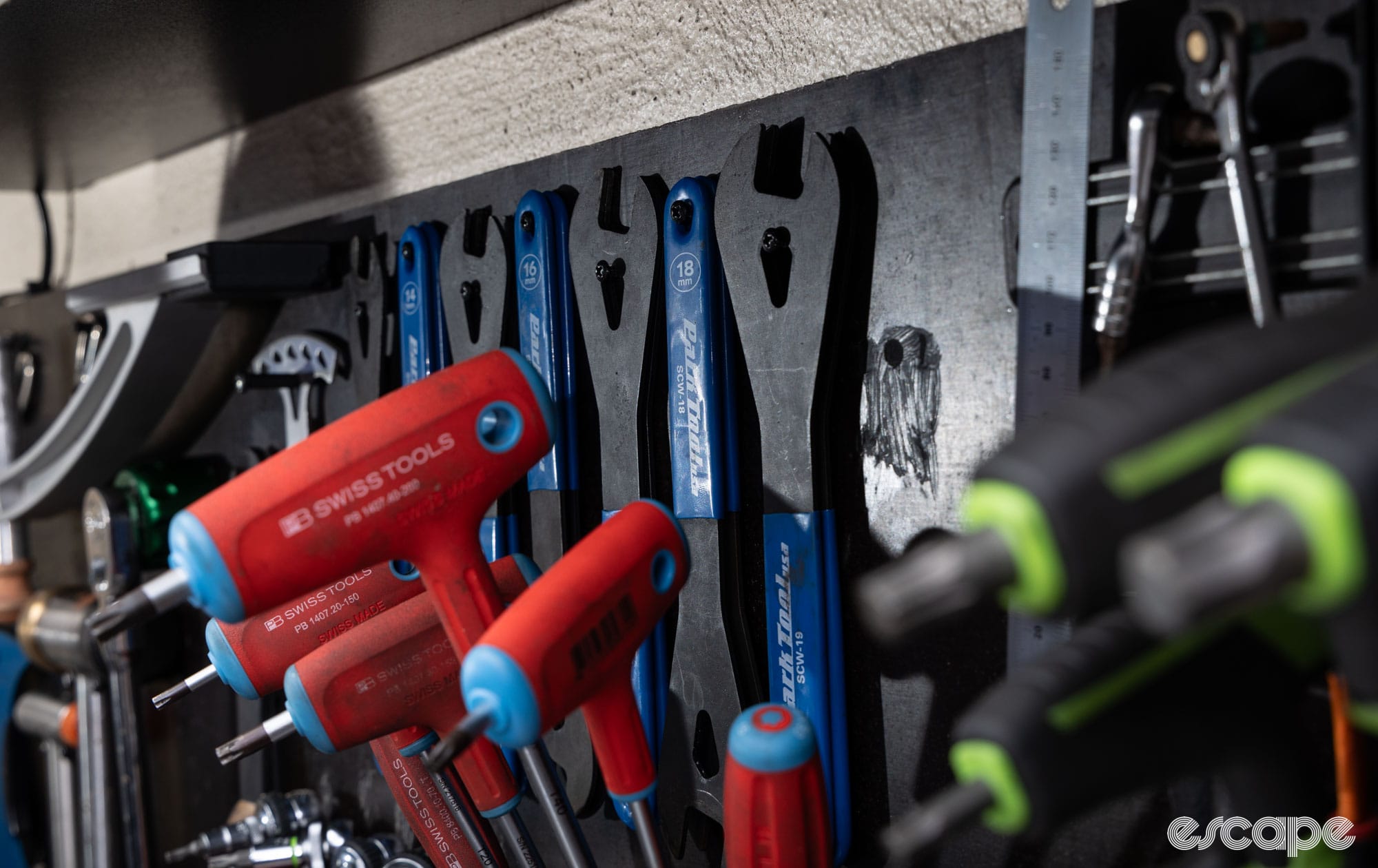

Open-ended wrenches, pedal wrenches, and even more specifically cone wrenches, can also wear out. “These must be thin to get into the narrow wrench flats of cones, but the torques are often high,” adds Jones. "That’s rough on a thin wrench. Inspect and replace as needed."
Specialist tools like cone wrenches can last a very long time if used correctly and as intended. However, they'll get damaged without care.

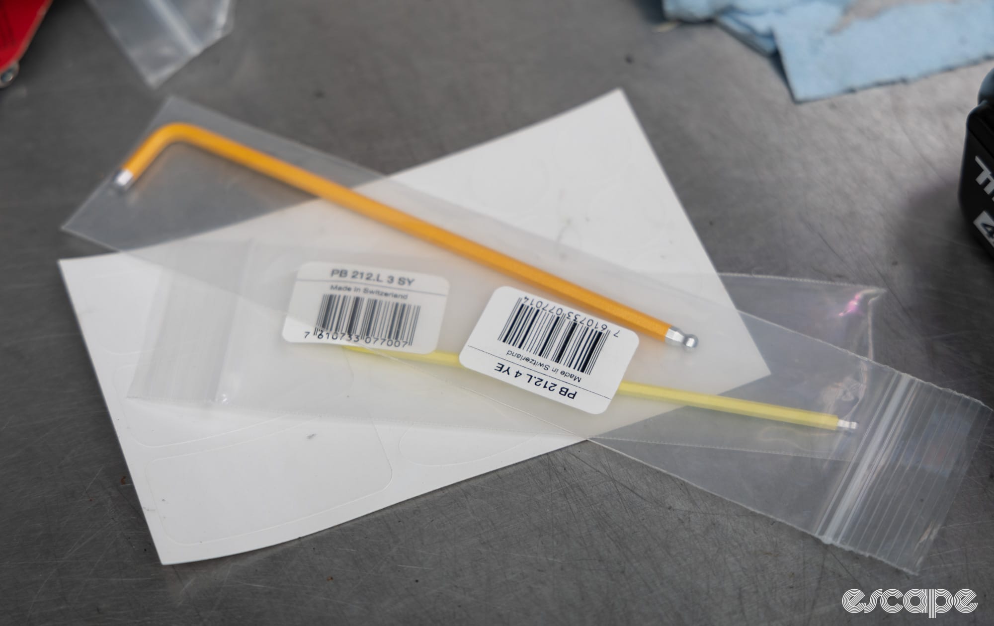

I’m forever advocating for the use of higher-quality tools. It’s not just that they’re more enjoyable to use (they are) or that they can often produce better results (they do) – they’re almost always more durable, too.
I'm an advocate for buying quality tools. An often overlooked benefit is that you can buy individual sizes to replace the most commonly worn (or lost) pieces.

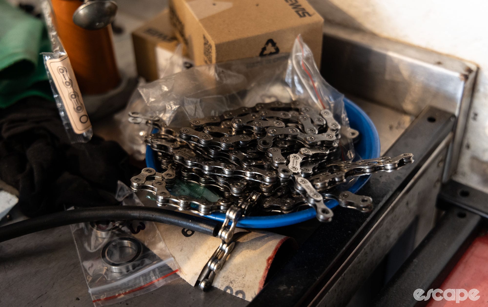

If you’re like me, you’ve probably got an increasingly large pile of small parts amassing in the corner of your workbench. Go on, you know you’ll be happier when all of that is cleaned up and cleared away.
I personally view bike mechanics as an elite level of hoarding. That tiny niche part that only works with that one older generation of Shimano derailleur may not be needed now, but maybe it’ll save the day in future. And oh yes, just this week I was reminded why I’d kept that old SRAM X7 left-hand shifter. Unfortunately, such self-justification can lead to quite a mess.
