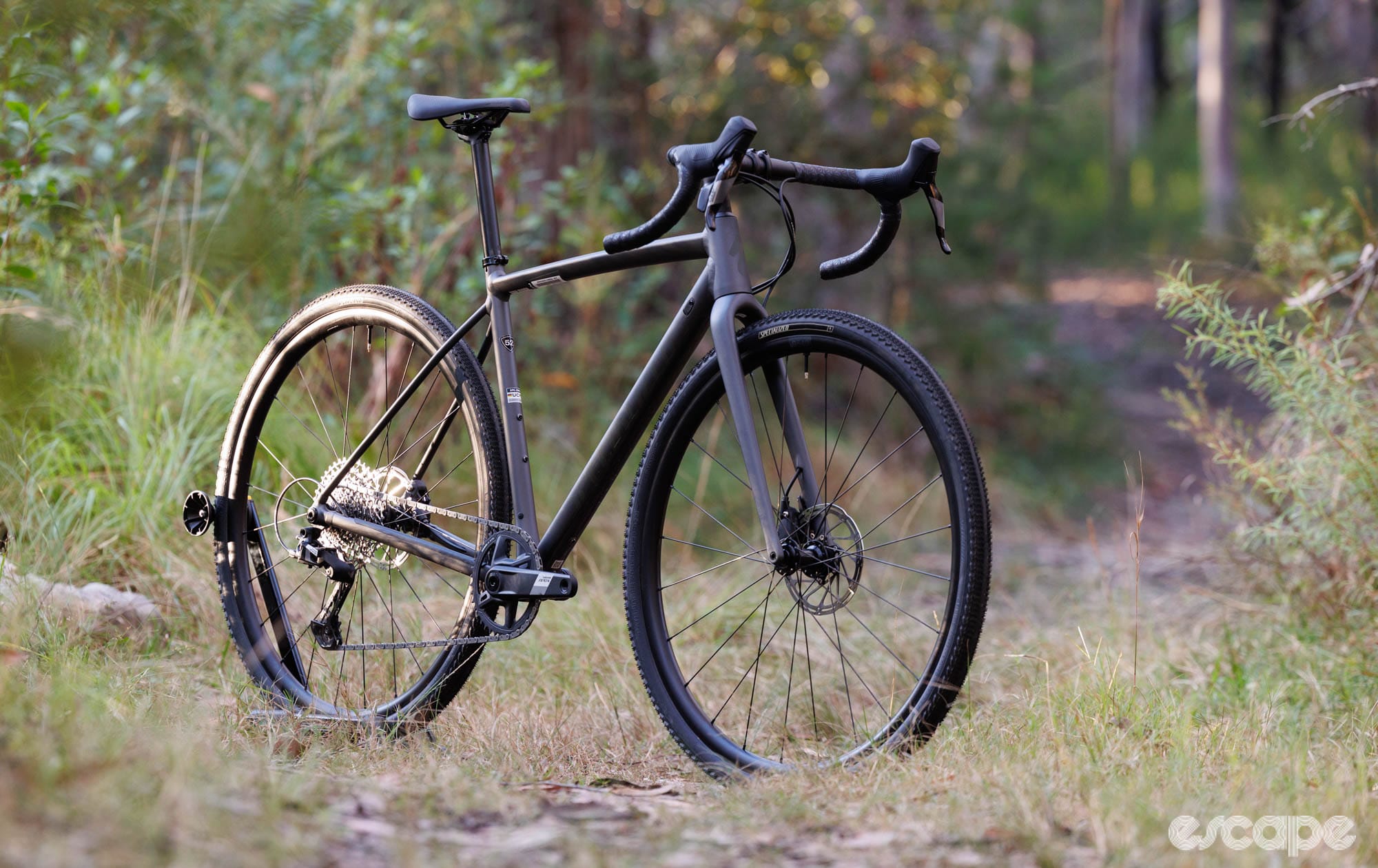

But there is no right or wrong trail figure. There are pros and cons to any decision on trail, and different disciplines require vastly different trails built into the bikes we choose for them. Gravel bikes, for example, will typically see much higher trail figures than a road race bike, the greater trail offering more straight line stability, whereas a road racer may prefer the more agile handling lower trail in their race bike. And then there’s the nuance in it all, where bikes with equal trail figures can still feel quite different due to other factors, but I digress.
