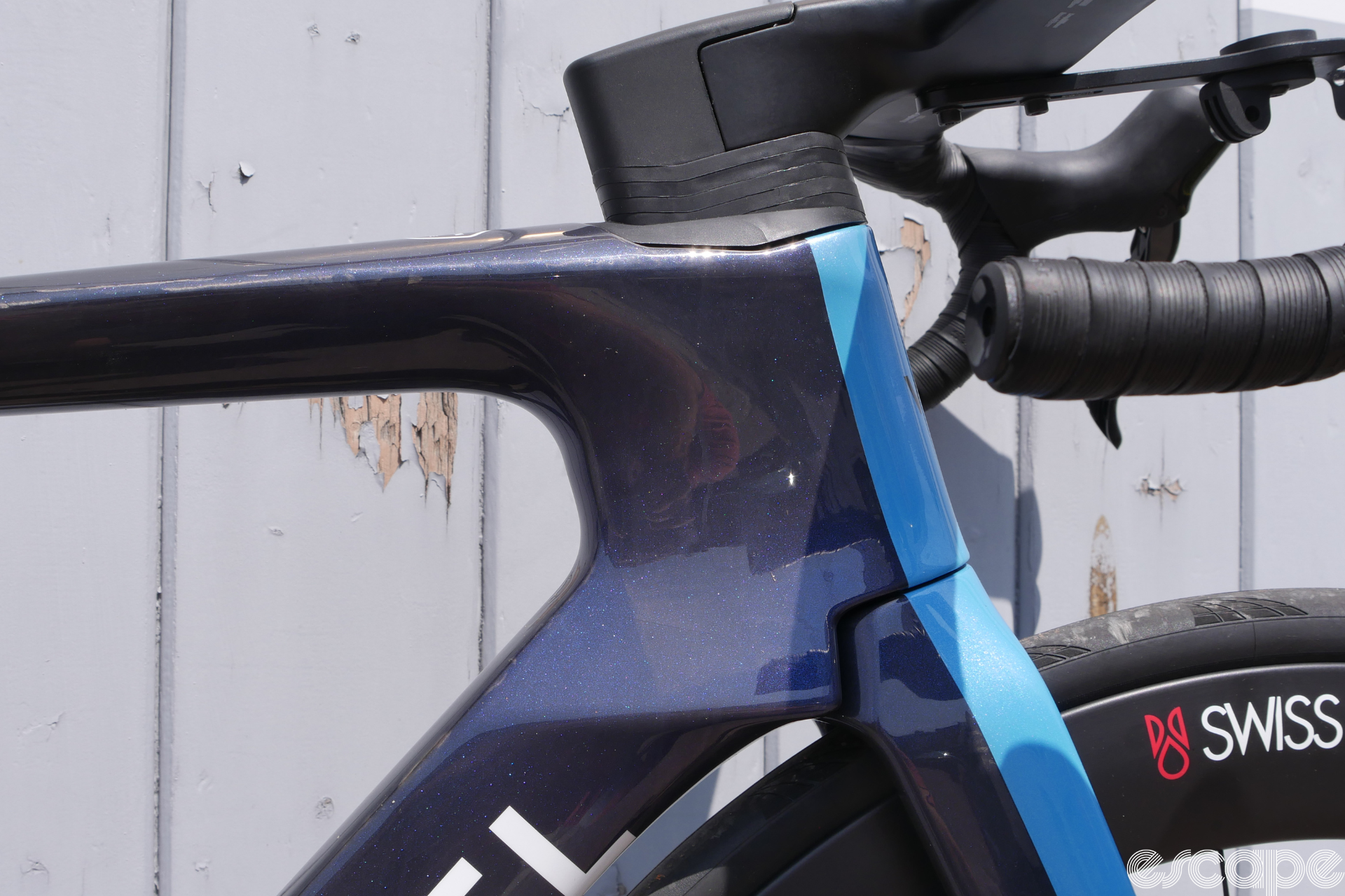

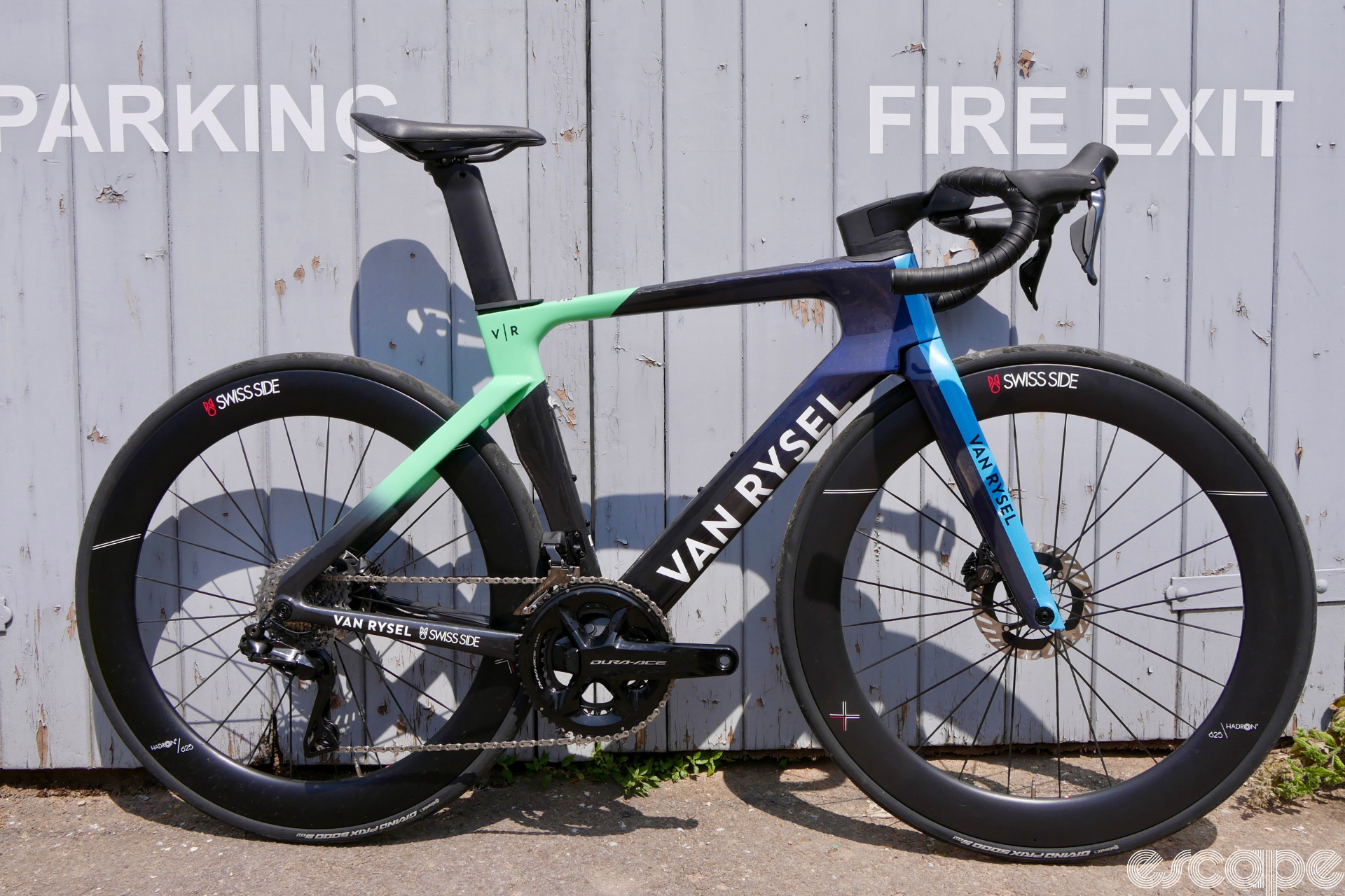

At its core, the bike is aggressive in its geometry, with deep aero profiles that make the most of the UCI’s aero regulations. There’s an aero-optimised head tube, dropped aero-profile stays, and a deep down tube. In this respect, at first glance, it has all the trademarks of an aero race bike.

The deep head tube, which smoothly flows into an equally deep down tube, makes the intentions of the bike abundantly clear. The RCR-F shares nothing with the silhouette of its RCR-R sibling. Where the RCR-R aims to be a jack of all trades, the RCR-F has one clear objective: to be as fast as possible through the wind.
The head tube is deep and short. Van Rysel says this design at the front end is responsible for a large proportion of the bike's aero improvement over the RCR-R.

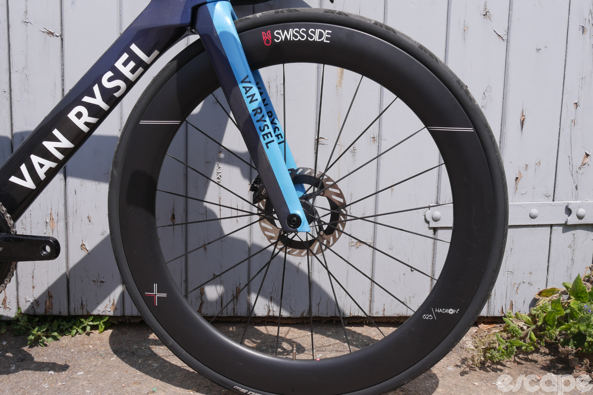

Compared to the RCR-R, the fork on the RCR-F is noticeably deeper in the hunt for drag reductions, but with it comes an increase in stiffness.

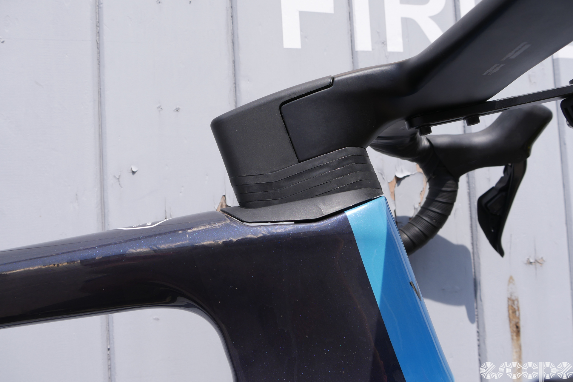

And then there is the riding position. Compared to the RCR-R, the stack is 11 mm lower for the same reach in my size. While Van Rysel leaves enough steerer for some fit adjustment, if you already run spacers, this will be a tough fit.
While the RCR-F does come with some level of stack adjustment, if you already have your bars raised, you might struggle to dial in the right fit on the RCR-F depending on the frame size you require.

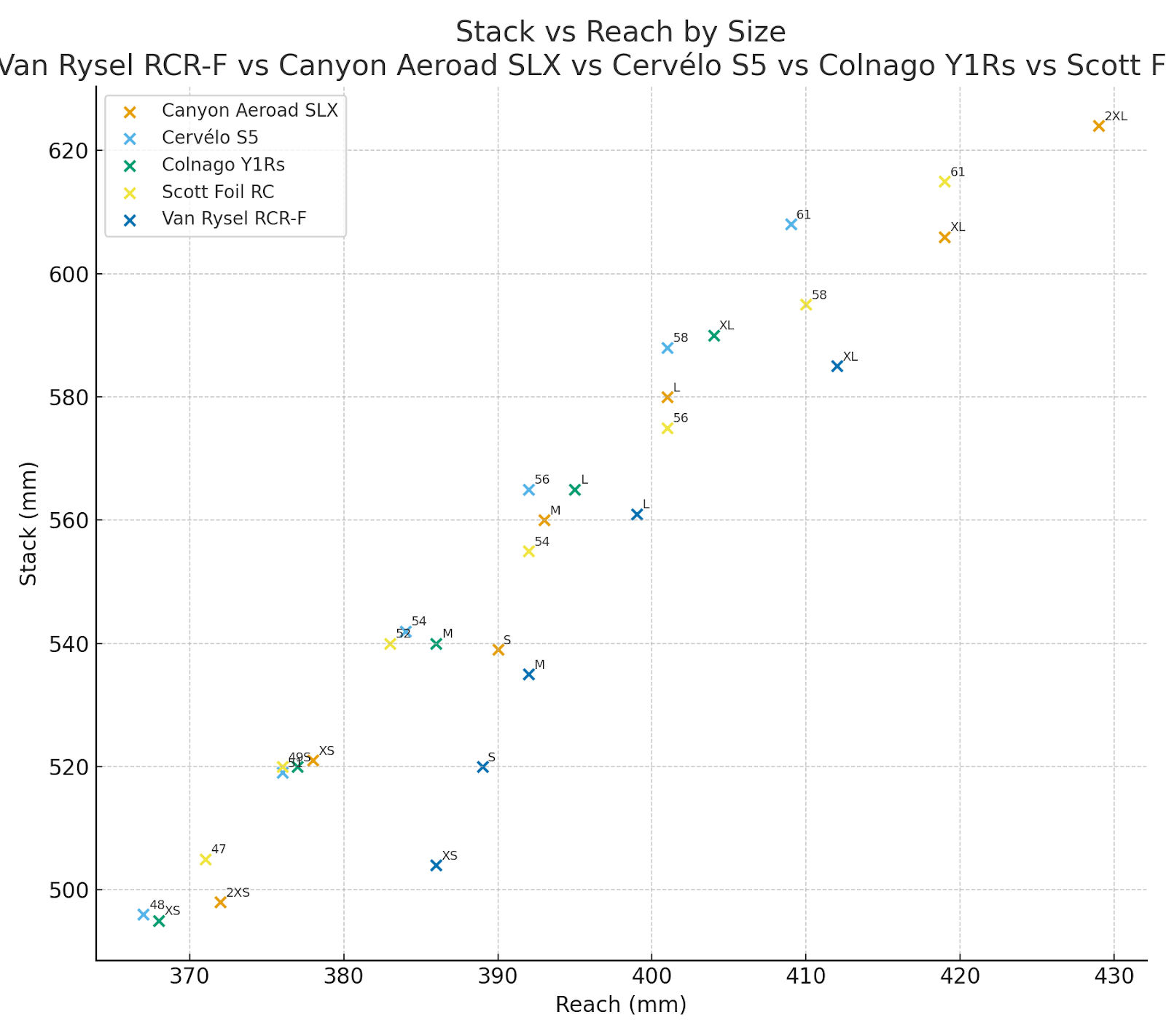

Looking at the RCR-F’s geometry chart is a must, but it also raises questions around fit, especially for smaller riders. The frame itself is long; in fact, the XS RCR-F has a longer reach than a 54 cm Tarmac SL8, with a stack some 40 mm lower.
The only frame sizes that fall within the realm of its competition when plotting reach and stack measurements are the size large, which closely matches a medium Canyon Aeroad, large Colnago Y1Rs, and 56 cm Cervelo S5 and the medium RCR-F, which correlates to a small Canyon Aeroad.
From the L up to the XL, the reach and stack both jump considerably from 399 mm and 561 mm to 412 mm and 585 mm. This increase in reach between the L and XL is the same as the jump from the XS to the L.
