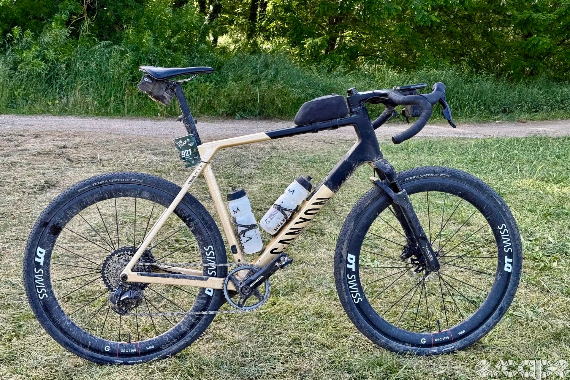

The unreleased fork broke cover at Traka with multiple Canyon athletes using it in the race.

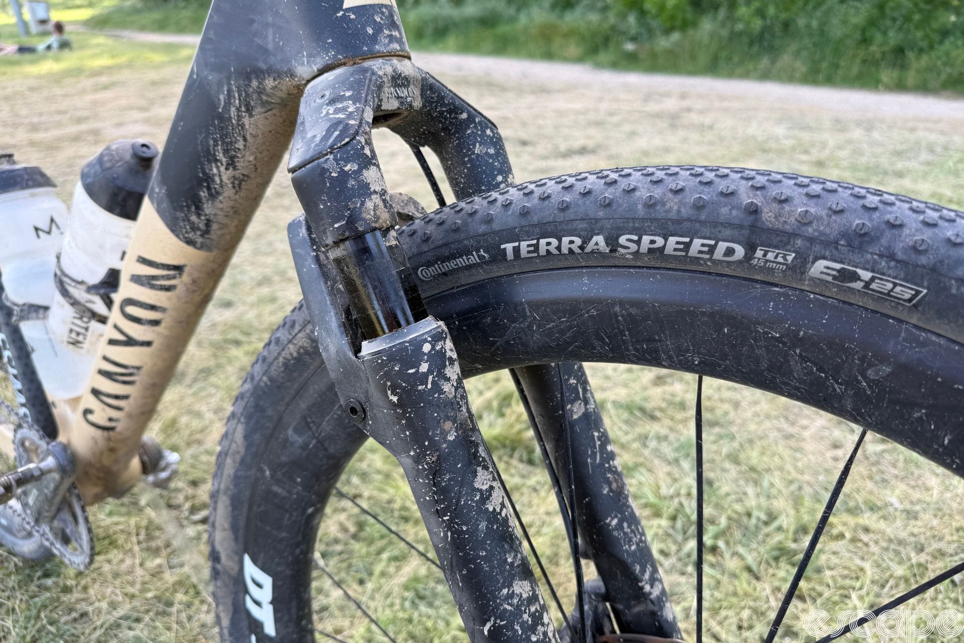

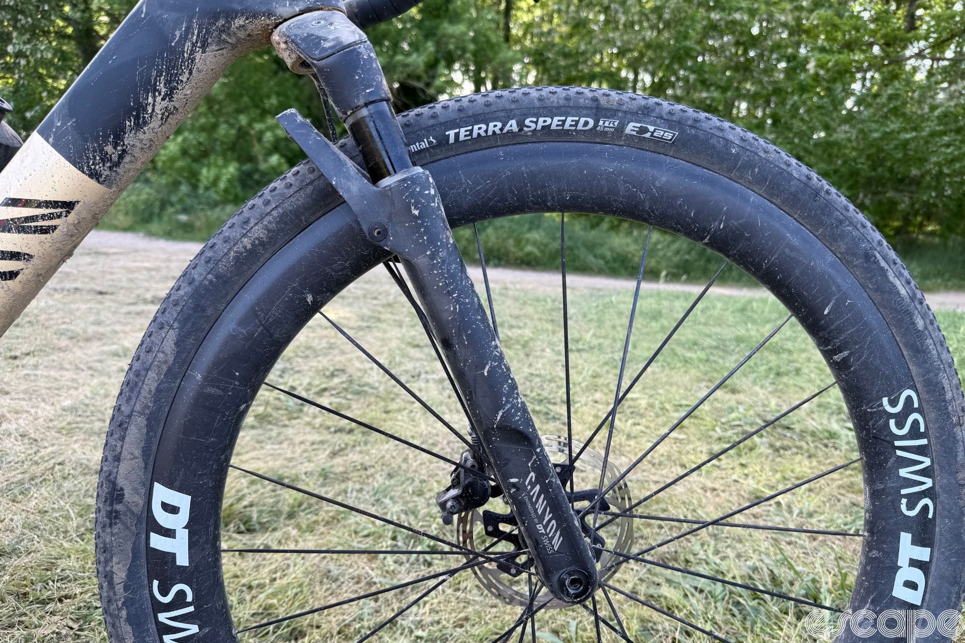

Both Canyon and DT Swiss had branding clearly positioned on the lower stanchions of the new suspension fork. To take a closer look, I got my hands on Rad Pack athlete Mate Nagy's bike after the Traka 200.

With the unreleased fork being used at Traka and mounted to the Grail, all things point to Canyon and DT Swiss believing the next frontier of gravel performance lies in suspension.

The unreleased fork has 40 mm of travel and remote lockout.

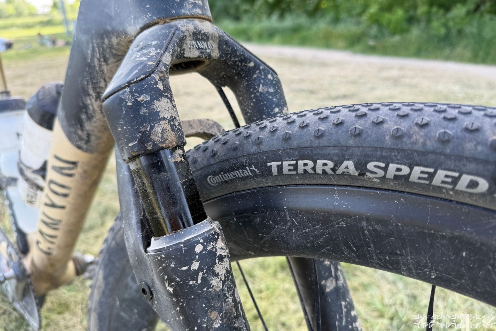

The bottom section of the fork is more slender, tapering in like RockShox's Rudy.
As races are being won at ever-increasing speeds, the aerodynamic impact of a suspension fork is seemingly too great for most athletes to use in gravel races. What this fork does have is a slender bottom section that appears longer than that found on the Rudy or the Fox 32 Taper Cast. It’ll still impact aero, but the fork’s chassis design looks to be an attempt to minimise the penalty.
Round stanchions are always going to be an aerodynamic sticking point. Historically, suspensions forks have had their benefits but the costs have outweighed the rewards. Time will tell if Canyon and DT Swiss can change this opinion.
What do we know, or more to the point, what can we say?
The suspension fork has a concealed inflation valve that sits under a hatch on the right-hand side of the crown (when looking at it from a rider's perspective). On the left side of the fork, something far more interesting is going on.
