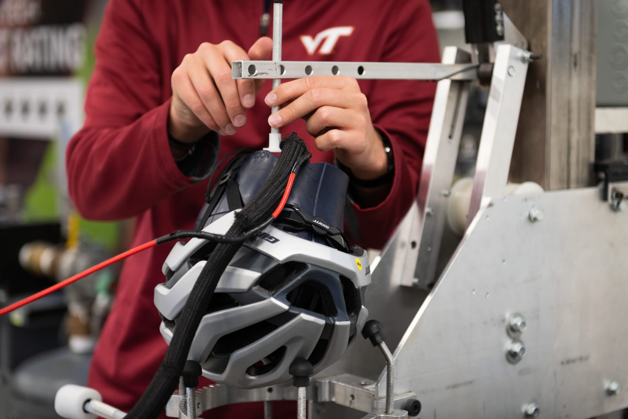

Most cycling helmets come with broad instructions to replace them every 3-5 years. It’s a familiar line, but one that’s always struck me as suspicious – perhaps more about driving sales than ensuring safety. I wanted to dig deeper into the reasoning behind this guideline, so I spoke to safety experts and helmet brands to find out how long helmets really last.
When the conversation about helmet lifespan arises among friends, the discussion quickly turns to the degradation of EPS foam and the effects of UV light and sweat. These points are often brought up without anyone being able to point to where they first found this information. To understand more about what happens to helmets over time and when you really need to replace them, I spoke to Barry Miller, a PhD biomechanist and director of outreach and business development at the Virginia Tech Helmet Lab, along with Matteo Tenni, a project manager at Met Helmets, and Brian Turany, marketing manager at Trek.
