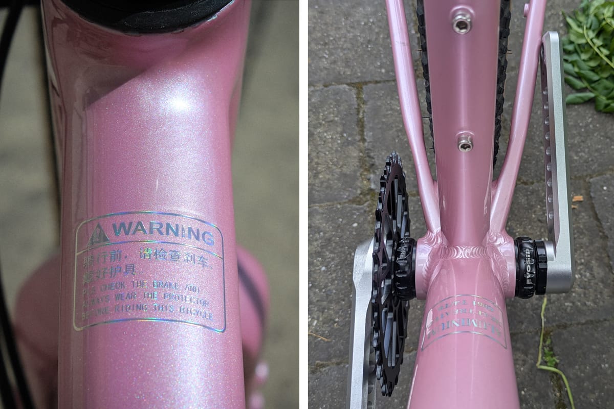

That doesn’t mean I don’t have a morbid fascination with it all, though. After having some mixed experiences with products bought through AliExpress, I took a leap last year: I bought a frameset from there. It was a deeply tedious process to get it built up, riddled with problems that I wouldn’t accept from a mainstream brand. But now that I’ve overcome those teething pains (and by ‘teething pains’ I mean gums coursing with thick, fresh blood) I have a silly pink basket bike that I ride almost every day and genuinely like. Still, would I make the same kind of purchase decision again? Probably not.

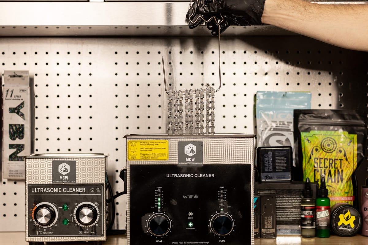

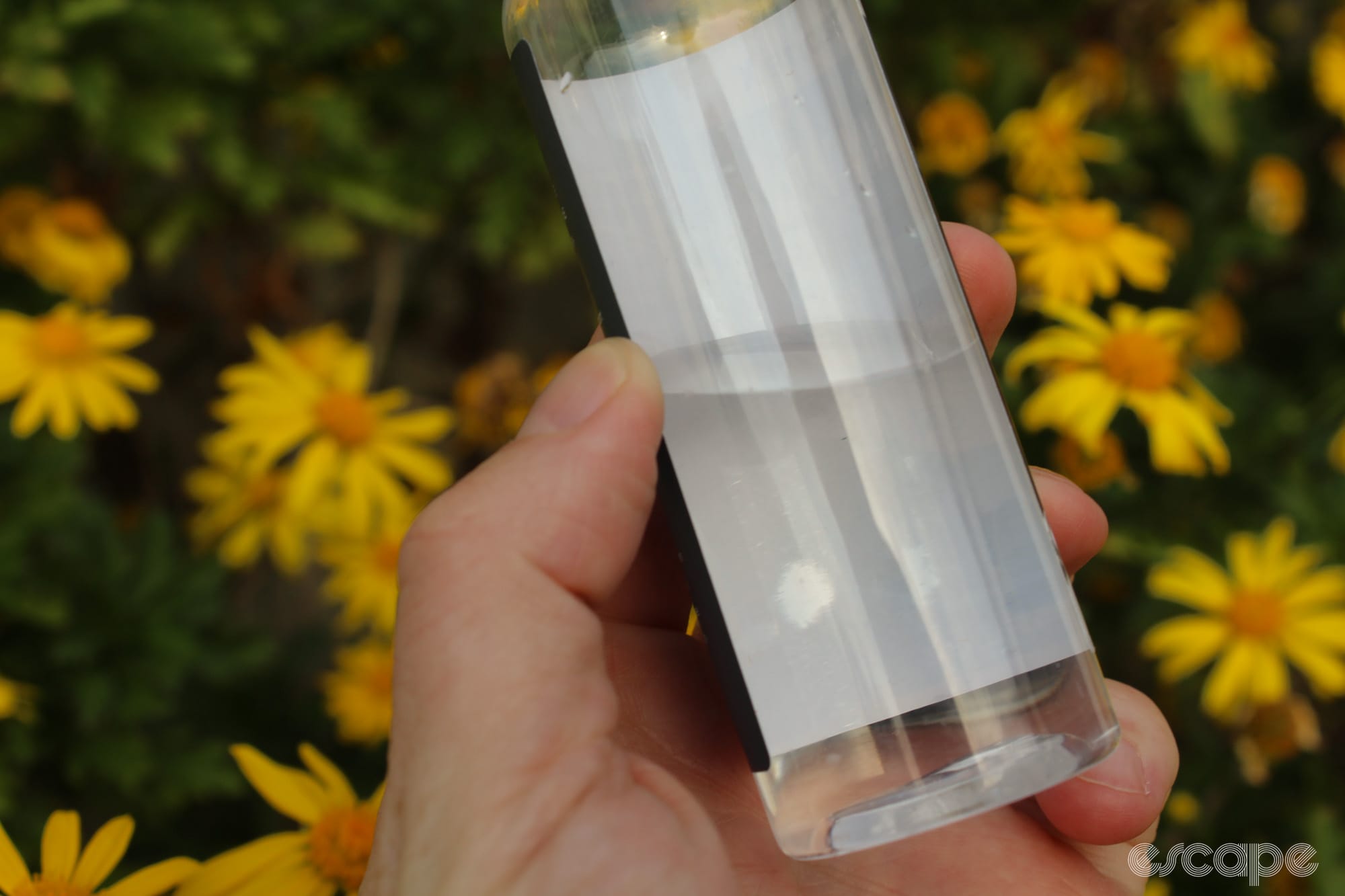

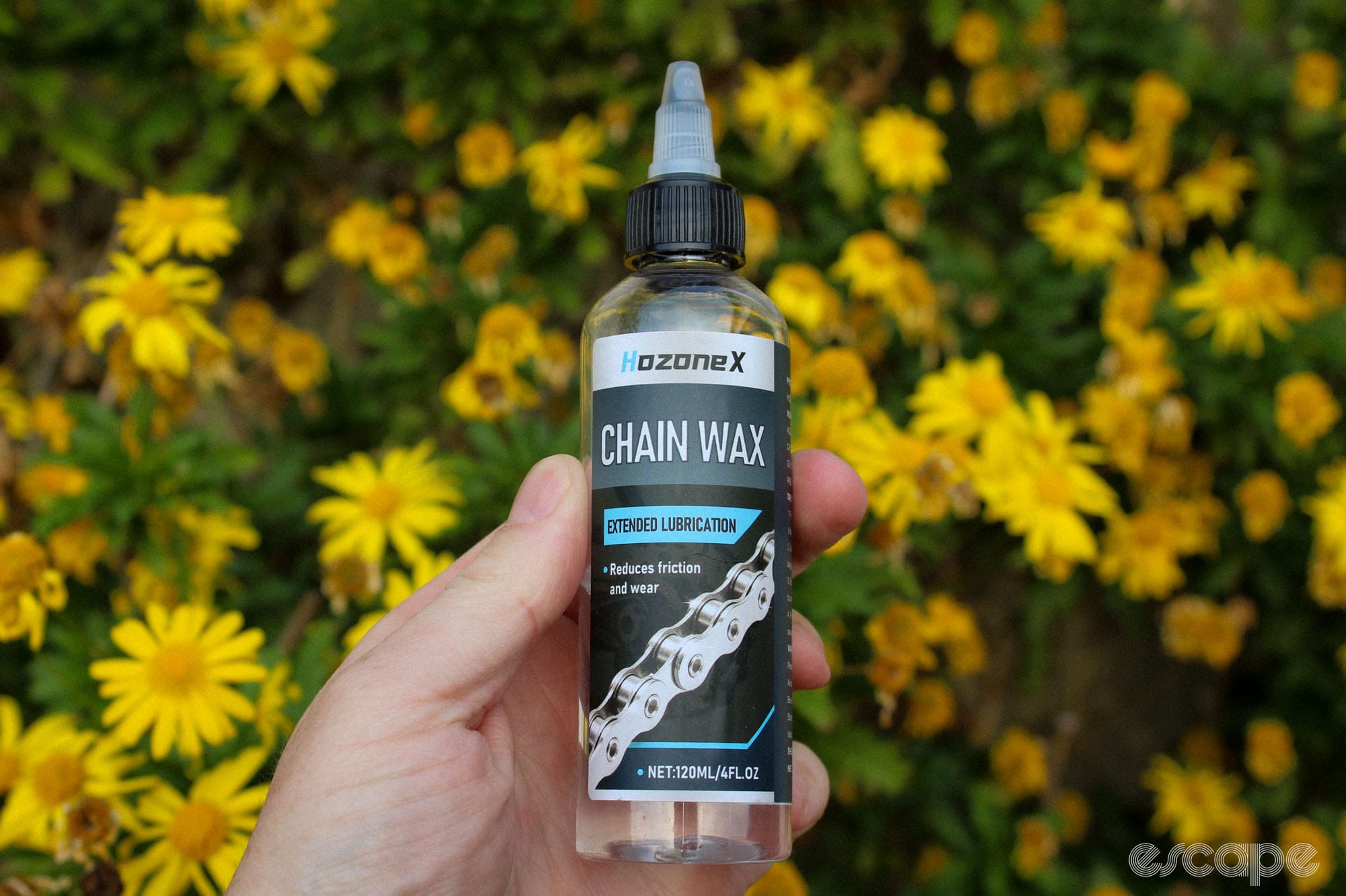

A week or so after I hit the big red ‘buy’ button, my little bottle of Hozonex-branded chain wax showed up in a nondescript postal satchel. Its appearance was, I will admit, a surprise: the contents were completely transparent, with the viscosity of water. I gave the bottle a little shake in the hopes that it would thicken, but a light lacing of bubbles was about as far as that went. After chucking my chain in an ultrasonic cleaner and getting everything ready for application, it was time to see how it went on.

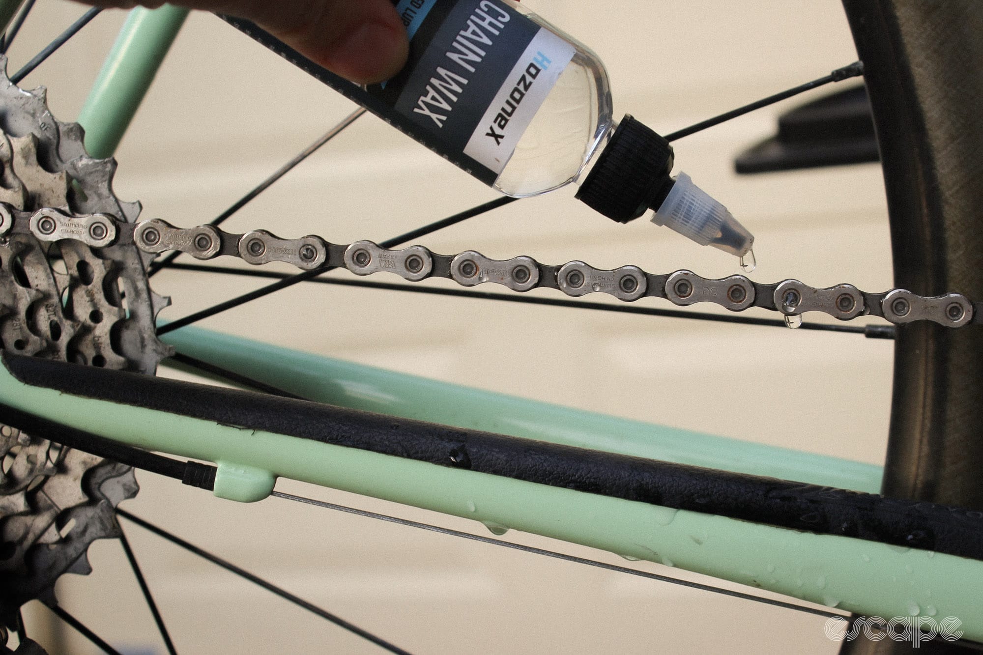

The answer was ‘easily’ – too easily. It spurted out as if it had somewhere to be, liberally coating the chain and then, as I rotated the pedals, the bottom of the jockey wheels and chainring, before dripping onto the floor. As a non-Dave Rome, I reached out to him for a second opinion about whether any of this was remotely normal. His verdict (and I quote): “LOOOLLLLL”.
Still, the scorn of my colleagues is not (and has never been) enough to prevent me from following a hunch through to its giddy conclusion, so over the next few weeks I used exclusively Hozonex ‘chain wax’ on one of my bikes. First impressions turned into worse impressions. My drivetrain was no longer grimy, true, but it was also very noisy: a squeaking little nest of mice seemed to have taken up residence where my chain once was, getting insistently louder from about the 10 km mark of any ride.
Wet-weather performance was dismal, too. One night ride ended with wet trails and the lightest sprinkling of drizzle, and when I looked at my bike the next morning, the chain and cassette were liberally dotted with orange specks of rust. Either it had basically no permeability, or the mix was just plain wrong – watery wax, instantly washed off with water.

Before taking the plunge, I decided to seek out some alternate views. Dave’s perspective was that “If [there’s] no smell, it’s clear, and there’s no particles – it's most likely water.” (He later clarified “don’t drink it”). Matt’s perspective was “WTAF”. Fair all round, but I couldn’t shake my worst impulses.
