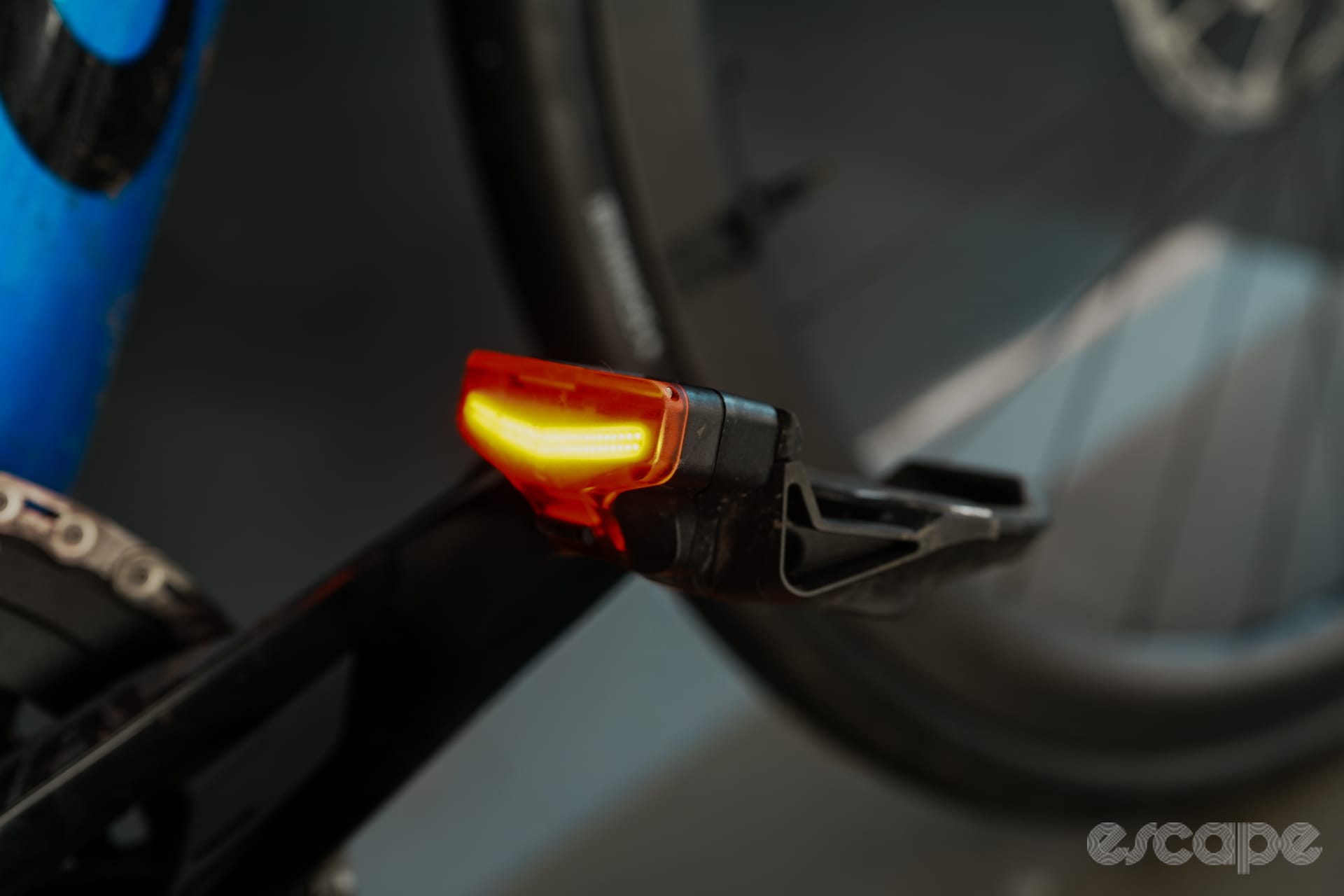

Road pedal lights – who knew we needed them? When Look announced its new Blade Vision pedal lights, I knew I wanted to test them, but mainly out of scepticism. Surely, given how long it's taken for the market to come out with such a product, it must be hard to get it right? After three months of testing the lights (and pedals) across all road conditions, including a winter's worth of rain, grit, and road salt, I can tell you they're genuinely impressive and another small thing (in addition to a rear radar) that has made me feel a little bit safer on the roads.

As mentioned, these are a bit of a first. While Look has offered Vision lighting on urban pedals since 2017, and the likes of Redshift have had Arclight flat pedals, this is the first time the pedal-light technology has made it onto road-specific clipless pedals. And unlike many "first" products, it seems that Look has hit the mark on the first attempt.
The short of it: Look Keo Vision pedals bring genuinely useful integrated lighting to road clipless pedals for the first time, and yes, they work exactly as promised.
Highs: Effective biomotion visibility, auto-pause feature for extending battery life, minimal weight penalty, excellent durability in harsh conditions, and great visibility even in busier urban environments.
Lows: Attachment mechanism can take some getting used to, no real-time battery monitoring (only low-battery warning at 15%).
Weight: 18.5 g per light (37 g total)
